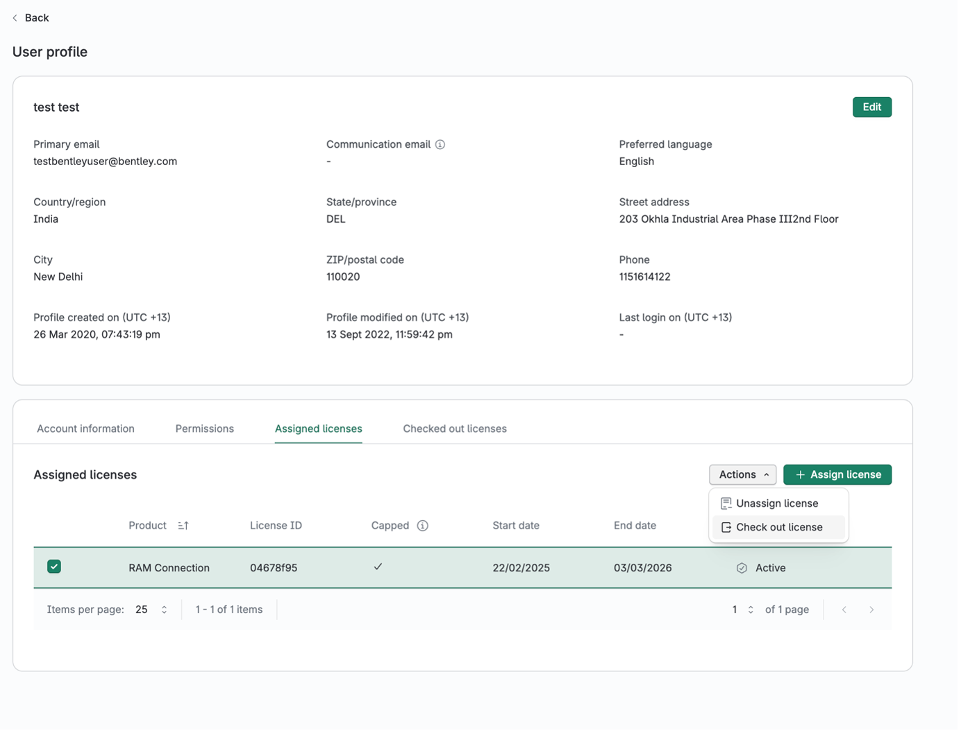

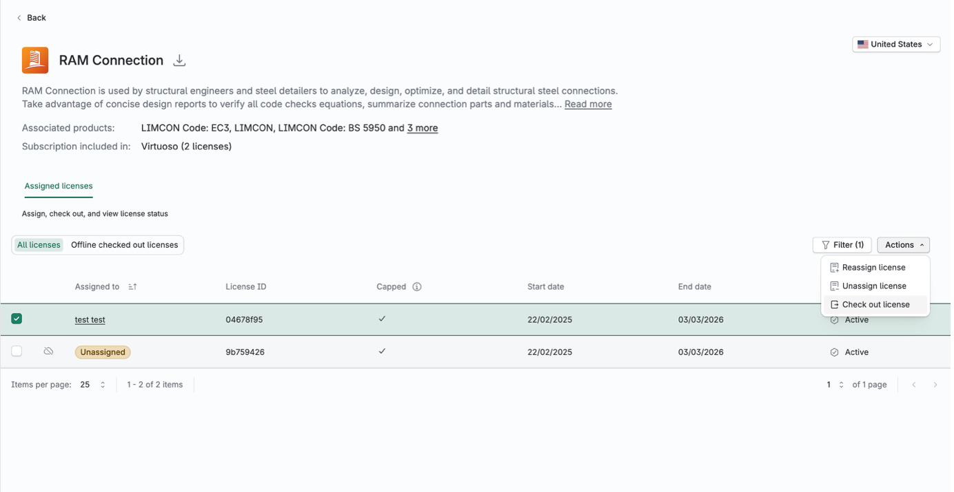

Checkouts can be managed from the user profile or from the product detail page. The process is the same and accessed from the Assigned licenses tab for both.
1. From the user profile page, navigate to the user table
  • Log in to the admin portal
  • Navigate to the Users section, then select a user to view their profile
  • On the profile page, select Assigned licenses
  • Select the assigned license you wish to checkout, then from the Actions menu select Check out license
User profile page:
User profile page, checkouts tab
 Product details page:
Product details page, checkouts tab

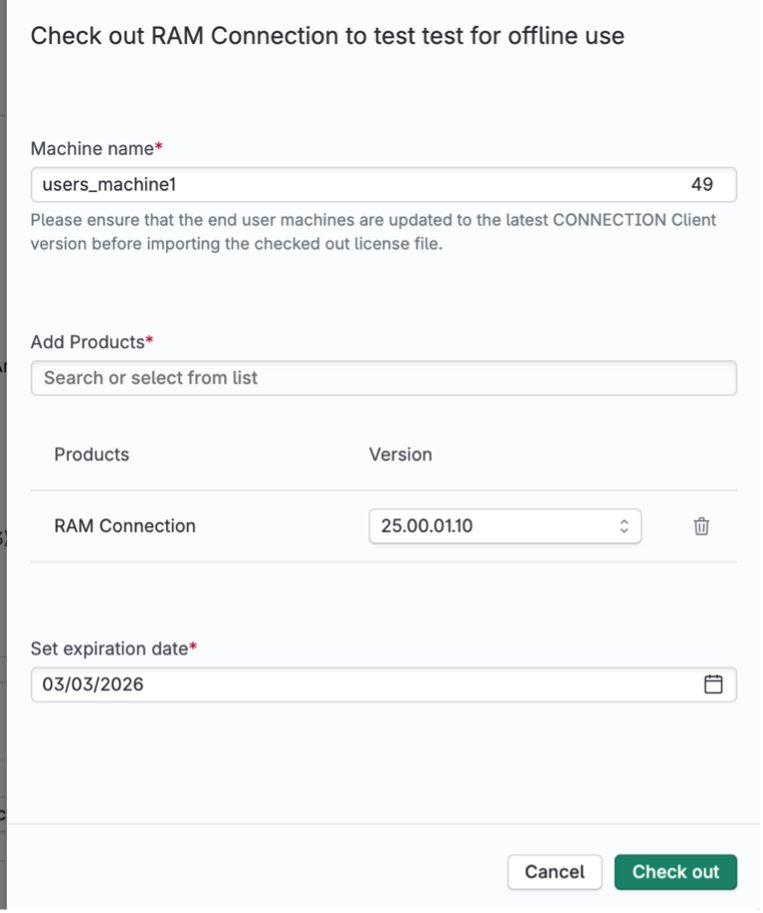

2. Enter the machine and product details
  • Enter the users machine name
  • Select the relevant products to be checked out
  • Select a valid version from the list or manually enter the four part version number corresponding to the version of your product.
  • Enter an expiry date for the check out using the calendar dropdown
Then select Check out:
Checkout license dialogue
The license is now checked out for the user and product specified.

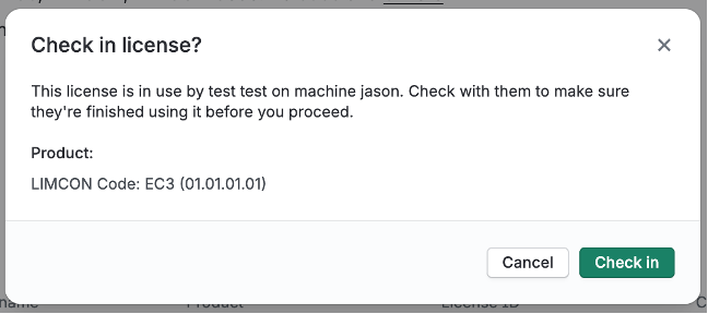

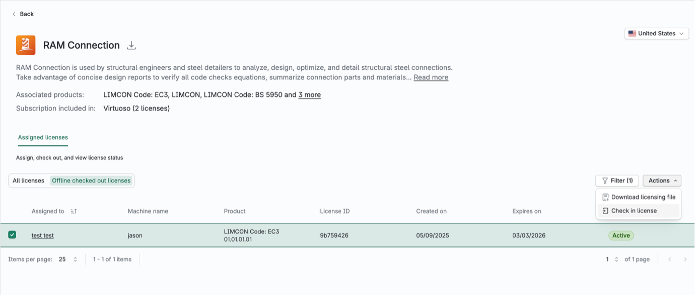

Checking in licenses
Checking in (or returning) licenses should always be done by the user via the Bentley Licensing Tool and should only be performed by the administrator if the machine is no longer accessible. Read more
1. Select the license from the Offline checked out licenses tab
Admin product checkouts
2. Confirm the user no longer requires the license and cannot perform the check in
Checkout products confirmation dialogue
3. Select Check in to complete the license Check in.
