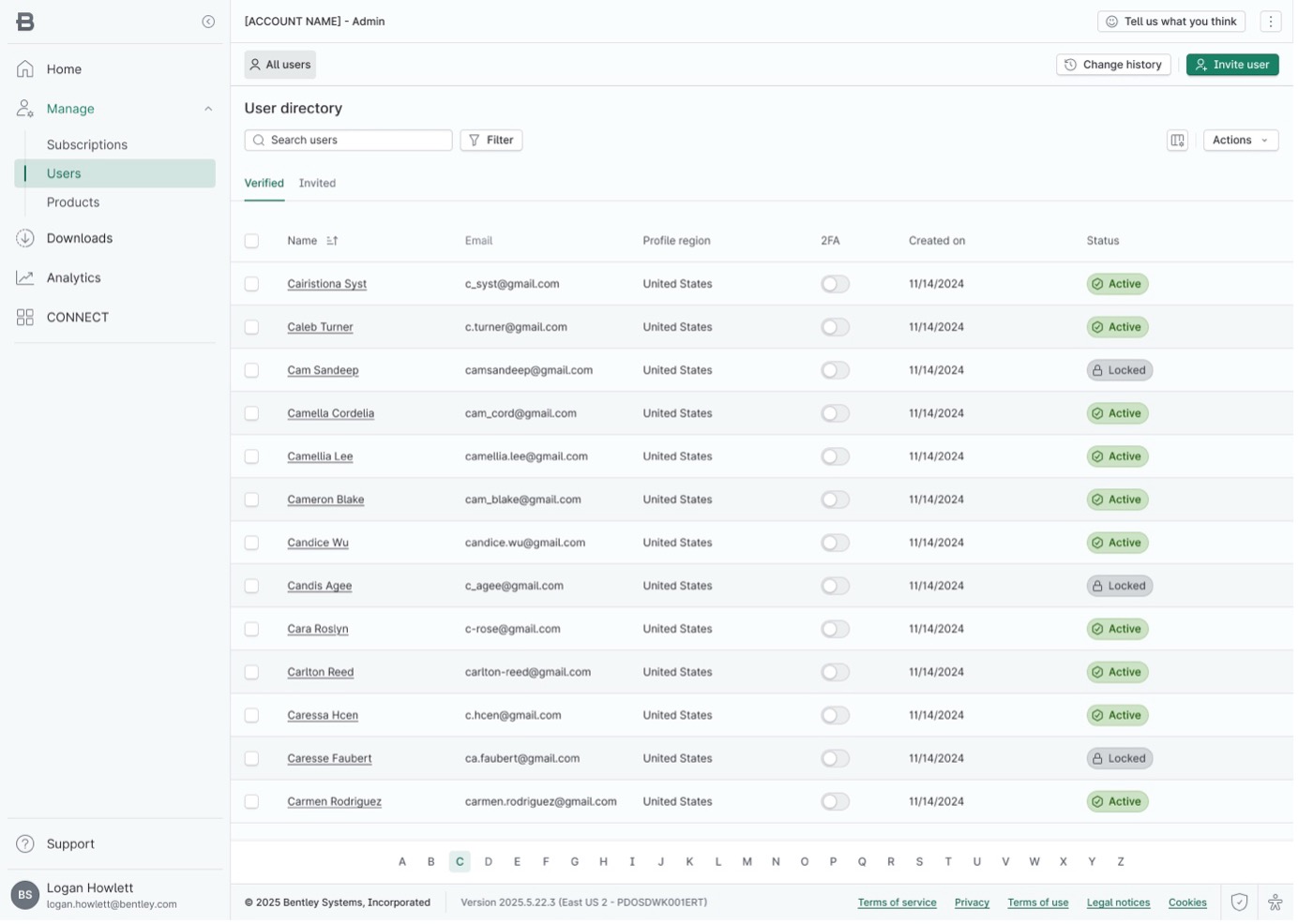

1. Go to the Users table
  • Sign in to the admin portal
  • Navigate to the Users section
  • You will see a table listing all verified users
  • The Invited tab displays all users you have been invited but not yet accepted invitations to join your organisation
 Admin add users
2. Select "Invite user"
  • In the top-right corner of the user table, select the Invite user button.
  • This opens the Invite user modal.

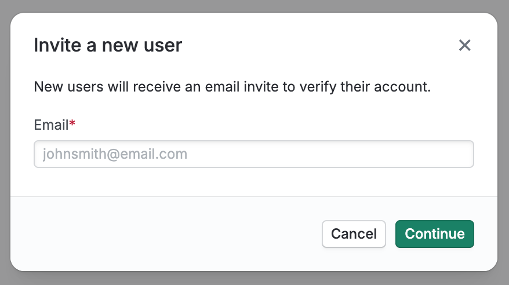

3. Review the Invite user form
  • Enter the new user's email address to invite them
Add user enter email dialogue

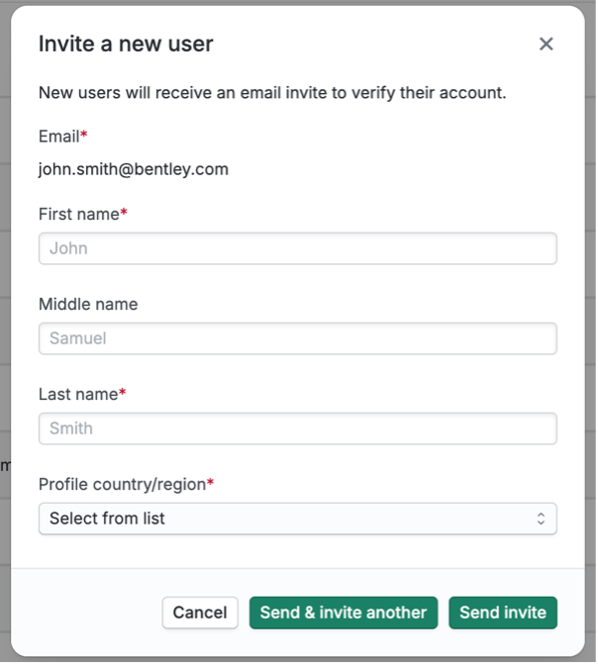

4. Enter user details
  • Fill in the required fields:
    • First name
    • Middle name (optional)
    • Last name
    • Profile country/region
Invite user dialogue
5. Send the invite to the new user
  • Select Send invite or Send and invite another to invite another user
  • The invited users will be sent an email inviting them to join your organisation
  • The new user(s) will now appear in the ‘Invited users’ table
