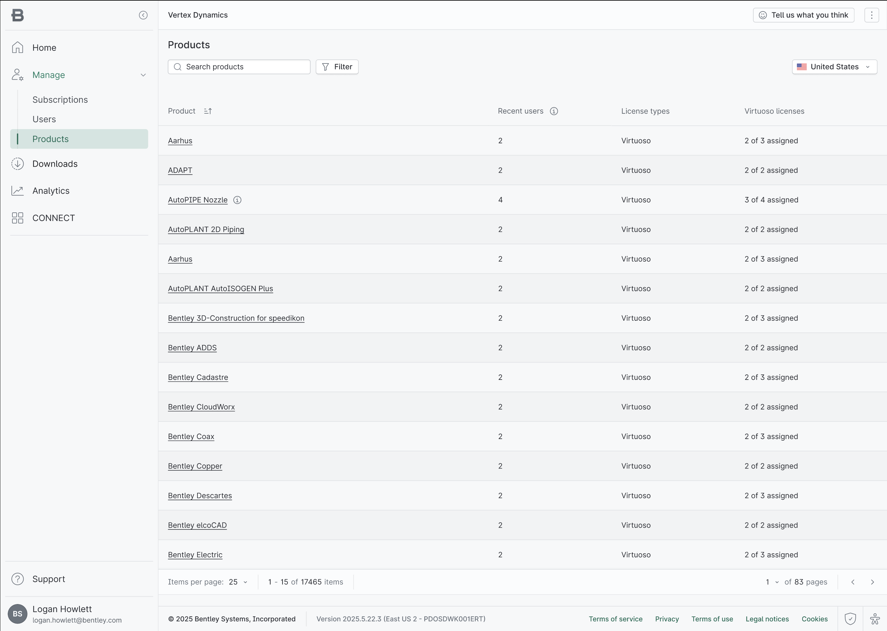

1. Select a product
Assign a Virtuoso License to any user in your organization via the Product Detail page, first select a product with available licenses by navigating to the Products page from the main menu. Here you will see a list of all products available to you. Click on the name of the product for which you want to assign a license. In this example, we are selecting "AutoPIPE Nozzle".
admin portal product list

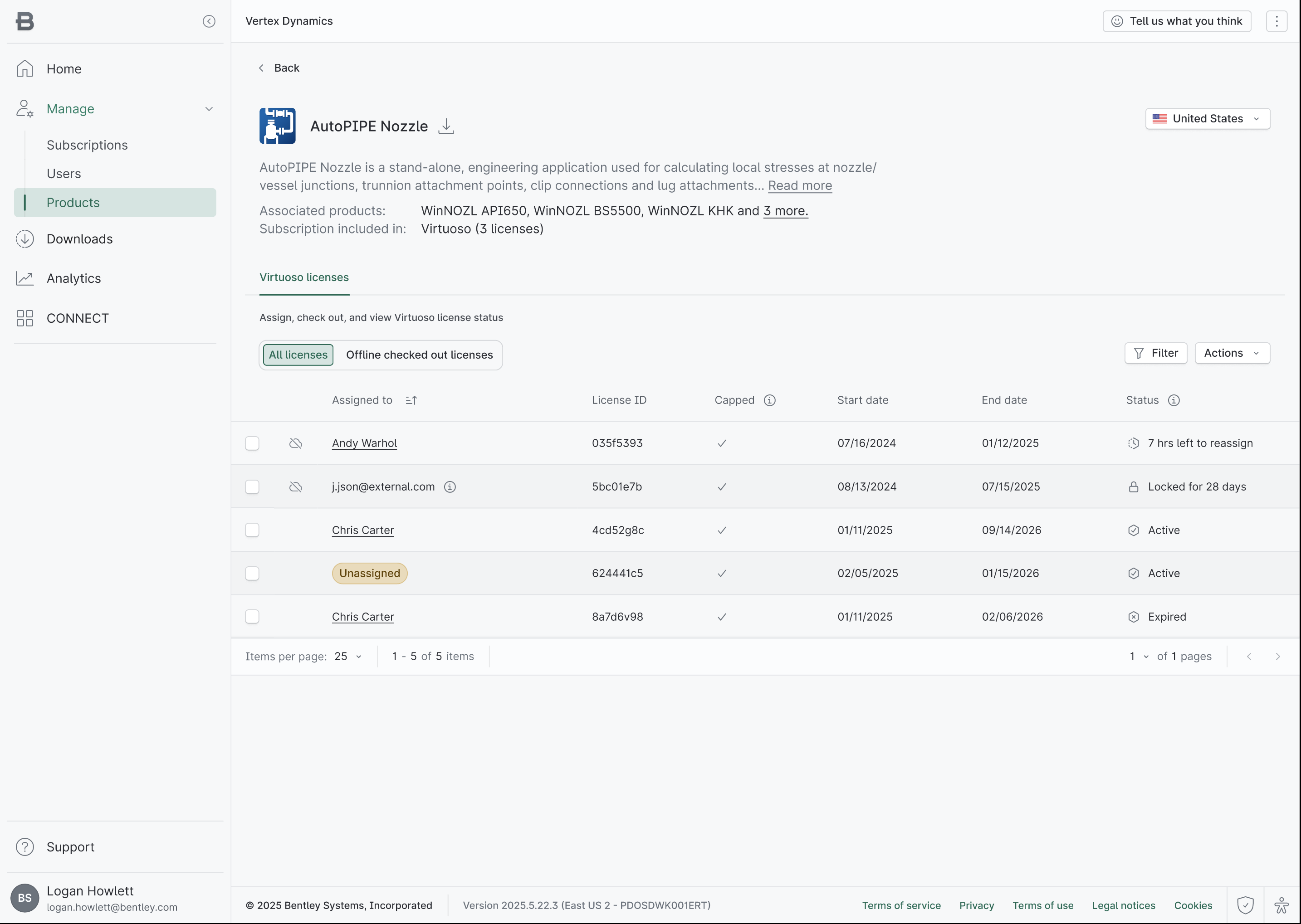

2. View Product licenses
After selecting a product, you will be taken to the product detail page. This page shows a list of all the Virtuoso licenses for that product, including who they are currently assigned to and their status.
Admin product details page
3. Select an Unassigned License
From the list, locate a license with the status "Unassigned". Click the checkbox to the left of the unassigned license to select it.

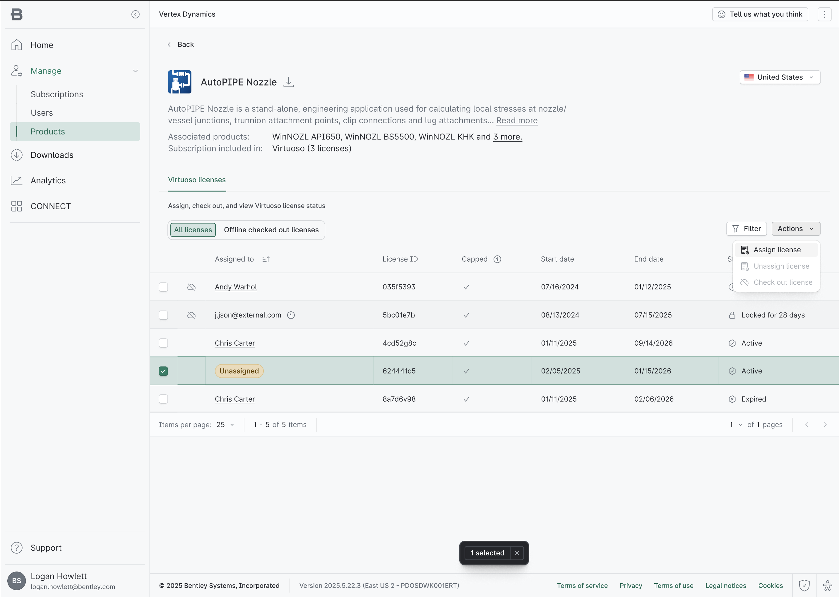

4. Choose the "Assign License" Action
With the unassigned license selected, click the Actions button located at the top right of the license list. From the dropdown menu that appears, select Assign license.
Admin, assign license

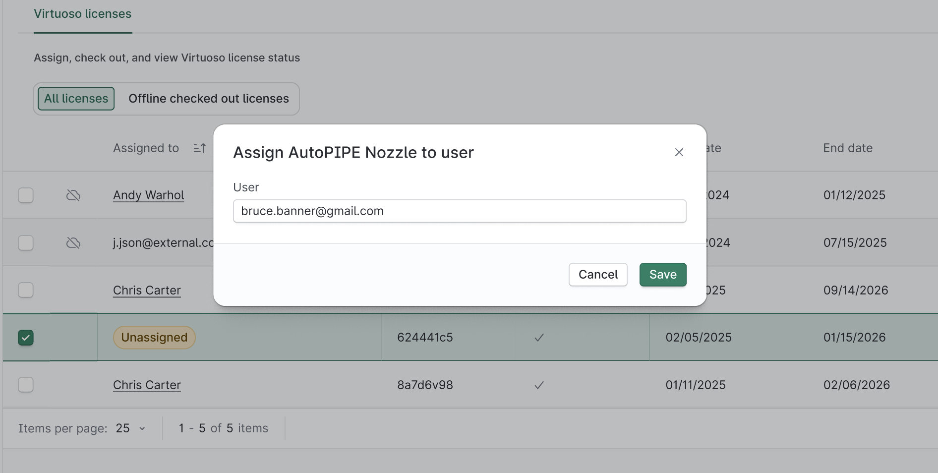

Step 5: Enter the User's Email Address
A dialog box will appear titled "Assign [Product Name] to user". In the "User" field, type the email address of the person you wish to assign the license to. Once you have entered the email address, click the Save button.
Admin, choose user to assign license

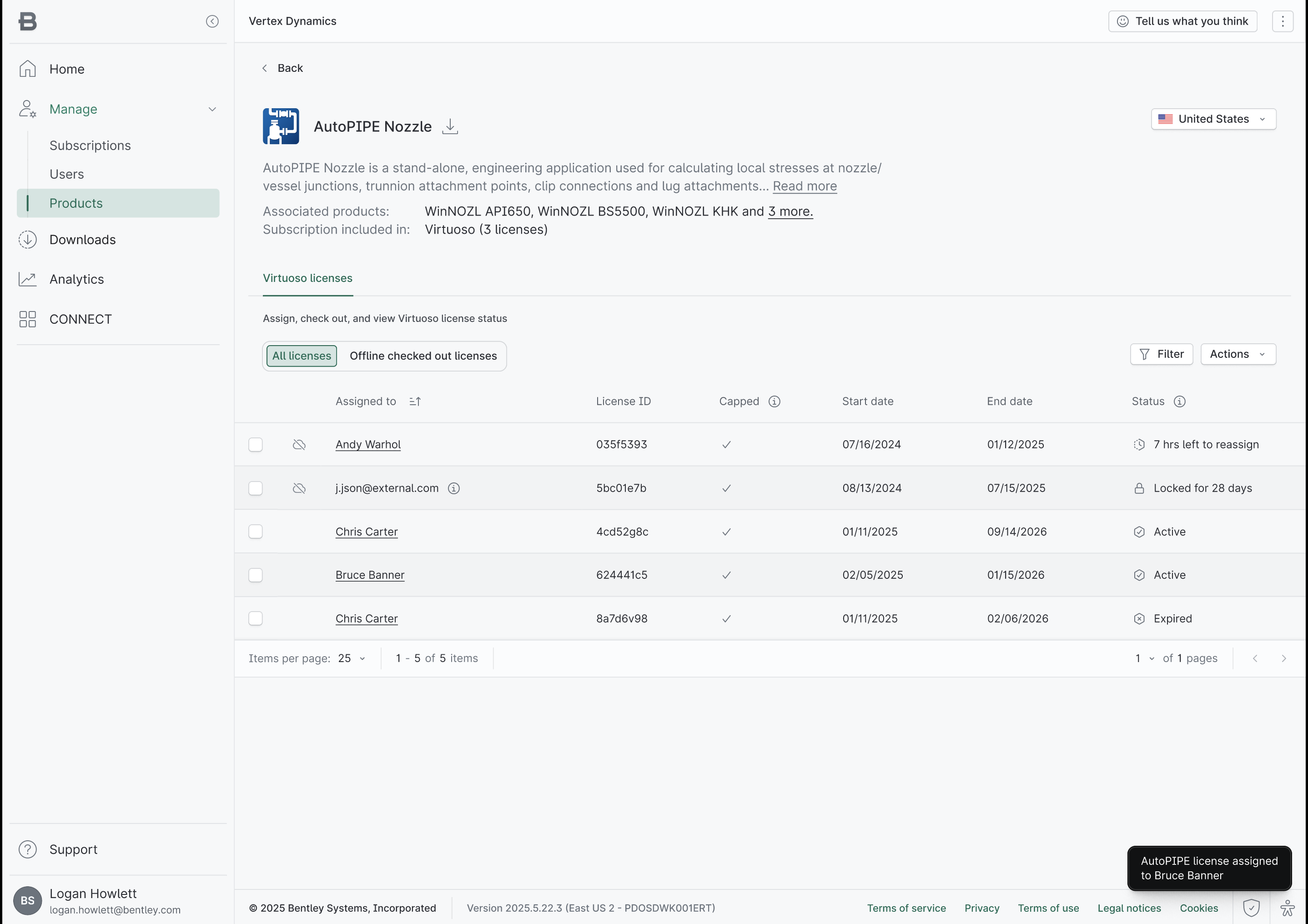

Step 6: Confirm the Assignment
After saving, you will be returned to the product detail page. The license that was previously "Unassigned" will now show the name of the user it has been assigned to. This confirms that the license has been successfully assigned.
Confirm license assigned to user
Expected Results
Now the license is assigned to the user and the user will have access to the product.
