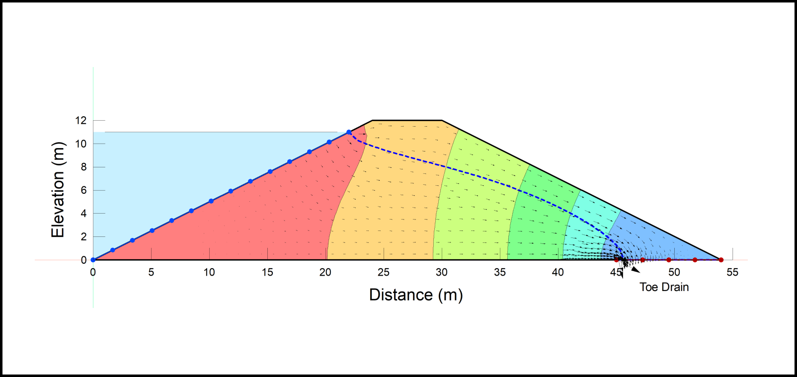

If a saturated-only material model is applied to a region exhibiting both saturated and unsaturated conditions, the seepage results produce unreasonable flows in the unsaturated zone (as illustrated in the first image below). When the saturated/unsaturated material model is applied to this same region, there is still some flow occurring in the unsaturated zone (groundwater flow can still occur in the unsaturated zone), but it better represents the decrease in flow due to lower volumetric water contents and the corresponding decrease in hydraulic conductivity (as illustrated in the second image below).
