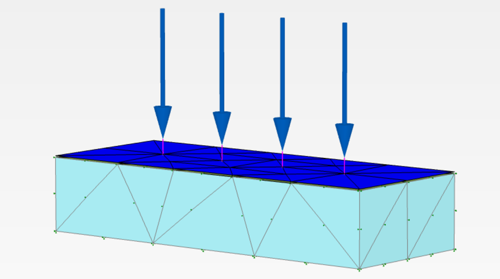

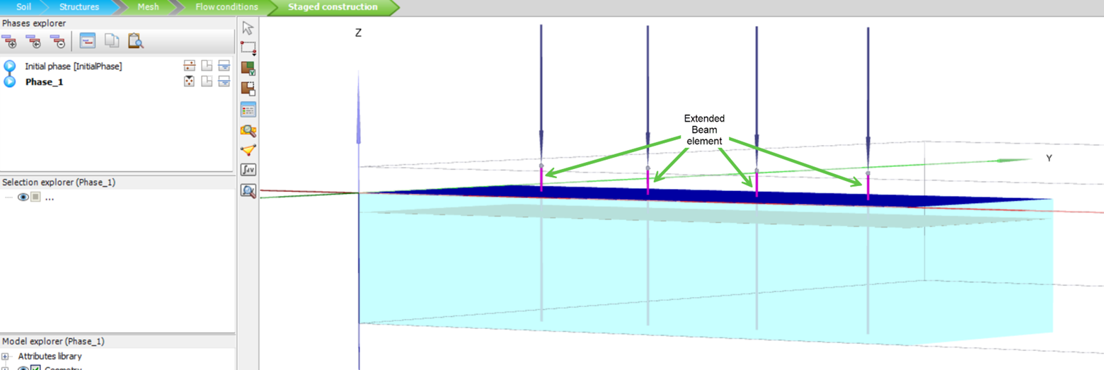

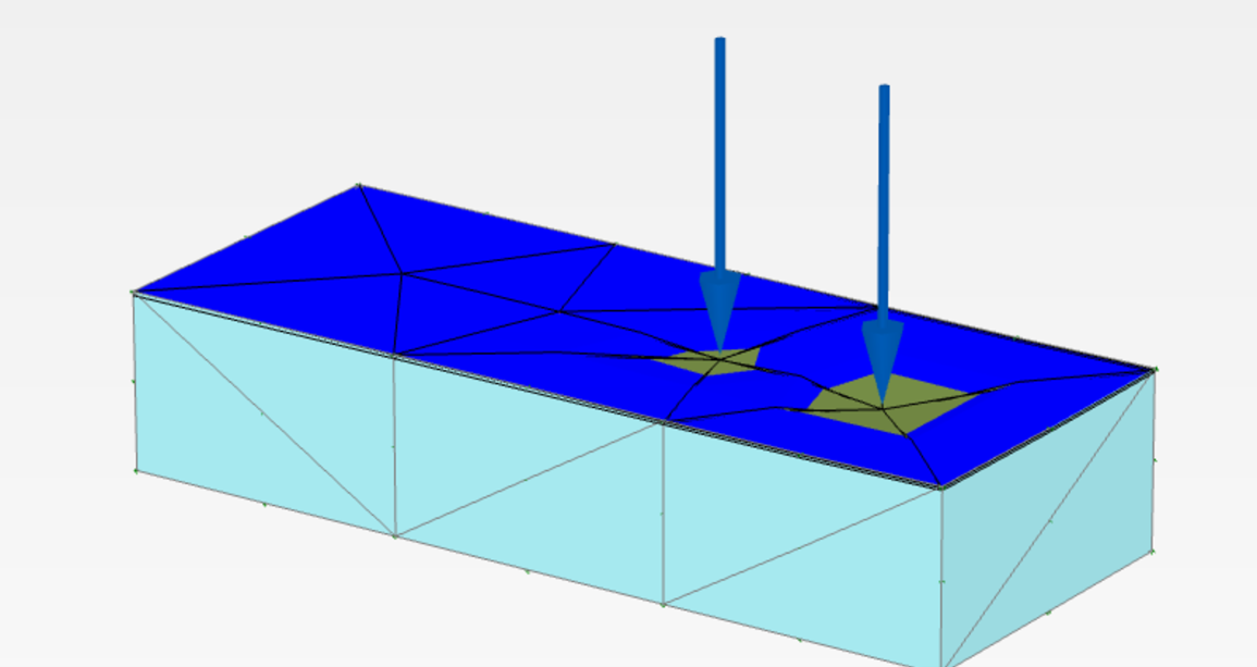

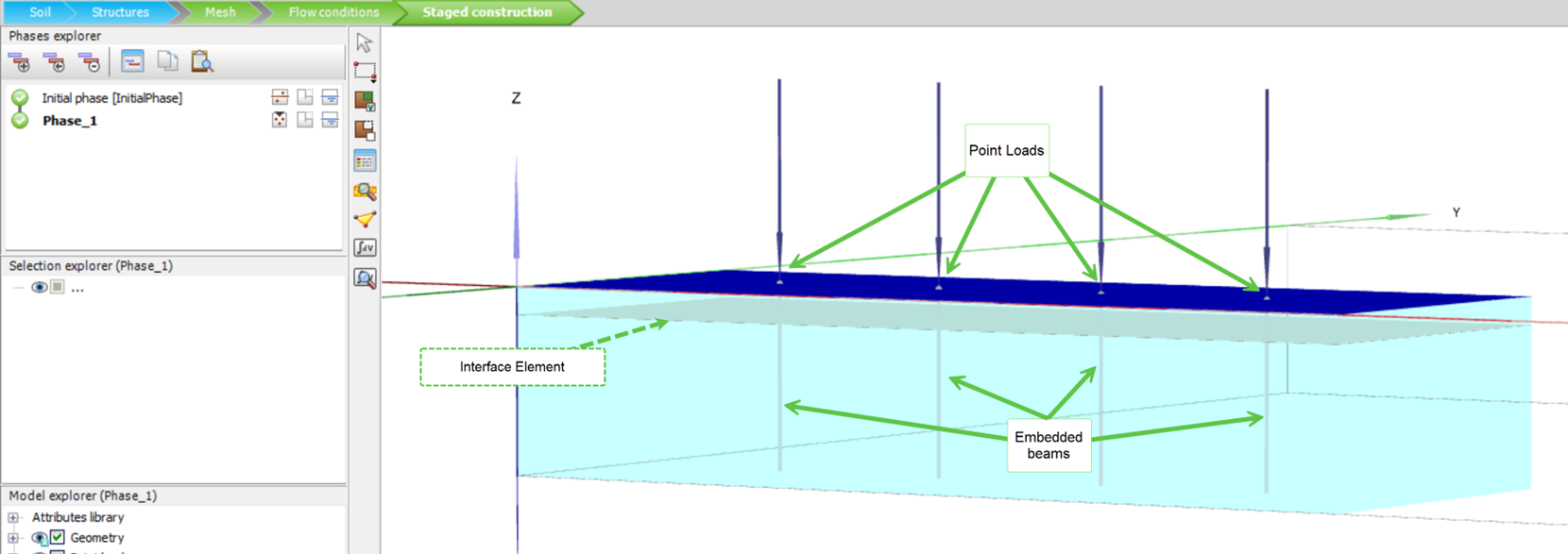

In PLAXIS 3D 2025.1.0 and 2025.1.1, when point loads are applied at the top of embedded beams and an interface element exists at the same coordinates, the point loads are incorrectly merged into single point load(s).
This behaviour does not appear in the Input program, but becomes visible in PLAXIS 3D Output, where a combined load is shown instead of the individual loads.
For a better understanding, consider the following example:
This issue only occurs when an interface element shares the same coordinates as the embedded beam’s top point, where the point load is applied, e.g., case of modelling pile-raft foundations.
The merging of point loads will lead to different load distribution compared to the assigned  one, and since the analysis is based on the incorrectly combined  load, this will affect analysis outcomes and accuracy.
