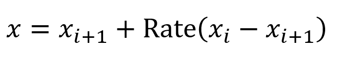

Repeated substitution and under-relaxation are commonly used numerical procedures for coping with material non-linearity that involve repeatedly solving the finite element equations and updating the material properties based on the solution at the previous iteration. Mathematically, the procedures can be expressed as follows:
where x is the independent variable (pressure head, temperature …), and Rate is the under-relaxation rate. In the case of repeated substitution, the under-relaxation rate is set equal to one (1), and the equation reduces to
This implies that the solution of the previous iteration is used as the starting point of the next iteration. In the case of under-relaxation, the under-relaxation rate is set equal to a value smaller than one (e.g. 0.1), so the starting value of the independent variable becomes equal to the independent variable of the previous iteration plus one-tenth of the difference in independent variable between both iterations. The independent variable (and computed properties) are thus much closer to that of the previous iteration, which favors convergence.
