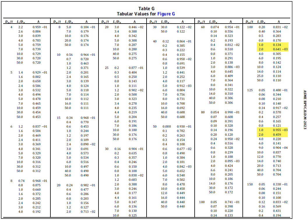

  1. Geometric Ratios:
Compute the ratios required to enter the charts:
    1. For heads:
      1. Ro/t
    2. For shells (UG‑28):
      1. Length ratio L/Do/
      2. Thickness ratio Do/t
These ratios determine the Factor A position on the charts.
  1. Determine Factor A:
      1. As per UG‑28(d), calculate the geometry-based factor: A  =  0.125/(Ro/t)
    • Cylindrical Shell (UG‑28)
      1. Refer to Table G using the ratios L/Do​ and Do/t to obtain Factor A.
      2. Use linear interpolation between chart points where needed.
  1. Determine Factor B (Material/Geometry)

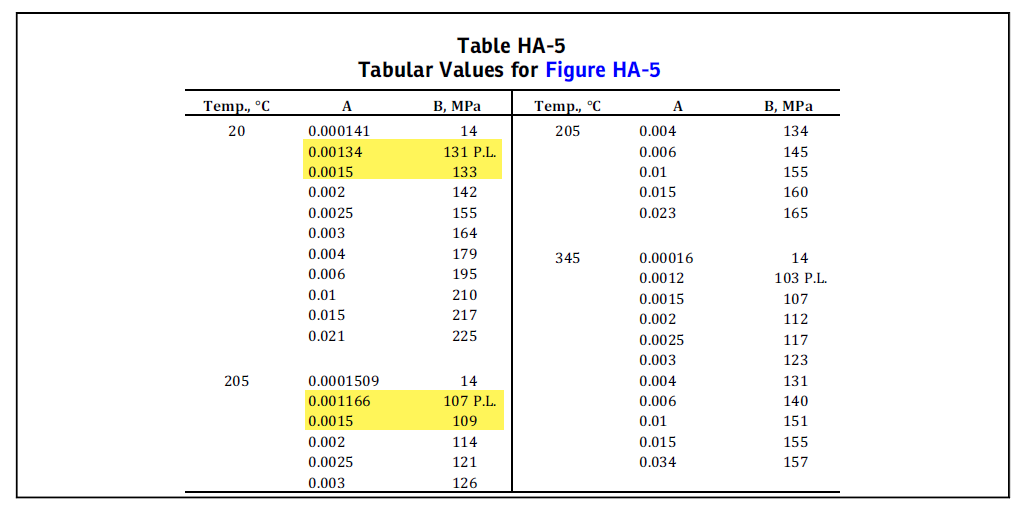

    1. Using ASME Section II, Part D, Subpart 3 (e.g., Table HA‑5), find Factor B corresponding to your Factor A and design temperature.
    2. Apply interpolation for intermediate temperatures and A values not directly listed.
  1. Calculate Maximum Allowable External Pressure Pa​
    1. As per UG-28:
      1.   Pa  =  4B/3(Do/t)  For cylindrical shells (UG‑28 (c))
      2.   Pa  =  B/(Ro/t)  For Heads (UG‑33 & UG-28 (d))
    2. Compare Pa​ with the design external pressure P.

      1. A=0.125(Ro/t)=0.125/89.69=0.001394
    4. Factor B (from Table HA‑5)
      1. B(45∘C)=129.3957 MPa
    5. Allowable External Pressure (use Pa=B/(Ro/t))
      1. Pa   =  B/(Ro/t) = 129.3957/89.69 ⇒ 1.4427 MPa
      2. Check: If Pa  ≥  Pdesign
      3.   1.4427 MPa ≥ 1.01 MPa ⇒ Meets Code Requirements
