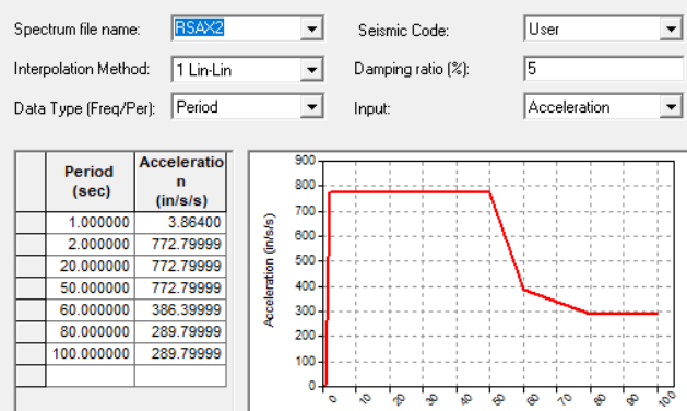

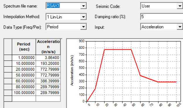

The model consists of a 2‑inch NPS vertical riser rigidly anchored at the base, with no internal fluid mass (SG = 0). The pipe extends 5 ft above the anchor point and supports a 200‑lb axial gravitational load applied at the top node. Two independent lateral response‑spectrum inputs are applied to the system for dynamic evaluation.
Spectrum file #1:
Spectrum file #2:
The only variation between Spectrum #1 and Spectrum #2 occurs at Line 2 of the input data: Spectrum #1 defines a period of 10 sec with a corresponding acceleration of 193 in/s², whereas Spectrum #2 specifies a period of 2 sec with an acceleration of 772 in/s². Beyond this single point, both spectra are identical.
Given this isolated difference in the spectrum definition, should the dynamic analysis results for the two spectra be expected to differ or remain the same?

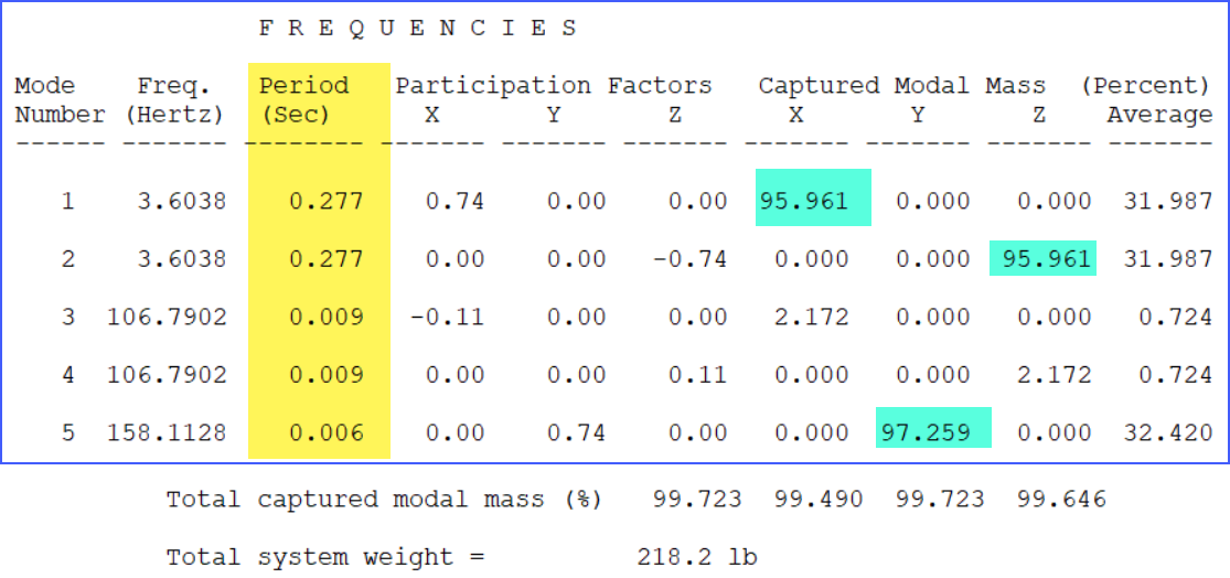

3. Given the Frequency report:
4. Notice the frequency for the first 5 modes, <1 sec. Also, the first 5 modes capture almost 96 % in all 3 axis directions.
5. The response spectrum starts at 1 sec, but from the frequency report, all modes have T < 1 sec. Therefore, the smallest given acceleration applied would always assume to be (a = 3.864 in /s/s).
6. Next the force per mode is calculated and finally all the combined modes are combined using SRSS.
7. By the time the results are calculated by SRSS the results for both R1 and R2 could be virtually identical.
In Conclusion:
The difference between Spectrum #1 and Spectrum #2 does not matter because your structure does not have any modes with a period above 1 sec. Therefore, the computed forces for both spectra are the same. If your structure had a mode with a period of 10 sec or 20 sec, then the results would be very different because the acceleration at those periods is much higher.
