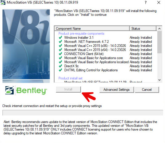

Option to install program is not available, 'Install' button is grayed out. Prompted to check internet connection and restart setup

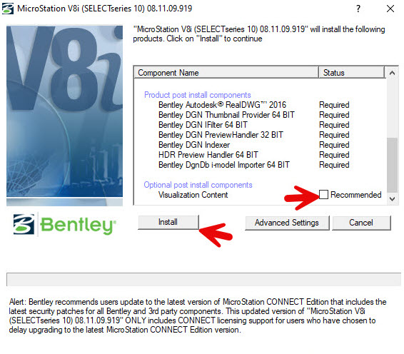

Troubleshooting Step 1:
Step 1:  During installation process scroll down and disable the option to load the visualization content
Step 2:

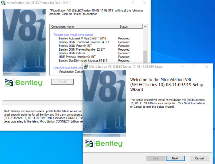

Continue with installation
