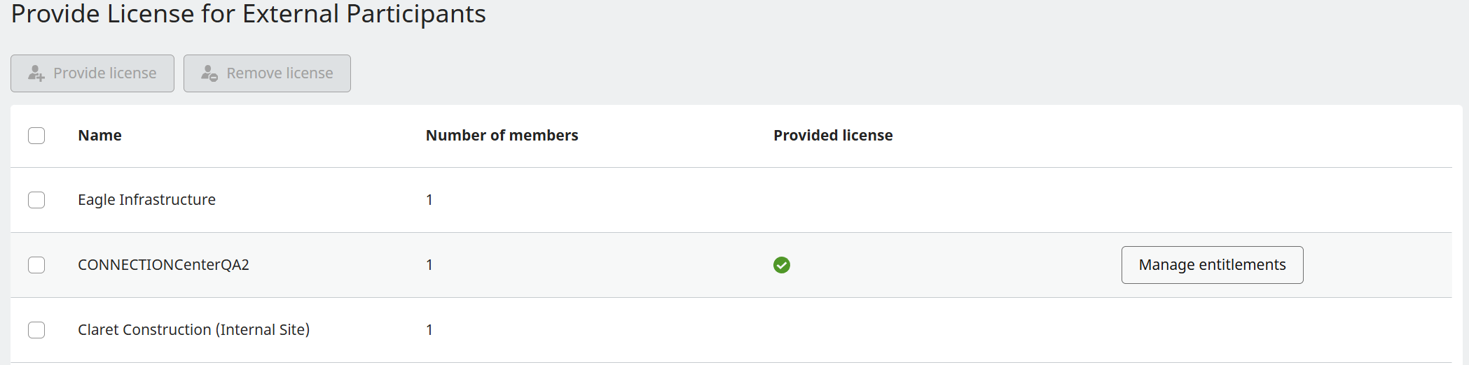

As an Account Admin, Co-Administrator or CONNECT Service Admin, you may want to provide licenses for external participants. By providing a license for the organization, the owner agrees to cover the costs for that user while participating in the project. The Provide licenses for external organizations page, available from the Administration page, lets you manage licenses for external organizations that have been added to the project. When external users are added to a project, the user, as well as the name of the organization the user is affiliated with is included with the user information.
In this interface, the external organizations are listed along with the number of people who are affiliated with that organization. The term affiliated means the user is part of an organization which has an existing account with Bentley Systems Inc.

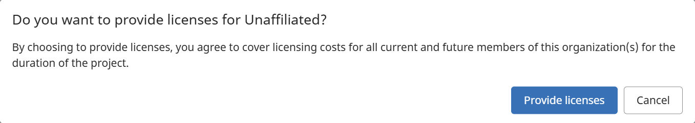

To provide a license for an organization, or for unaffiliated license, check the box next to the organization name and click the Provide license option to display the following:
When you click the Provide licenses option to confirm, all usage of the application by the participants from the organization will be billed to the owner of the project.
A green check mark will be added to the Provide license column in the grid when the owner is providing a license.

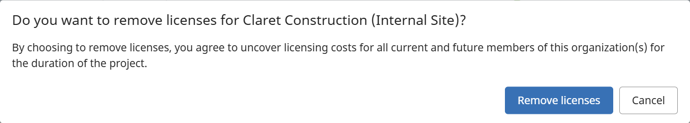

In the case where an owner is currently providing a license for an organization and wants to remove the license, as done above, check the box next the organization and click the Remove license option.
Click Remove license to confirm. Once the license is removed, the external organization will need to provide their own license and entitlement to access the project.

When you hover the mouse in an organization row, the Manage Entitlements button displays.
Click the Manage Entitlements button to display the following right panel.

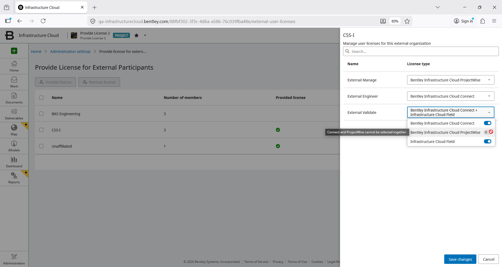

By default, Bentley Infrastructure Cloud Connect entitlement will be selected.

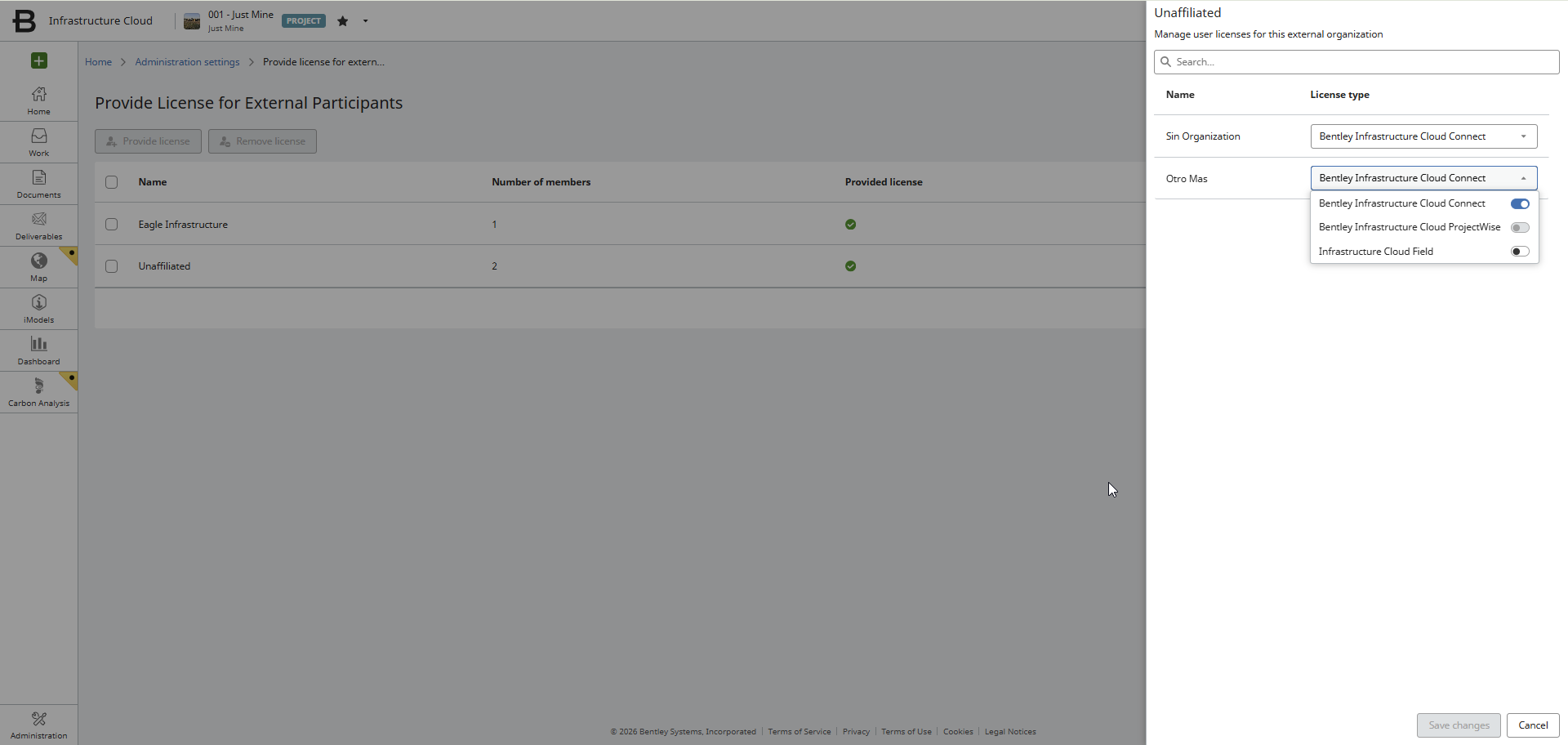

You can select one or more entitlements at once:

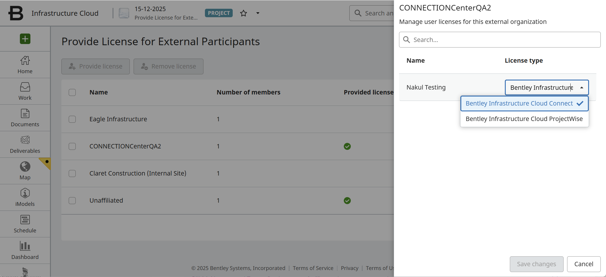

Next to the user name, select the license type from the drop down.  Repeat the process for each user in the project.
If there are many participants in the project, you can use the Search field to filter the list using the search criteria entered.
When finished, click Save changes to implement the entitlement for the selected user(s).
