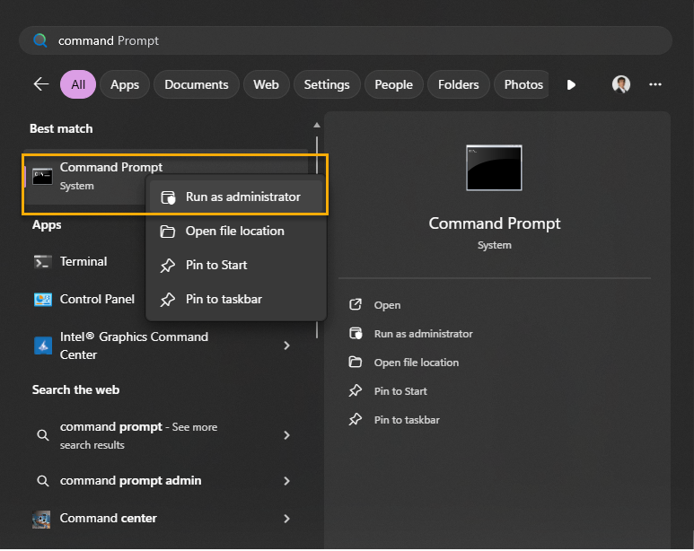

Step 2. Open Command prompt (with admin rights)
A screenshot of a computerAI-generated content may be incorrect.
