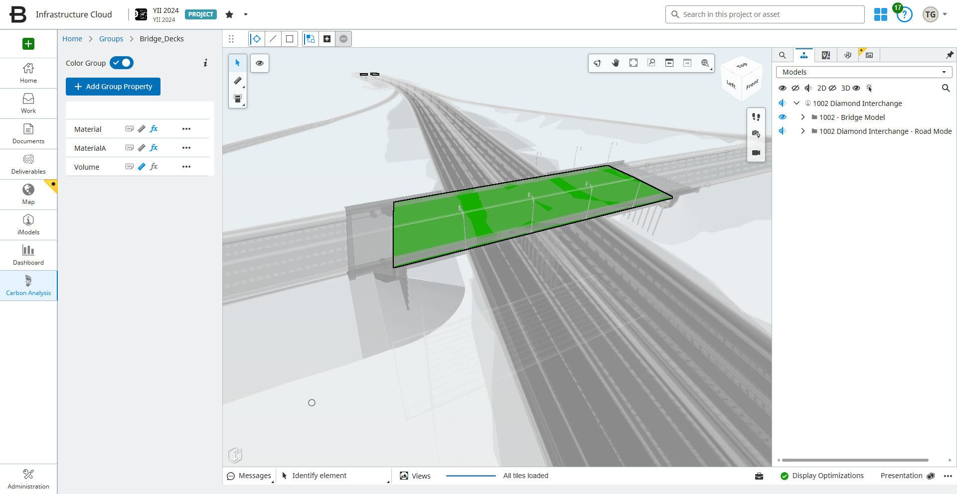

Initiate the Grouping Process by clicking the "Groups" button within the left-hand panel to start grouping the elements in the design into common material sets. The goal is to group all elements based on the material for the carbon report. You can inspect individual components by clicking on them to view their details. Depending on the maturity of the design, you may have more or less information available within the design data.
    1. Create Material Groupings: Prepare different material groupings as part of the design.
    2. Add Group: Click on "Add Group" and explore the first method: "Selection."
A screenshot of a computerAI-generated content may be incorrect.
Selection Method
Zoom in and select an element within the viewer first, then check the properties on the left-hand side. To perform the group selection, select the desired property, for example "User label", so that it will select all the elements matching the unique value for the selected property. The system will automatically colorize and zoom into the groupings for better visualization. Add the group by providing a Name and an optional Description, then click the "Save" button. A name can only contain letters, underscores, or digits. To see the added group again, turn on the "Color by Group" option.

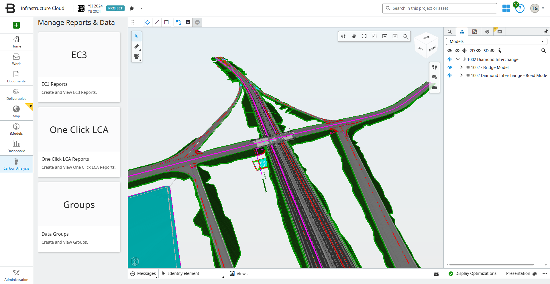

Partner Integration
After the design data has been grouped it is ready to send to one of our LCA partners to generate the embodied carbon data. Two different LCA partners are available for integration:
    1. EC3 Building Transparency
    2. One Click LCA
Both integration partners require the user to have their own account created with the external service.
EC3 accounts are completely free and can be created through the building transparency website here:  https://buildingtransparency.org/
OneClick LCA is a paid, premium service which requires an account subscription. More information can be found on their website here: https://oneclicklca.com/

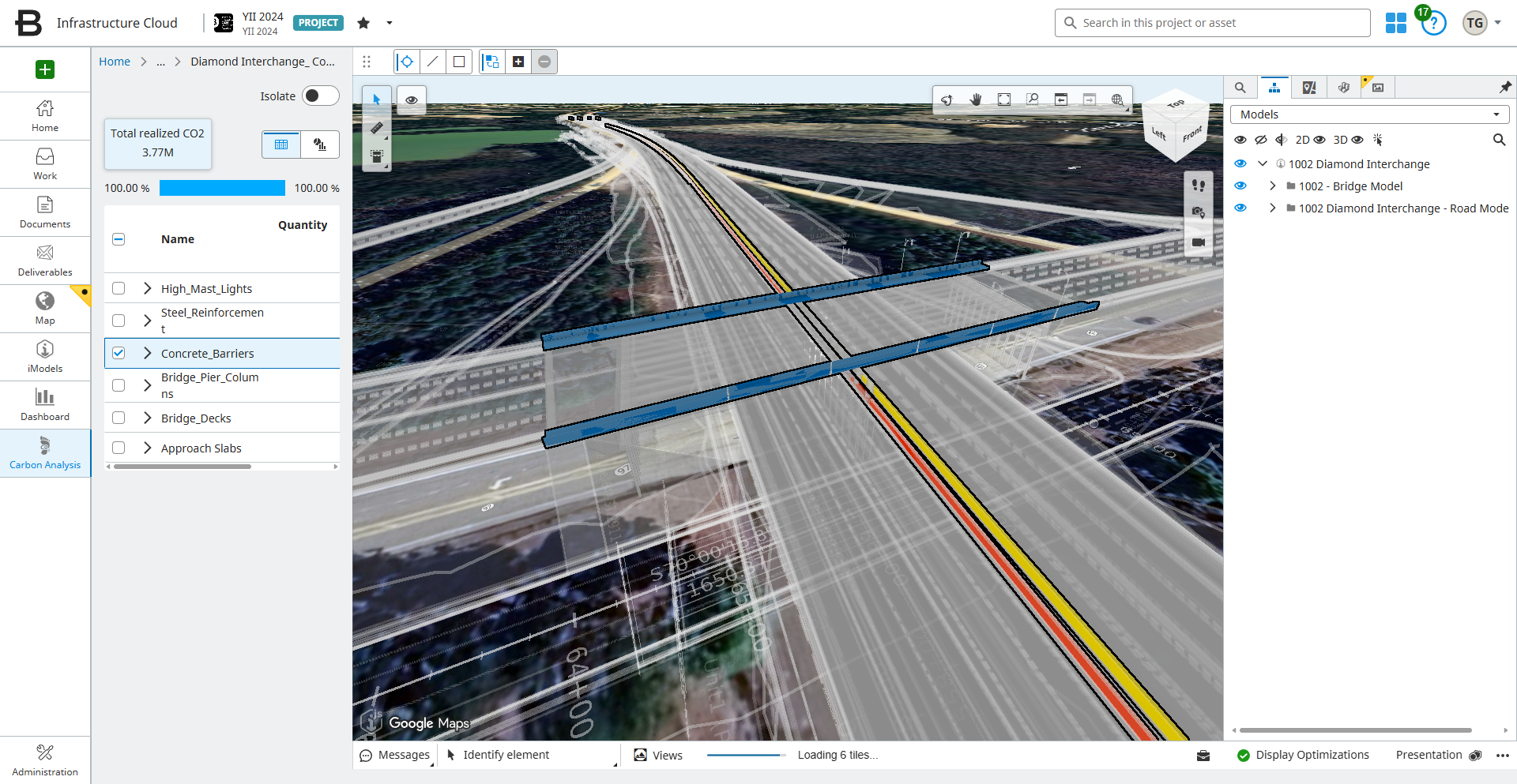

Visualization is available through the EC3 integration and allows users to more easily interpret the embodied carbon results and adjust the proposed design. Return to Bentley Infrastructure Cloud to visualize the Carbon Analysis Report from EC3. Click on the EC3 tile and, from the menu for the desired report click the ‘Visualize’ option.
This provides a heatmap visualization of the embodied carbon that allows users to overlay reports directly onto individual element information in the design. This reduces the need to sift through spreadsheets or dashboards to identify which elements are represented within the carbon information.
