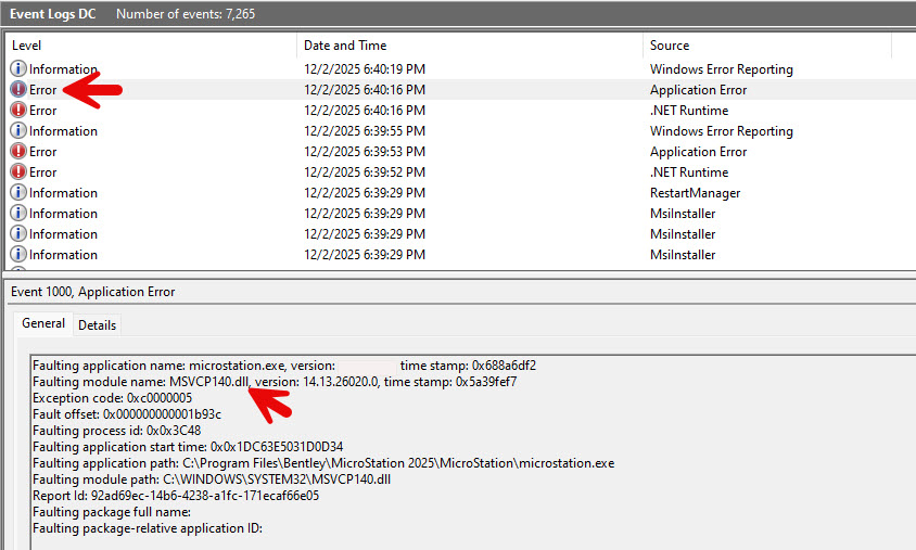

Step 1:  Go to Event Viewer
Step 2: Go to Windows Logs>Application, allow time for log to appear
Step 3: Filter on and 'Errors' or Warnings'

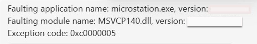

Step:4 Look for the following...

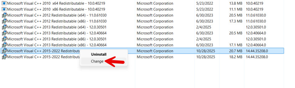

Repair installation of Microsoft component, 'Microsoft Visual C++ 2015-2022 Redistributable (x64).

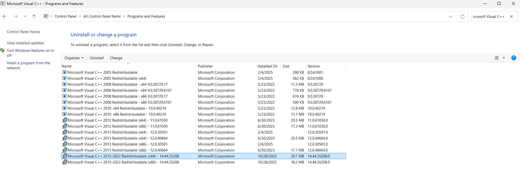

Step 1:  Open Control Panel > Programs and Features or run  appwiz.cpl
Step 2:  Go to the search and type in 'Microsoft Visual C++' locate the "Microsoft Visual C++ [Year] Redistributable" packages (both x64 and x86).
Step 3:  Select 'Microsoft Visual C++ 2015 - 2022 Redistributable (x64)'

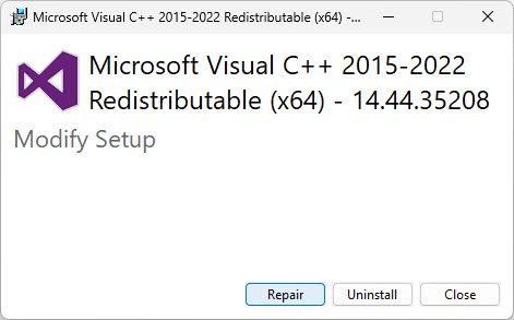

Step 4:  Right-click and select Change
Step 5:  Select the Repair option
