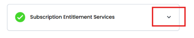

  1. Go to https://status.bentley.com.
  2. Scroll down until you find Subscription Entitlement Services.

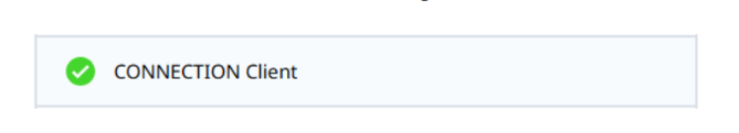

  3. Click the single-select dropdown (arrow pointing downward) and verify if CONNECTION Client shows a green checkbox.
    • If the checkbox is green, please proceed with the following article.
    • If there is an outage, check back until the issue is resolved before reaching out for additional support.

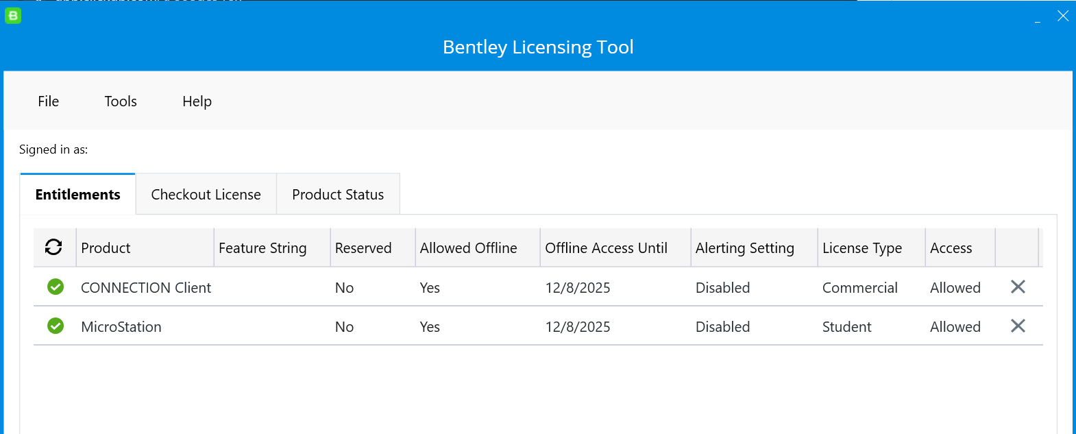

  1. Launch the CONNECTION CLIENT from your settings menu.
  2. Select your user profile icon (your name initials) in the upper right-hand corner of the window and then select License Tool.
    Note: This screenshot displays the CONNECTION Client and MicroStation applications, but the steps are consistent across all Bentley applications.

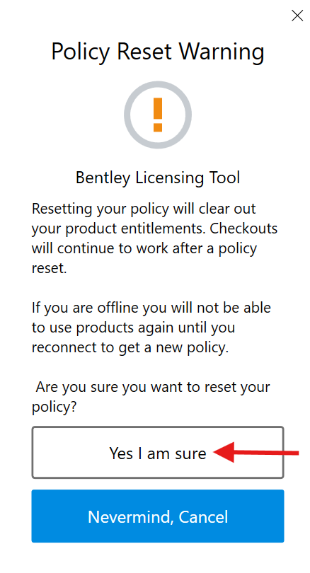

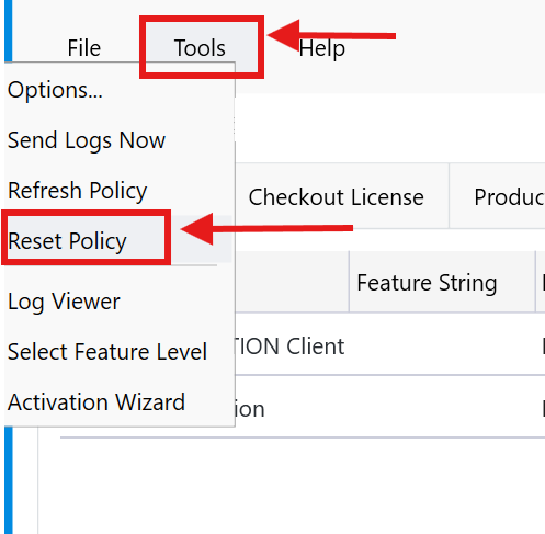

  3. Go to Tools and select Reset Policy.
  4. Confirm that you would like to reset your policy.
  5. Close and relaunch your chosen software and the CONNECTION Client. Recheck the License Tool manager in the CONNECTION Client and you should now see the License Type set as Student as in the image on Step 2 above. This means the correct access is now active and you can use your software application.
