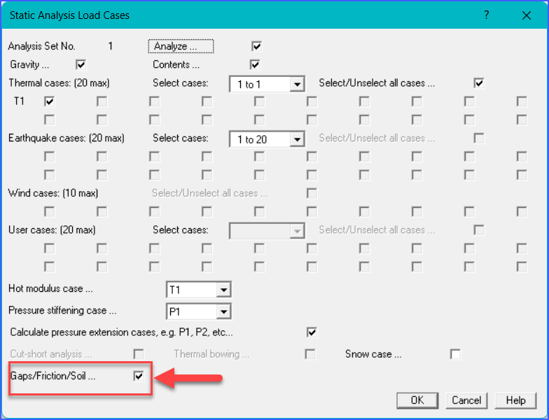

Check the Gaps/Friction/Soil checkbox that appears in the red square in the figure
below, Analysis > Static Analysis Set > Modify:
This checkbox is automatically checked if Non-Linear is checked, and unchecked if
the Non-Linear checkbox is unchecked.
Setting the max_nl_iterations property to a value greater than 0 will automatically check both the Non-Linear checkbox and the Gaps/Friction/Soil checkbox.
