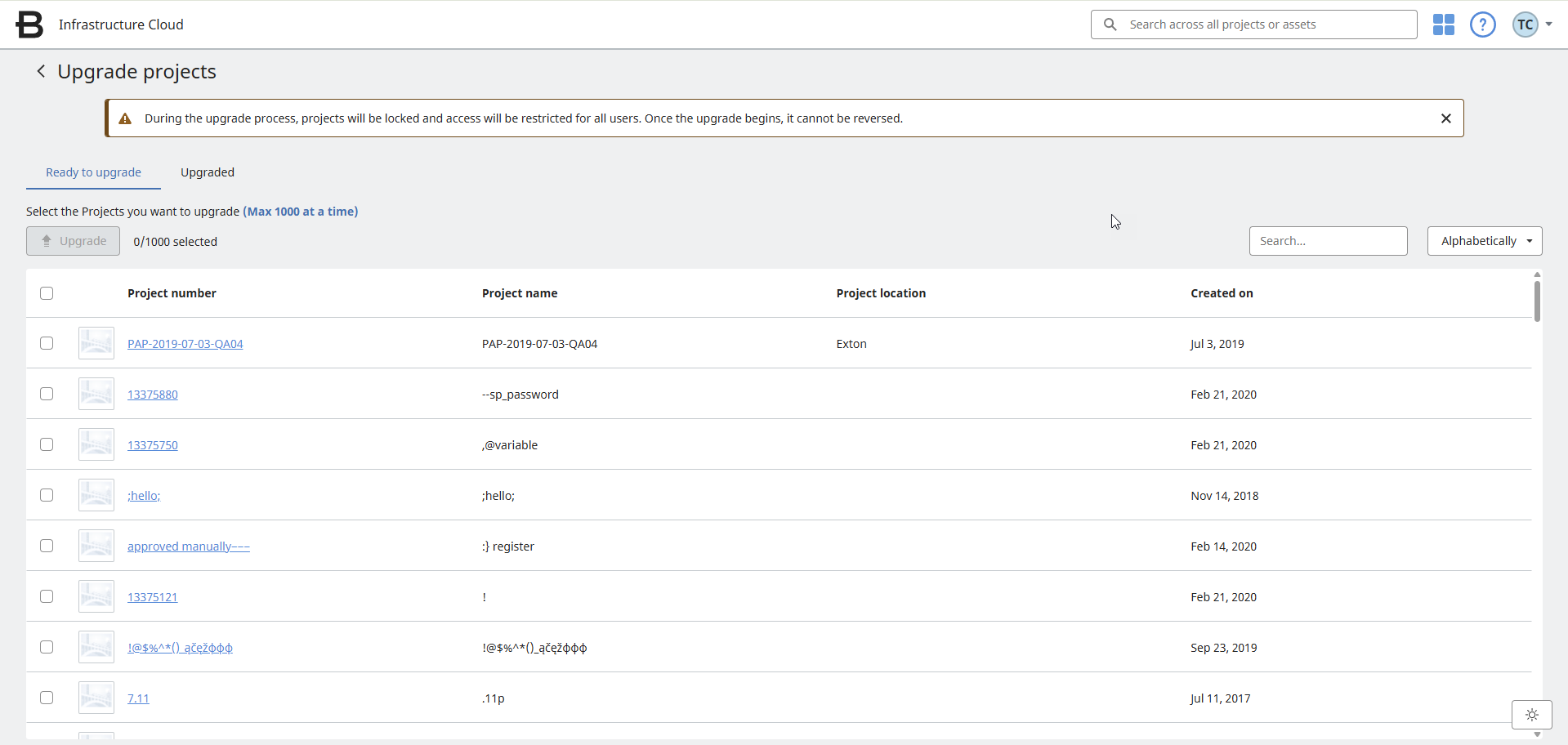

Account Admins and CONNECT Service Administrators can use the Bulk project upgrade to upgrade up to 1000 CONNECT projects at once

Single project upgrade
To upgrade a CONNECT project to an Infrastructure Cloud Project

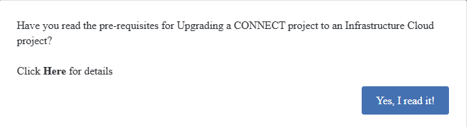

Note: The first time you click on a CONNECT project, you will get a pop-up to remind you to read about pre-requisites
'Click Here for details' – will take you the article
'Yes, I read it' – will dismiss the pop-up ad let you continue.
Click on the browser’s back arrow – to go back to the Landing Page
(This is a one time pop-up)

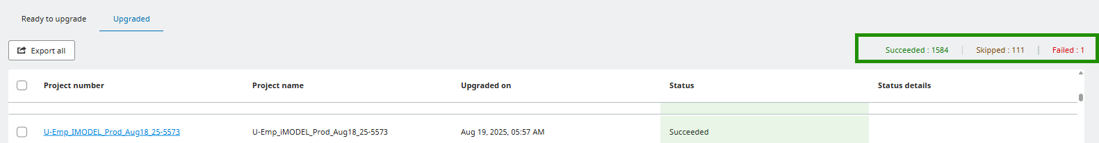

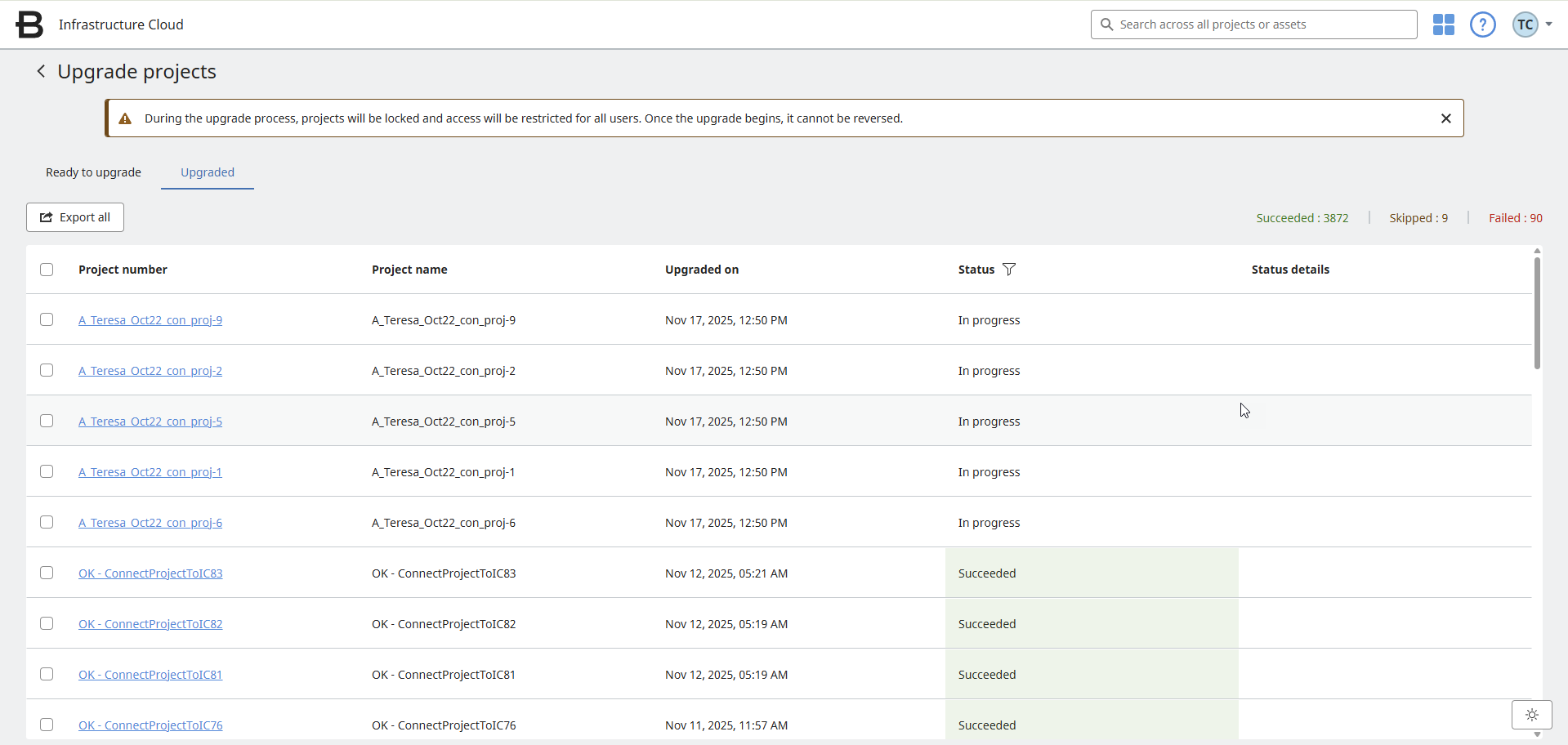

Several projects at the same time
To upgrade several CONNECT projects to Infrastructure Cloud Projects, at the same time
Note: You can use the Export button once every hour

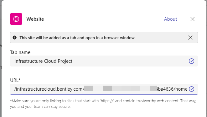

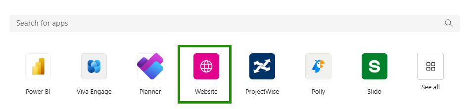

What happened to Teams integration with my CONNECT project? Will this integration still work with Infrastructure Cloud Projects?
There is no integration between Teams and Bentley Infrastructure Cloud Projects. The Teams app Website can be used to add an Infrastructure Cloud Project URL to a Team’s group or Channel
