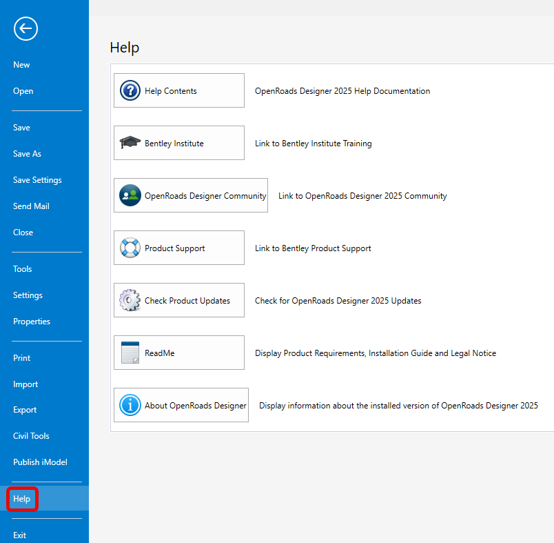

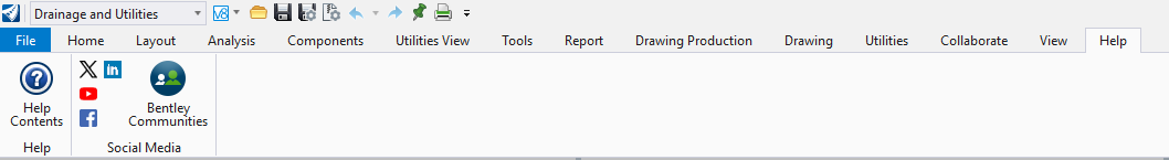

Help can be accessed from the ribbon or the Backstage. Our ribbon has several links:
Get to the backstage by clicking File > Help:

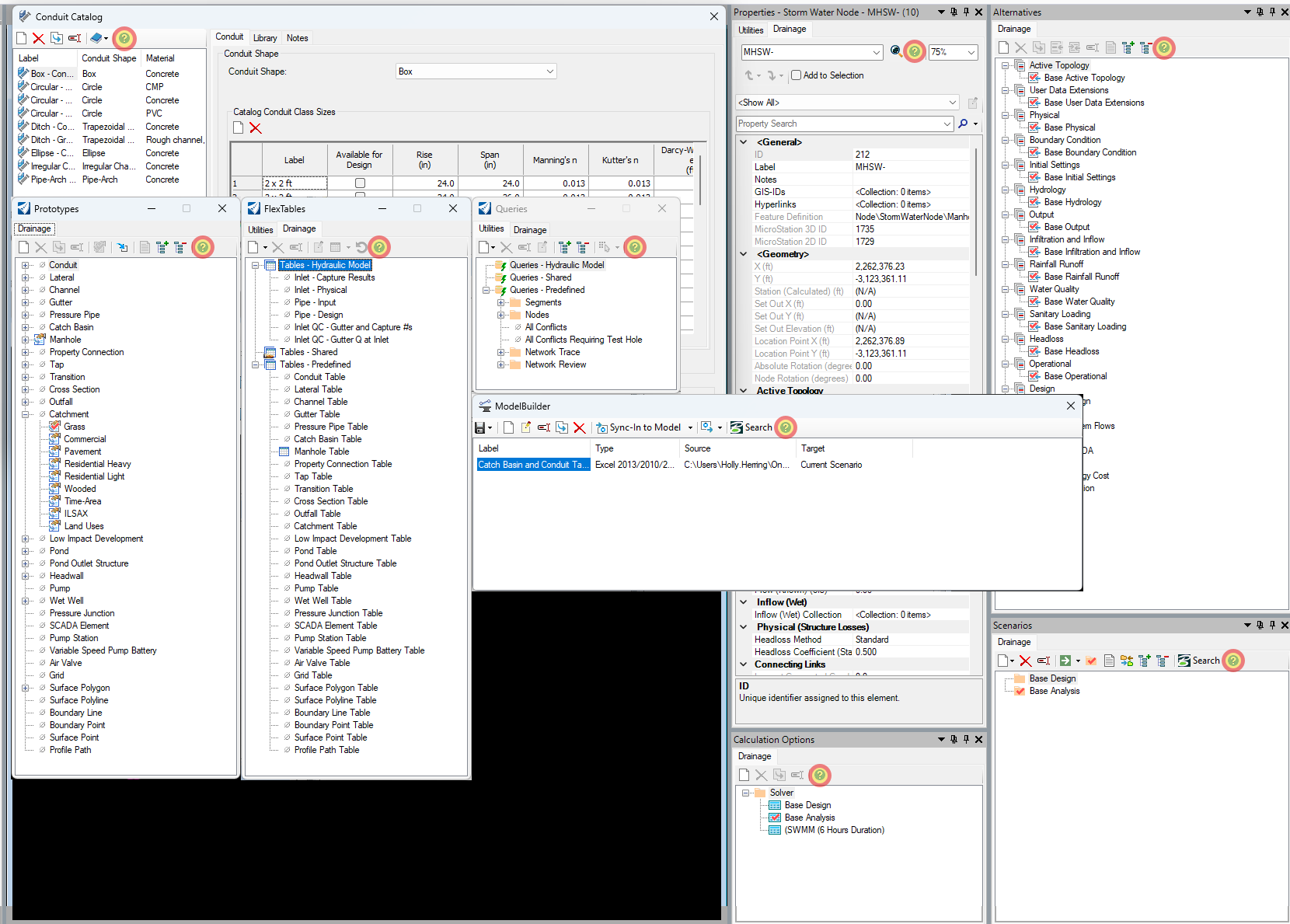

All Drainage and Utility dialog boxes have a question mark icon that takes you directly to its specific article within the suda.chm delivered with ORD located here: C:\Program Files\Bentley\OpenRoads Designer 20##\OpenRoadsDesigner\Subsurface

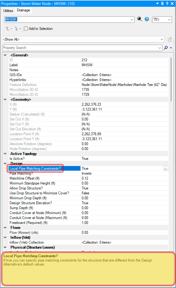

The Utility Properties contain a huge amount of information. Click on a Property row and get important information related to its definition in gray at the bottom of the window. These definitions are thorough and very helpful.
