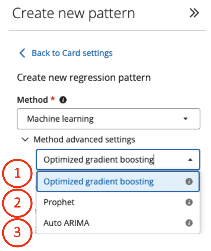

When creating a machine learning regression model, users can choose the method that best suits their time-series data properties. Here is the list of supported models at the moment:
  1. Optimized gradient boosting
  2. Prophet
  3. Auto Arima
You may select the method of your choice using the drop-down menu under Method advanced settings:
