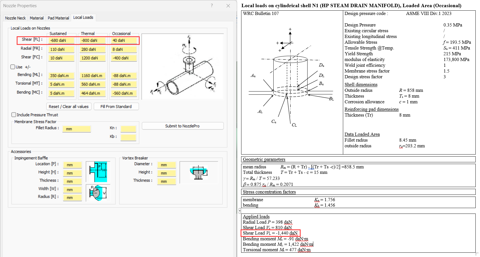

For a nozzle with the following shear loads (FL):
- Sustained Load = -680 daN
- Thermal Load = -800 daN
- Occasional Load = 40 daN
Calculation:
- Sustained = -680 daN
- Thermal = -680 + (-800) = -1,480 daN
- Occasional = -680 + (-800) + 40 = -1,440 daN
The report confirms that the shear load VL = -1,440 daN, matching the combined calculation.
