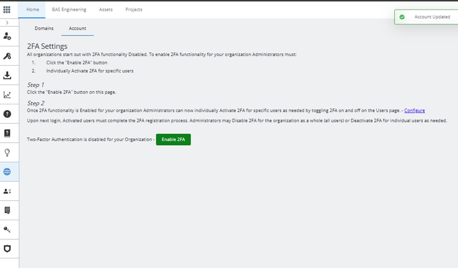

Before Administrator can apply MFA to a specific user, 2FA for account must be enabled in User Management.
•    Go to User Management -> Domains (1)
•    Select 'Account' (2)
•    Click 'Enable 2FA' (3)
Once 2FA for account is enabled:

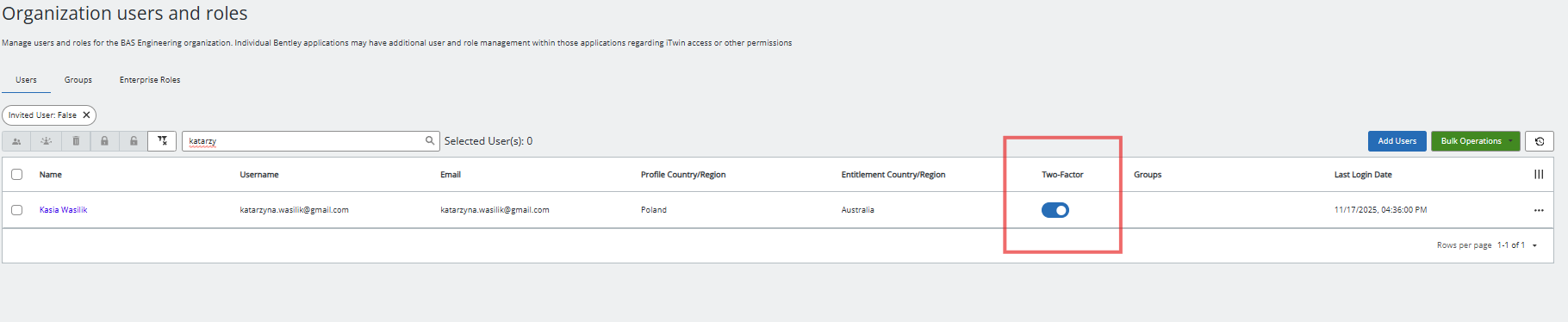

•    Go to 'Organization users and roles' (1)
•    Search for user to which MFA should apply (2)

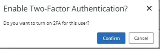

•    Click on the slider under 'Two-Factor' column to enable 2FA (3)
•    Confirm your choice
On your next login, you'll be prompted to enrol in MFA. For more details, please review this KB:
