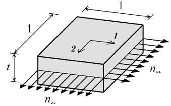

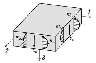

Plate elements represent thin, two‑dimensional structures with a defined thickness t. In classical plate theory, in‑plane stresses and out‑of‑plane stresses are integrated through the thickness to form stress resultants:
   Quantity    Meaning Unit
n11, n22    Membrane normal forces in local axes    kN/m
n12 Membrane shear force (in-plane) kN/m
υ1, υ2 Transverse (out-of-plane) shear forces kN/m
   m11, m22    Bending moments about local axes    kNm/m
m12 Twisting moment kNm/m
Figure 1: Stress resultants in the plate
Why per unit length?
Because the integration removes the thickness dimension, the resulting quantities are distributed per metre along the plate surface, hence the characteristic per-length units.

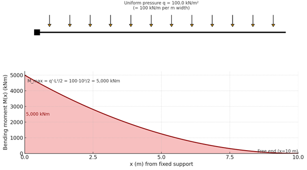

A cantilever beam under a uniform load (q) (kN/m) and length (L) (m) has a maximum bending moment:
If the same system is modelled in PLAXIS 3D as a plate 1m wide, PLAXIS reports:Eq2.png
The value is numerically the same, but the unit is “per metre” because the plate could extend beyond 1m width.
For this example, we consider a 10m cantilever beam with a uniform pressure of (q=100 kN/m2). For the beam analogy we use a 1 m strip so (q' = q · 1 = 100 kN/m).
The figure below shows the bending-moment diagram M(x)=q' · (L-x)2/2 (kNm) from the fixed support (x=0) to the free end (x=10 m). The maximum moment at the support Mmax = q' · L2/2 = 5,000 kNm is annotated.
Cantilever beam analogy (L = 10m) under uniform pressure
Figure 2: Cantilever beam analogy (L = 10m) under uniform pressure

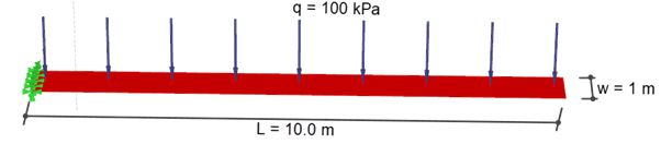

Example 1: Cantilever plate, primarily one-way bending
To understand the unit convention in PLAXIS 3D, it helps to use the analogy of a cantilever beam using a plate element. Consider a cantilever plate of length (L = 10m) and width (w = 1m). The plate is subjected to a uniform vertical surface load of:
q = 100 kPa = 100 kN/m2
Since the width is 1m, we can convert the surface load into a line load:
q' = q × 1 m = 100 kN/m
This allows us to treat the plate as a cantilever beam strip of unit width.
Model of a cantilever plate under uniform pressure (w = 1m)Figure 3: Model of a cantilever plate under uniform pressure (w = 1m)

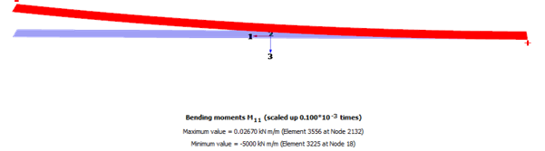

For a cantilever beam under uniform load, the maximum bending moment at the fixed end is given by:
Since this calculation was carried out for a strip of width 1m, the bending moment is expressed per unit width:
Mmax = 5,000 kNm/m
Bending moment diagram (w=1m)
Figure 4: Bending moment diagram (w=1m)

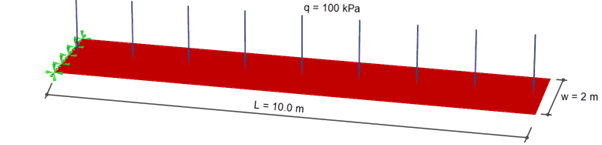

Example 2: Same plate, width increased to b = 2 m
Now the total applied surface load is spread over a plate 2 m wide. Therefore, the line load over the entire plate is:
q'total = q · w = 100 × 2 = 200 kN/m
Model of a cantilever plate under uniform pressure (w = 2m)Figure 5: Bending moment diagram (w=1m)

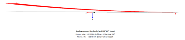

The maximum total bending moment will be:
But PLAXIS reports moments per unit width. Since the plate is 2 m wide, the per-unit-width bending moment is:
Bending moment diagram (w=2m)
Figure 6: Bending moment diagram (w=2m)
The reported bending moment per unit width does not change with plate width. If the plate becomes 2m wide instead of 1m, the load is spread over a wider area, but the bending moment per unit width remains the same because the plate still behaves similarly to a cantilever beam. So, PLAXIS always outputs results in kNm/m, consistent with the unit-width assumption of plate elements.

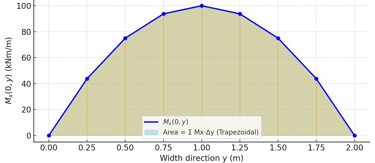

  4. Choose integration strategy. For example, for a desired cut at x = x0, build a 1-D sampling of Mx (x0,y) and numerically integrate across y using the trapezoid rule or Simpson:
Figure 7 shows the graphical representation of the trapezoidal summation (integration) of bending moments across the plate width at x=0:
Mtotal (x=0) ≈ 131.25 kNm
This total is the integrated bending moment about the fixed edge - exactly how finite element post-processing combines nodal or Gauss point results into global section quantities.
Optional: Perform a mesh sensitivity study. Refine the plate and adjacent soil mesh and confirm that reported N, Q, M fields stabilise.
Trapezoidal summation of bending moments across plate width
Figure 7: Trapezoidal summation of bending moments across plate width
