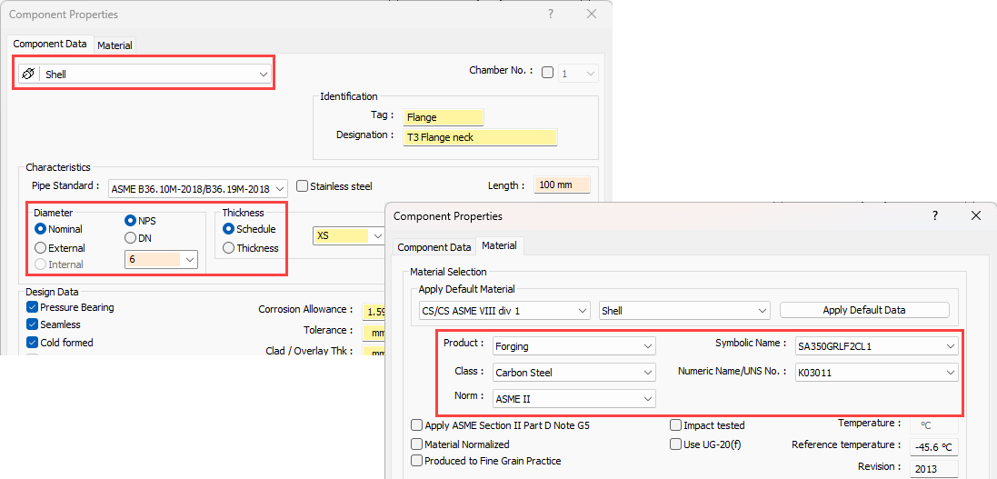

When analyzing a model in AutoPIPE Vessel the following warning number was reported.
944      GEOMETRY (Flange): This component cannot be considered a Standard Pipe due to the type of material. It should be "Seamless Pipe", "Welded Pipe", or "Fitting". The dimensions might not conform to the Standard.
Why and how to avoid it?

Users may encounter a geometry-related warning when defining materials for components in the system, particularly when a shell component (Tag: Flange) is incorrectly treated as a pipe.
Root Cause
The warning is triggered when:
Resolution Steps
To resolve this issue:
    1. Review the component type: Ensure that the shell is not mistakenly categorized as a pipe.
    2. Update the material definition: Change the material to one of the acceptable types listed in the warning:
      • Seamless Pipe
      • Welded Pipe
      • Fitting
