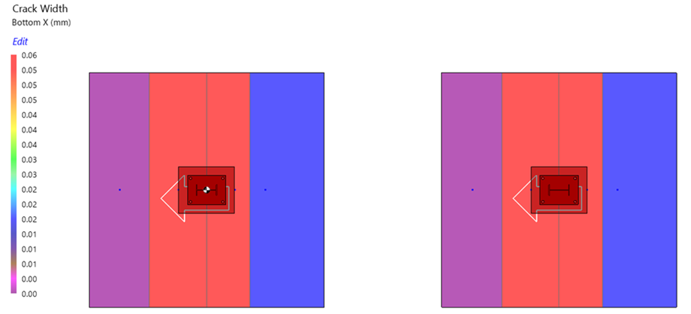

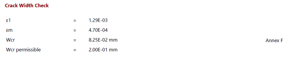

- Design for crack-width: Adds optional crack width checks for design to ACI 318 (2014 & 2019) and IS 456 (2000), for all foundation types and takes corrective steps to address any failures. The reinforcement design in previous versions did not include the effects of crack width.

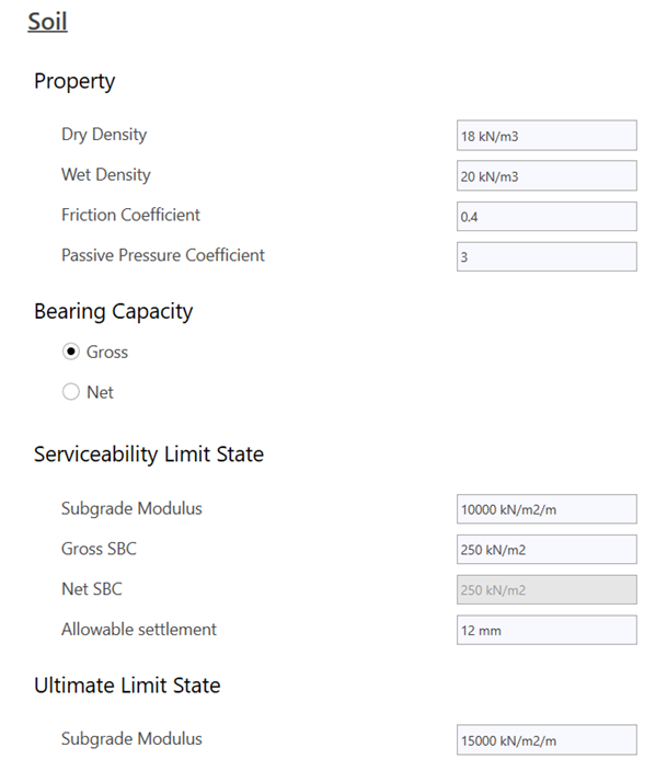

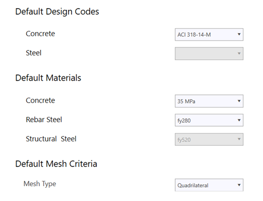

- Workflow Simplification: Introduces user-defined property defaults with automatic assignments for design codes, material, soil properties, design options, and more. This significantly reduces the manual operations required in previous versions.

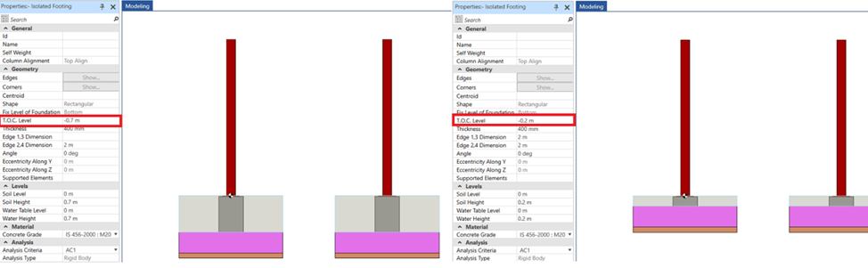

- Adjusting foundation levels: Allows changing foundation levels for all foundation types after they have been created, with automatic recalculation of the pedestal heights and soil overburden & hydrostatic pressures for consistent results. The earlier versions only allowed specifying the foundation levels during the creation of foundations.

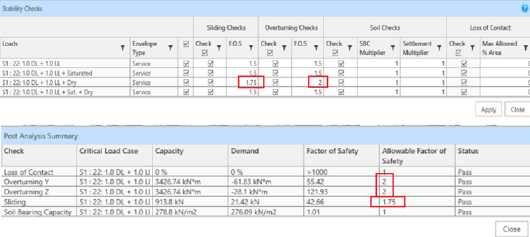

- Extended control for stability checks: Allows specifying individual sliding and overturning factors of safety for stability checks for each load combination. The previous versions only allowed one value each for sliding and overturning for all load combinations.

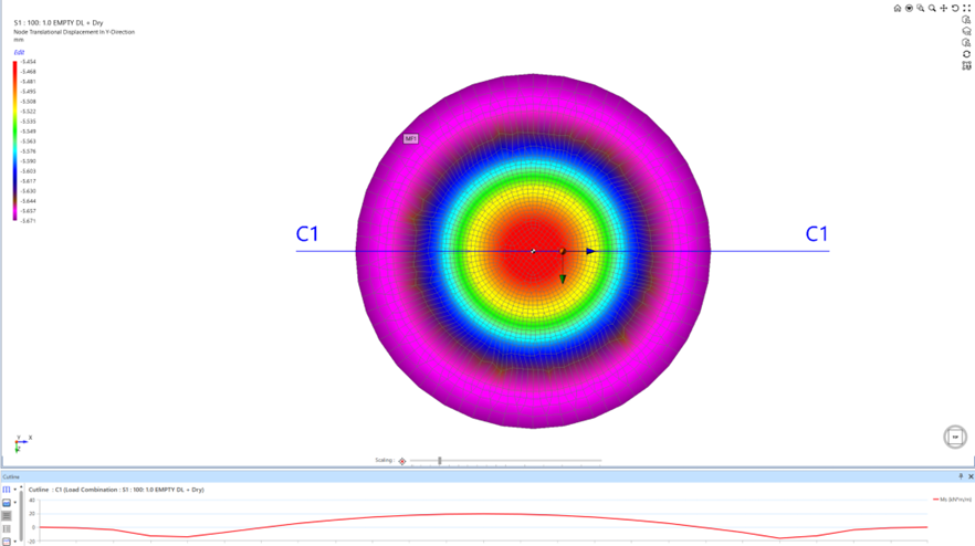

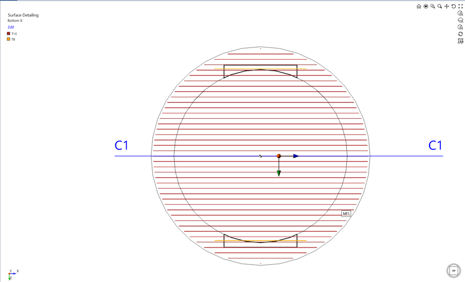

- Circular Mat Design: Enables design of circular mats with orthogonal reinforcement as per ACI 318 (2014 & 2019) and IS 456 (2000). The previous versions only allowed modelling and analysis of such foundation types.

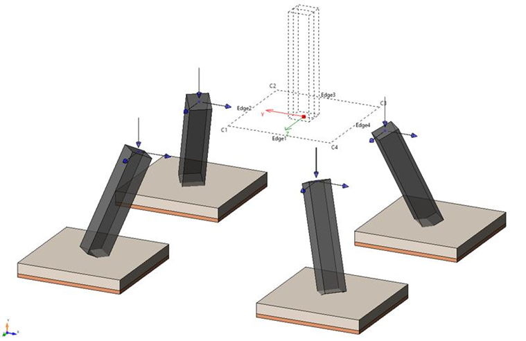

- Foundation modelling with reactions: Enables the modeling, analysis, and design of all foundation types by modeling pedestals and applying reactions of multiple load combinations directly to them, without the need to import a STAAD superstructure model. In previous versions, pedestals could only be generated for files having an imported superstructure model based on the top of foundation and bottom of column elevation but could not be created or loaded independently. Ideal for:
- Analyzing and designing foundations for specific structures in a project that do not require an exclusive superstructure model.
- Performing preliminary foundation dimensioning and BOQ estimates with specific sets of reaction loads.
- Analyzing and designing of foundations whose superstructure has been analyzed with a third-party application.
