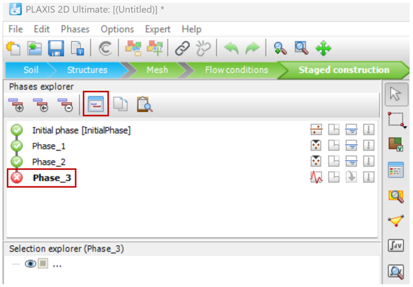

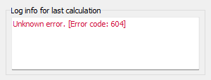

During the calculation, a red cross icon appears, and the Log info displays:
Unknown error. [Error code: 604]
You can view the Log info by double-clicking on the phase or by selecting View Phases in the Phases Explorer, as shown below:

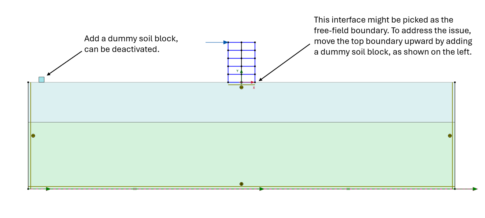

The issue occurs because PLAXIS 2D incorrectly considers the top horizontal interface as a potential free-field boundary, which leads to an error in version 25.1.0.
A simple workaround is to add a small dummy soil block above the top boundary of the model. This prevents the top horizontal interface from being picked as a free-field boundary. The dummy block (e.g. linear elastic material) can be deactivated so it does not affect the analysis.
