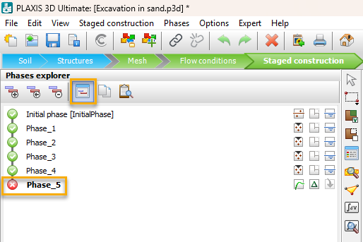

Problem description
An issue has been identified when running a PLAXIS 3D Safety calculation that includes beam structural elements. This problem occurs in this specific release version: PLAXIS 3D 2025.1.0.1991
During the calculation, the red cross icon appears, and when viewing the Log info, it displays:
Unknown error. [Error code: 602]
The Log info can be found when you double-click on a phase or by clicking on the View Phases icon in the Phases explorer, as shown below:
To verify your current PLAXIS version and build, go to Help > About in the application menu.
