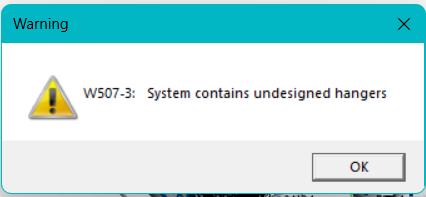

W507-3: System contains undesigned hangers... message appears when using AutoPIPE, why?
The following appears when trying to analyze a model in AutoPIPE, why?
Warning
OK
How to avoid this message.
This is a warning message to the user to be aware that the model has a number of Spring supports that are set as Undesigned. If an analysis is performed, incorrect support loads will be used and the results would  be inaccurate.

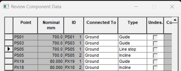

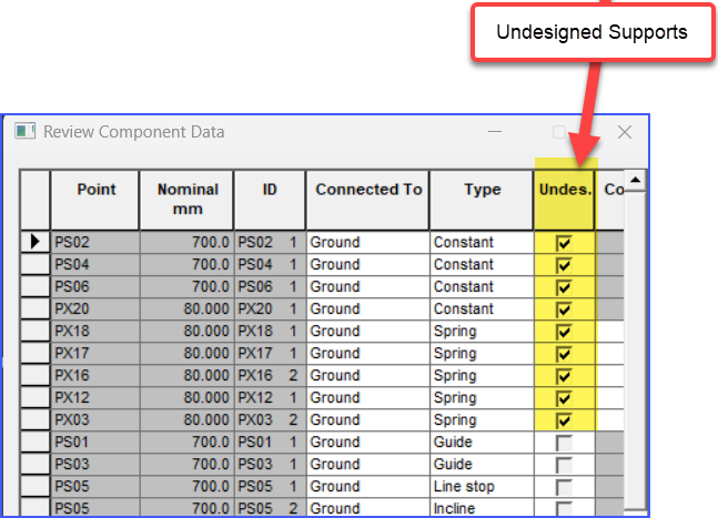

Question: Which supports are set to Undesigned.
Answer: Open Support input grids and order the Undesigned column to see if any support has this option enabled.

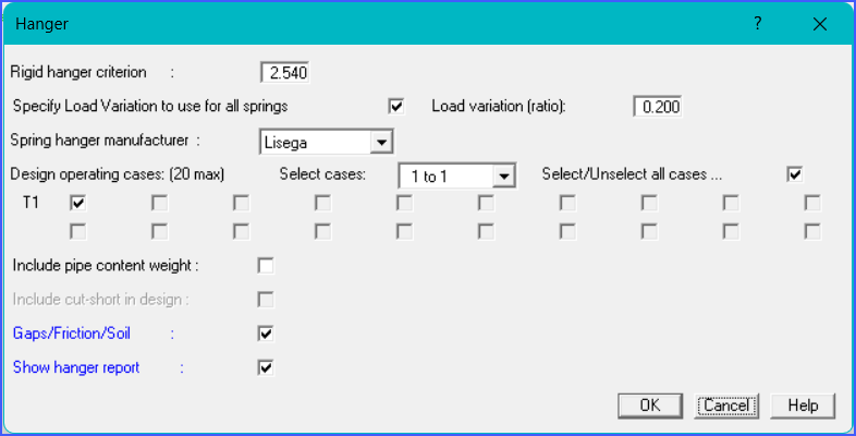

Simple, run Hanger Selection command (Analysis > Analyze > Hanger Selection), and then analyze the model.
