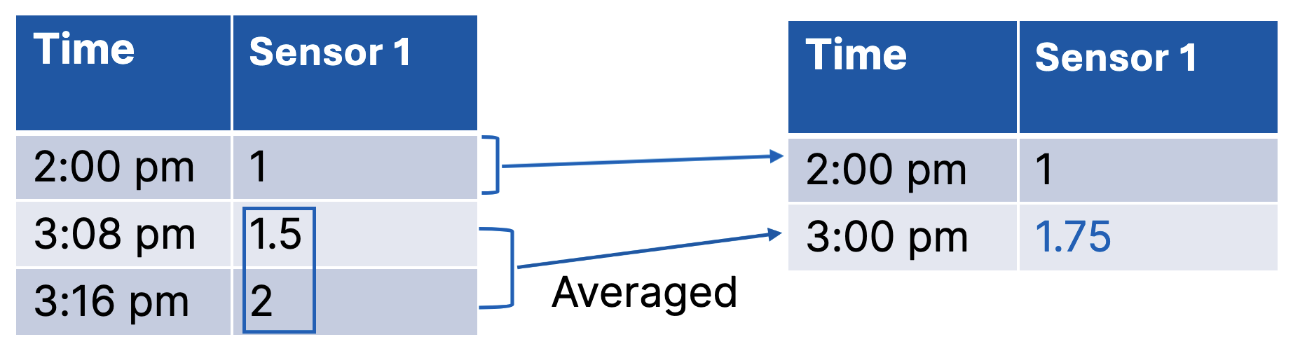

Sampling Interval
The sampling interval is the amount of time between two consecutive data points in a time series used for the analysis. It averages each sensor's data over each period independently.​The example below shows a sampling interval set to 1 hour.

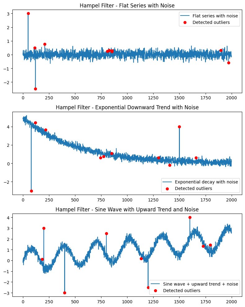

Outlier removal
Once resampled, we exclude outliers using a Hampel filter so that a bad data point doesn’t distort the model. This creates a sliding window of size 10 that flags points whose deviation from the local median exceeds 6 times the scaled Median Absolute Deviation (MAD):​
MAD=median(∣xi −median(x)∣)
 Hampel filter for outlier detection

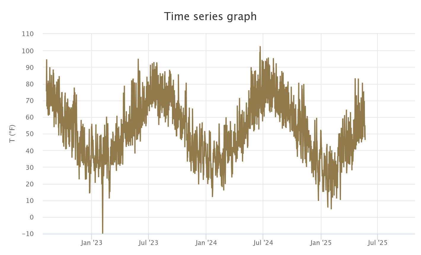

Here is an example of time-series data:
Example of a time-series sensor data

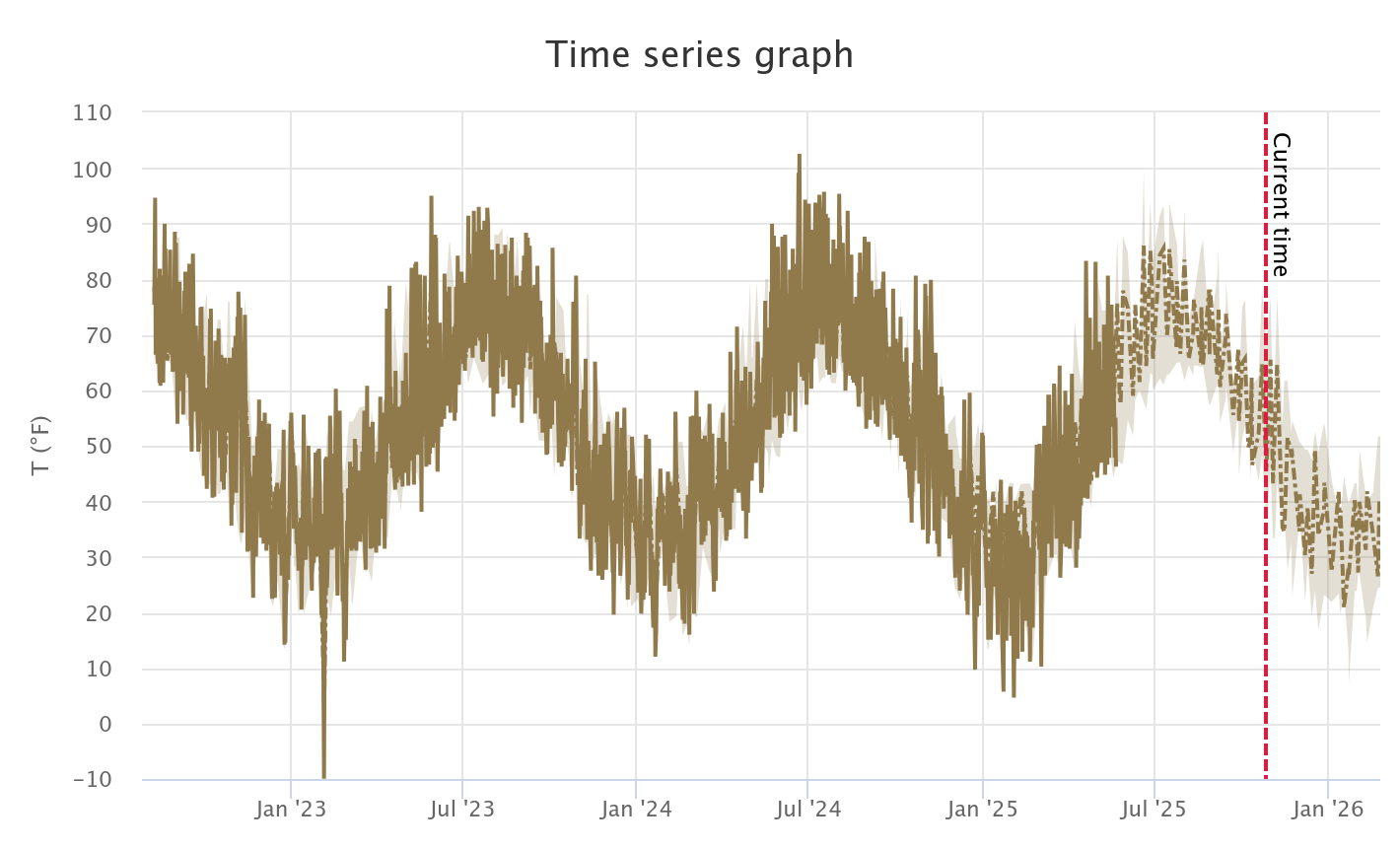

that might get a machine learning regression pattern, showing the expected, lower, and upper band confidence intervals:
A regression machine learning pattern

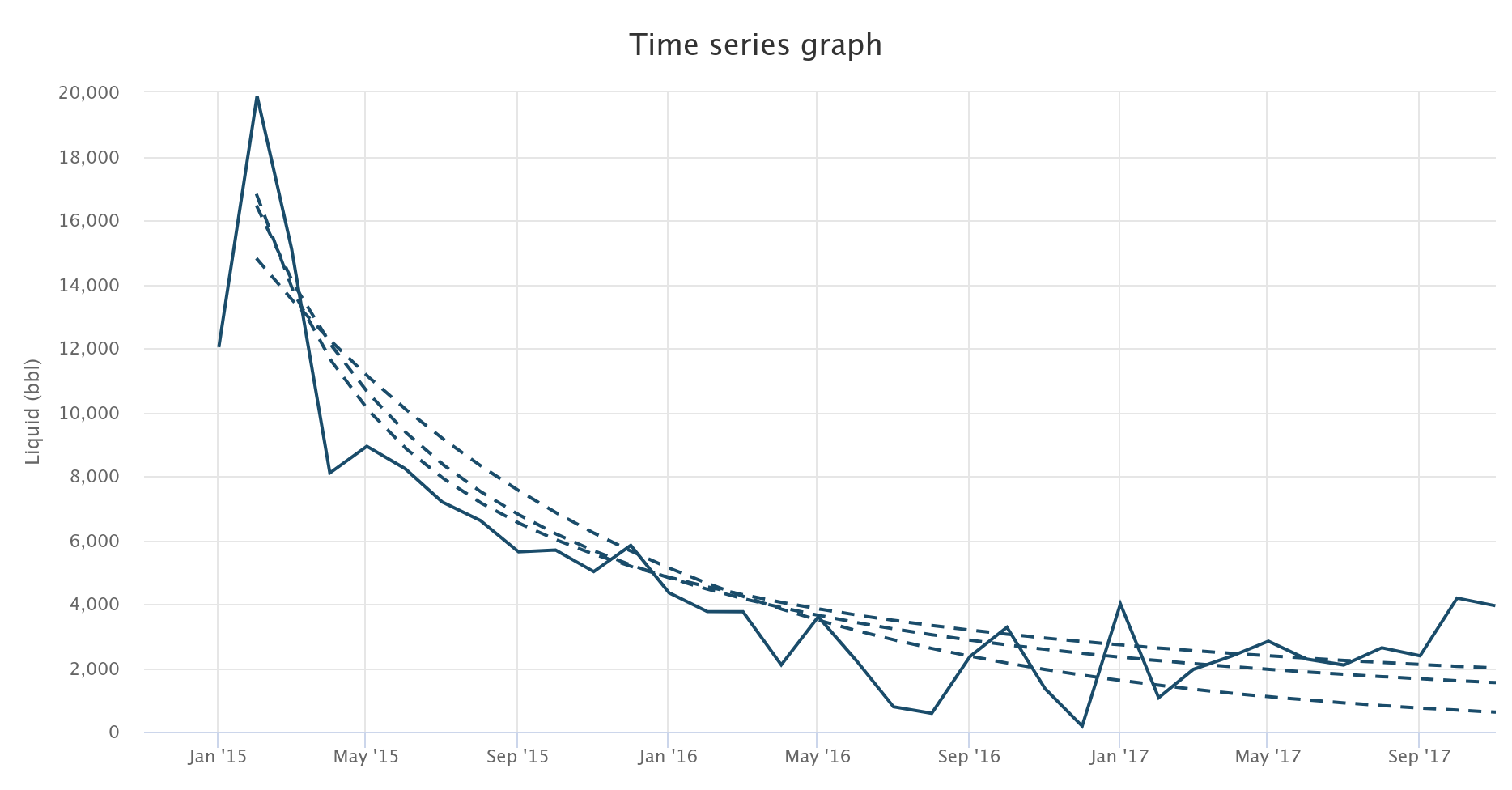

The supported curve-fitting options are more traditional mathematical models, commonly used to fit a curve to declining time series data. We support several curve types: Linear, Exponential, Harmonic, and Hyperbolic. Linear and exponential curves can capture both upward and downward behaviours, while harmonic and hyperbolic are designed for declining trends only. Here is an example of exponential, harmonic, and hyperbolic curves fitted over a declining time series data:
Curve-fitting regression pattern example

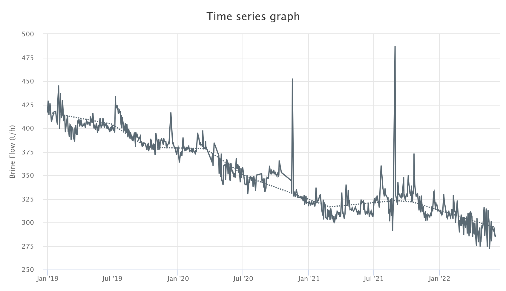

The machine learning method
The machine learning trend algorithm creates a seasonality analysis that decomposes time series data into long-term trend and seasonal components, like daily, weekly, or yearly cycles. Then we only present the trend component after this decomposition. Unlike a simple linear trend-line, this model can handle non-linear behaviours and recurring patterns, making it ideal for uncovering how a metric truly evolves. This is an example of the machine learning trend created for a declining time-series sensor data:
Machine learning trend pattern example

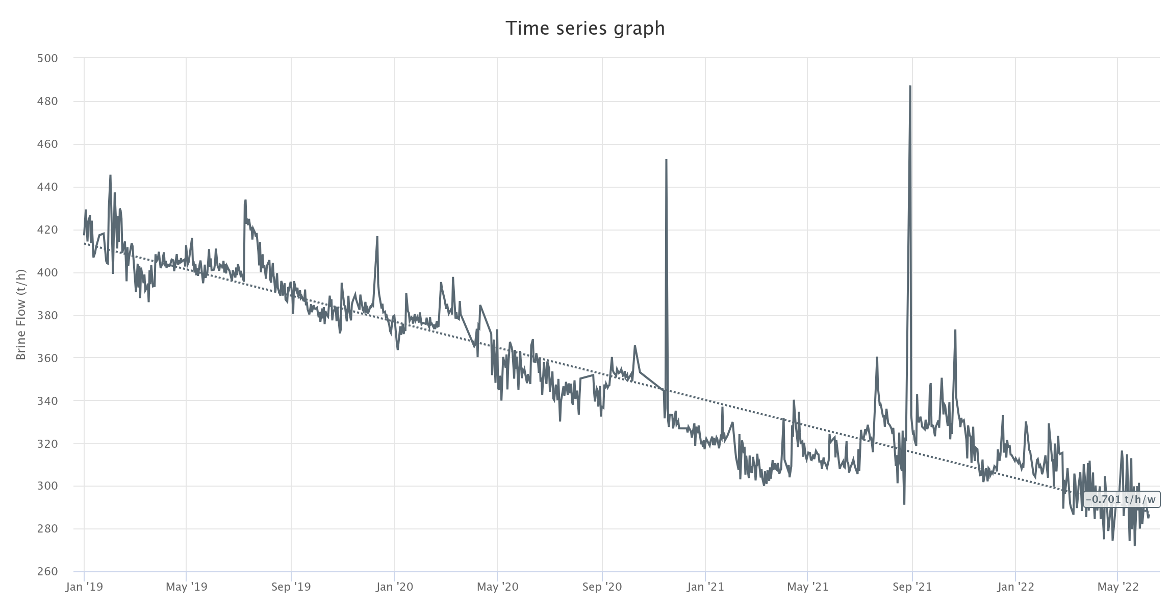

Linear trend
This is the legacy linear trend option that fits a line to the data, for a simple and fast trend analysis of the time series sensor data.
Linear trend pattern example
