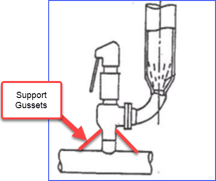

Q. How to model gusset supports on branch piping using AutoPIPE?
Example:
In short, this modeling approach will focus on adding a beam section from the surface of the header pipe to the surface of the branch pipping. Then insert a beam section between the surface points established.

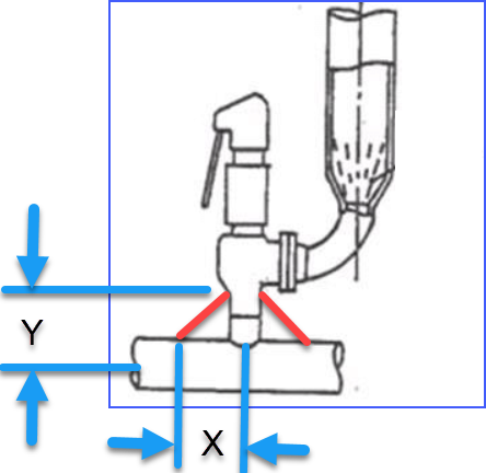

  1. Quantify the dimension of the gusset center interface with both the header pipe and branch piping

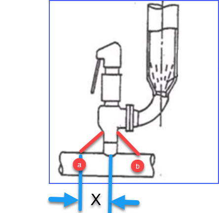

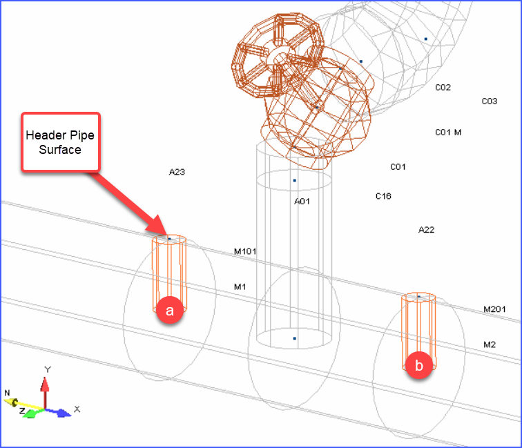

  2. Insert a node point on the header pipe at the distance X in the +ve (a) and -ve (b) directions.

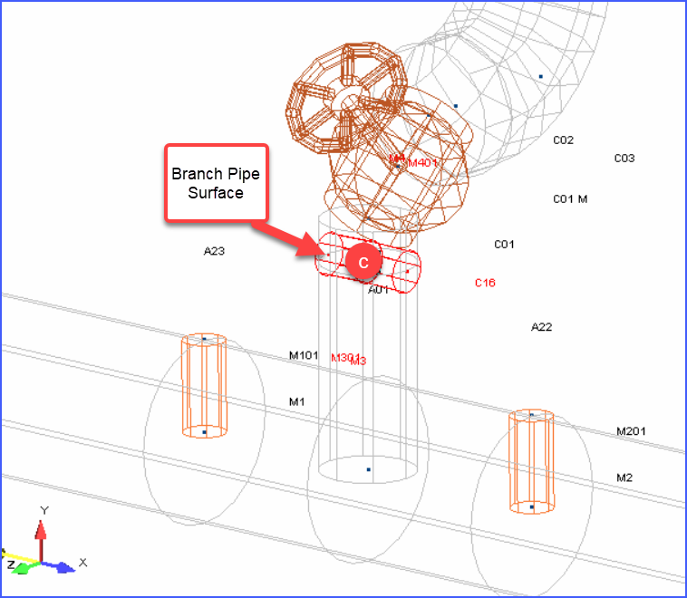

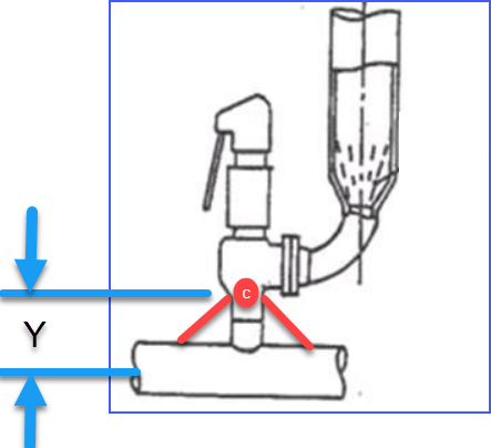

  3. Insert a node point on the branch piping distance Y (c) from the header pipe
  4. Recall that AutoPIPE does not have a concept of pipe surface in the model UI. Therefore, the surface points need to be defined. Insert a rigid beam between the new header pipe node points (a and b) to the surface of the header pipe.
    1. Note: Beam definition should ignore weight. Therefore, suggest using Rigid Beam section ID 0, and change the size to be an appropriate size for the model geometry (ex,  Shape = Pipe, size = 2" OD, thickness = 0.5")

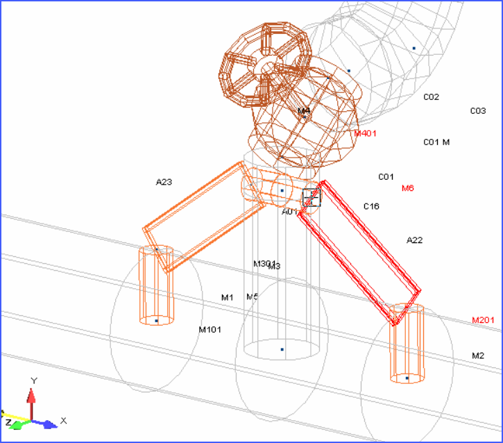

  5. Move to the new branch pipe node point (c) and insert a rigid beam to the surface of the pipe in both the +ve and -ve directions parallel to the header pipe.
    1. Note: Suggest using Beam Id in previous step.

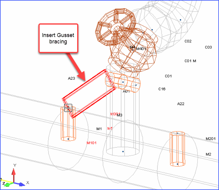

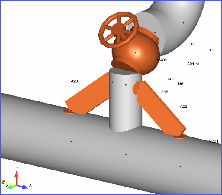

  6. Define a new Gusset Beam ID with properties used in design.
  7. Insert beam, connect surface of header pipe defined to surface of branch pipe defined.
  8. Repeat step above for gusset on the opposite side of branch piping
  9. Done.
Make any adjustment to the Beam Id definitions, or surface connection points as needed to closely mimic actual gusset support design.
