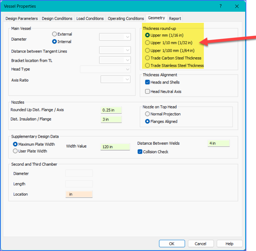

Q. Why does AutoPIPE Vessel round-up the wall th'k significantly higher than the req'd th'k?
Answer:
AutoPIPE Vessel give the user an option to round up the wall thickness calculation to the nearest whole fraction accuracy selected on the Vessel Properties> Geometry tab> Thickness Round-up group.
See AutoPIPE Vessel help> search for "Example of rounding Up of Thickness Using" for details on this feature.
