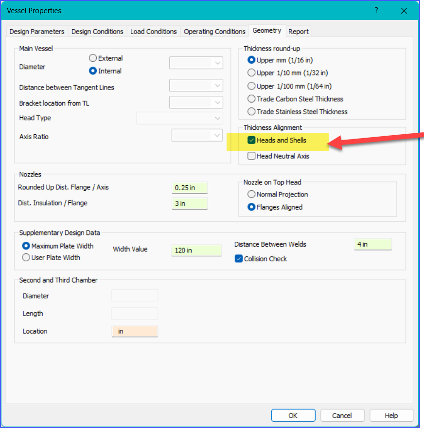

Q. Why is the pressure vessel Shell and Head the same thickness when the required thk is different?
Answer:
AutoPIPE Vessel give the user an option to align the thickness between the Heads and Shells to exactly the same. When this option is disabled, the Head and Shell thickness will be out of alignment or different.
