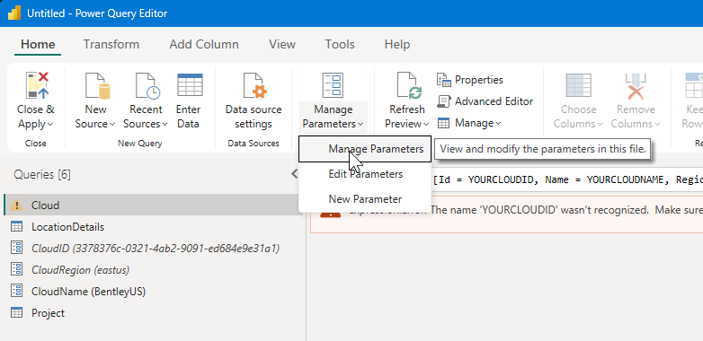

The PowerBI reports are designed to be useable by any company, however for most cases you will wish to "hard-code" your cloud information into the report. When first downloaded, the reports utilize Parameters which are designed to be user adjustable without having to re-write the entire report. However, they reports have been setup to easily switch over to a hard-coded cloud information.

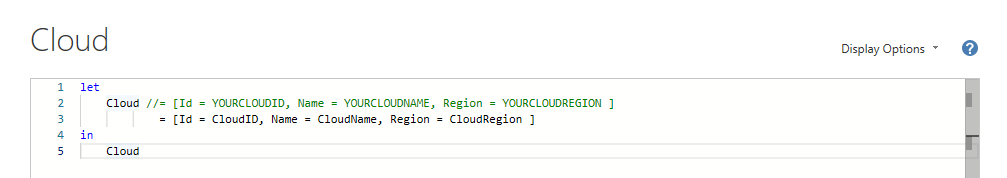

Edit the "Cloud Query" which currently looks similar to this:
Replace the YOURCLOUDID, YOURCLOUDNAME and YOURCLOUDREGION with the values from the Cloud Parameters Report.
Move the // from the first line to the second:
Save and Close the Cloud Query.

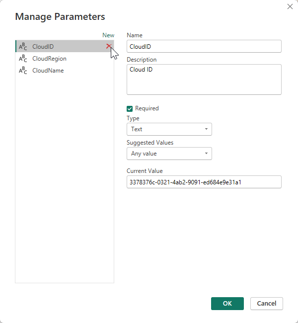

Delete the Parameters for CloudID, CloudRegion, and CloudName. You may wish to keep the Project, and any other Parameters that are in your report.
