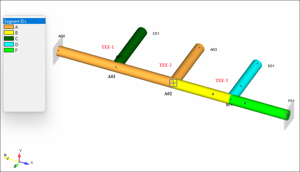

This limitation was introduced in AutoPIPE to prevent incorrect modeling of tees. The error indicates that header and branch piping are modeled on the same segment, which is not allowed.
The error message is self-explanatory: Header and branch piping must be modeled on separate segments. AutoPIPE enforces this rule to ensure proper TEE representation.
Refer to the examples below for correct and incorrect TEE modeling:
Modeling Examples:
Model 1 (TEE-1)
Model 2 (TEE-2)
Model 3 (TEE-3)

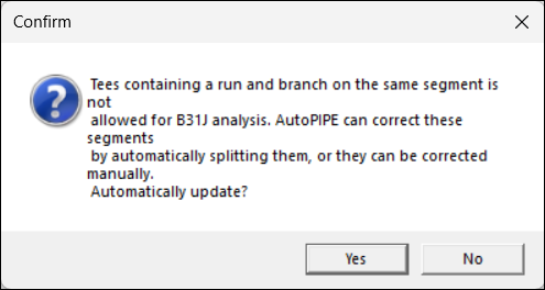

Auto-Correction Feature:
When opening older models with incorrectly modeled tees, AutoPIPE prompts:
Options:
