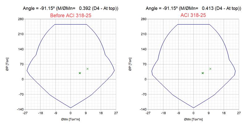

ACI 318-25 refines several strength provisions to improve design consistency. The shear strength equations were revised to restore capacity in members affected by size-effect reductions in ACI 318-19, particularly for walls and footings. Seismic wall provisions were adjusted to reduce excessive conservatism in high-ductility designs. Updates to development length and φ-factors improve anchorage predictions. Notably, the φ-factor for flexural compression now varies with axial load, producing smoother and more realistic P–M interaction curves near balanced point for columns and compression-controlled members.
Figure 3. Changes in the flexural compression zone in the P-M interaction curve

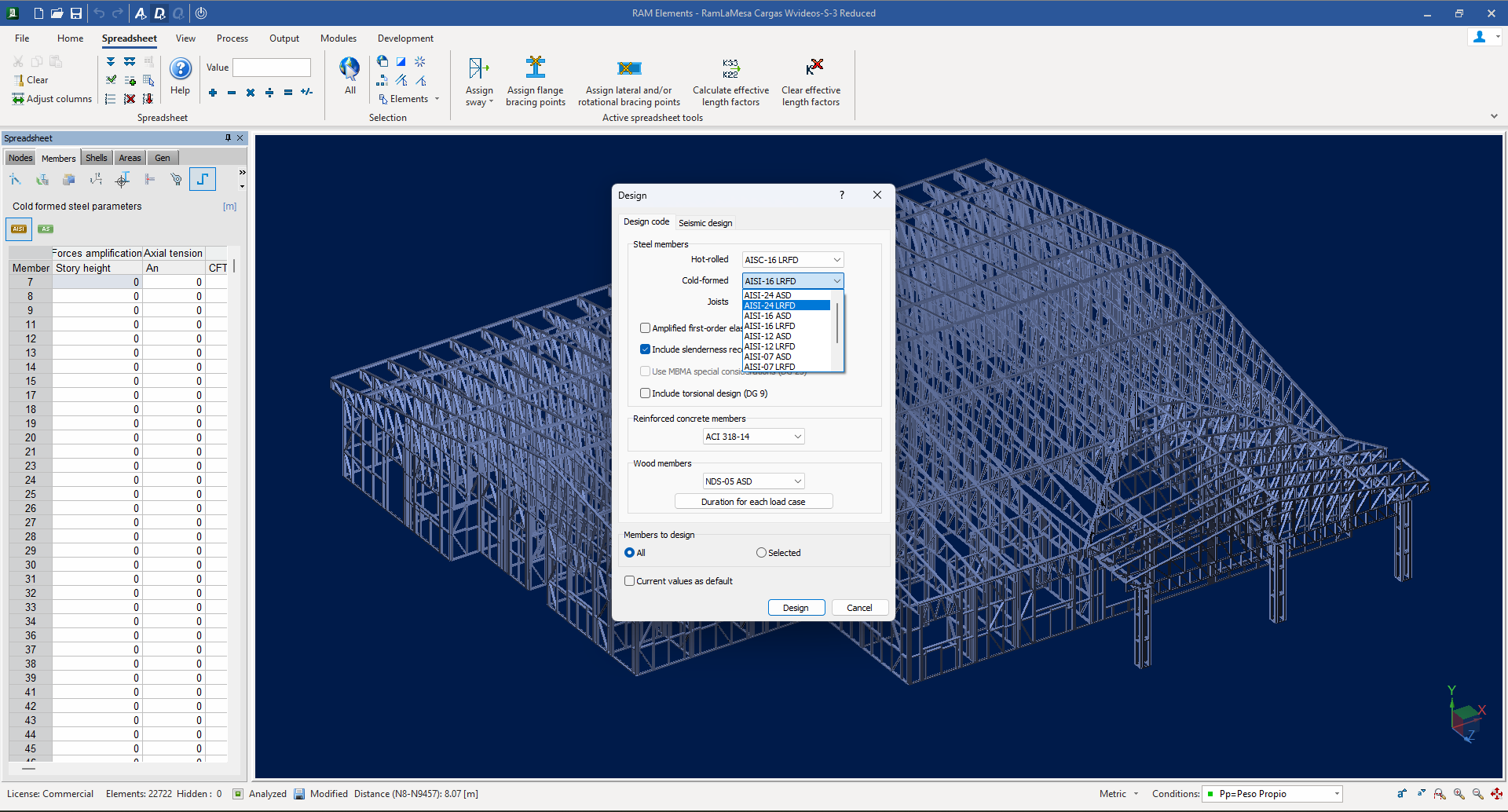

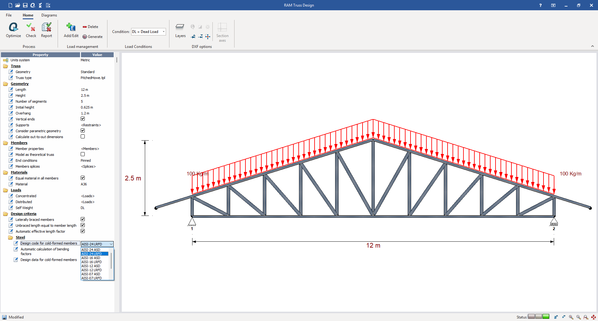

2. Update AISI S100-2024 Cold-Formed Steel Design. RAM Elements now supports the AISI S100-2024 Specification for the Design of Cold-Formed Steel Structural Members, expanding the program’s alignment with the most current standards for cold-formed design.
Figure 4. Update AISI S100-2024 Steel Cold Formed member design.
This update also extends cold-formed steel design capabilities to the Beam Design and Truss Design modules.
Figure 5. Update AISI S100-2024 Steel Cold Formed member design in the Truss Design module.

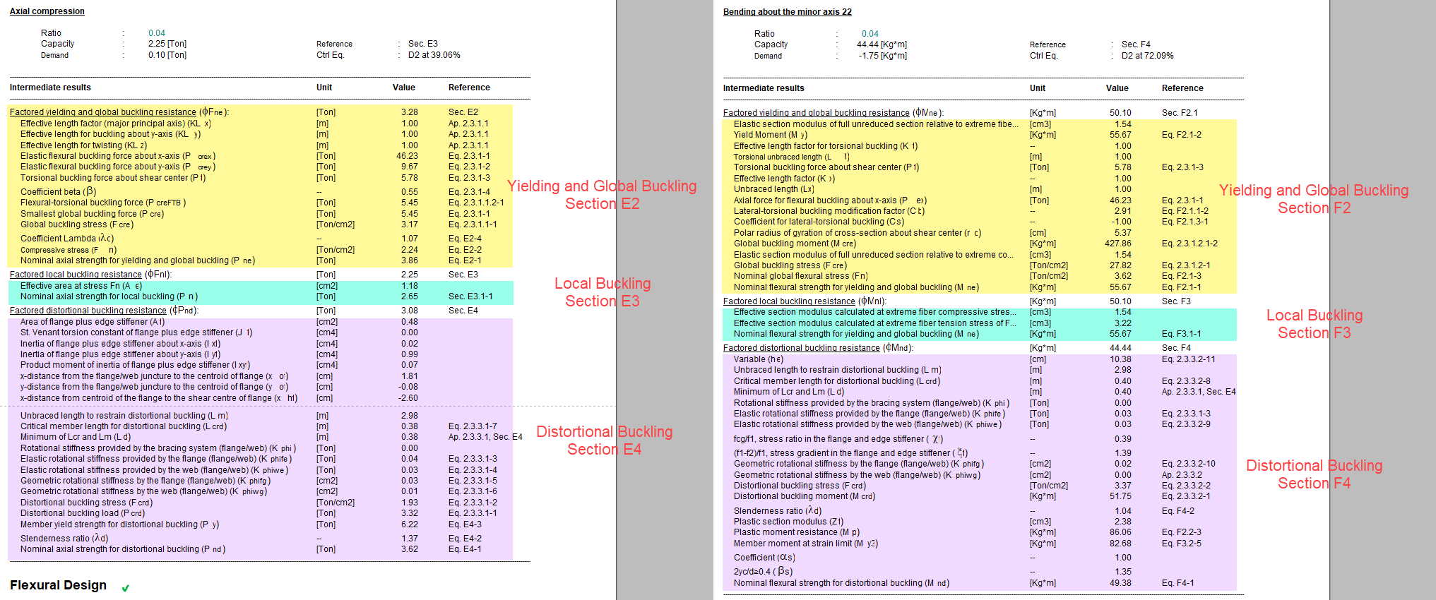

The implementation of AISI S100-2024 updates the cold-formed steel design framework to a force-based approach for flexural, torsional, and flexural-torsional buckling, replacing the previous stress-based method. The revision also introduces new equations for flexural-torsional buckling of asymmetric sections, improving the accuracy of stability checks for non-symmetric members.
Additional changes include new provisions for distortional buckling in flexure about the minor axis and revised equations for nominal distortional buckling strength, now based on the plastic moment instead of the elastic section modulus. The shear strength and reduction factor formulations were also updated, providing consistency with the new force-based design philosophy and reflecting a more unified treatment of strength across all limit states.
Figure 6. Enhanced report section showing intermediate results for compression and bending.

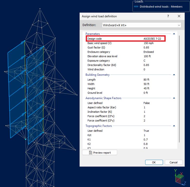

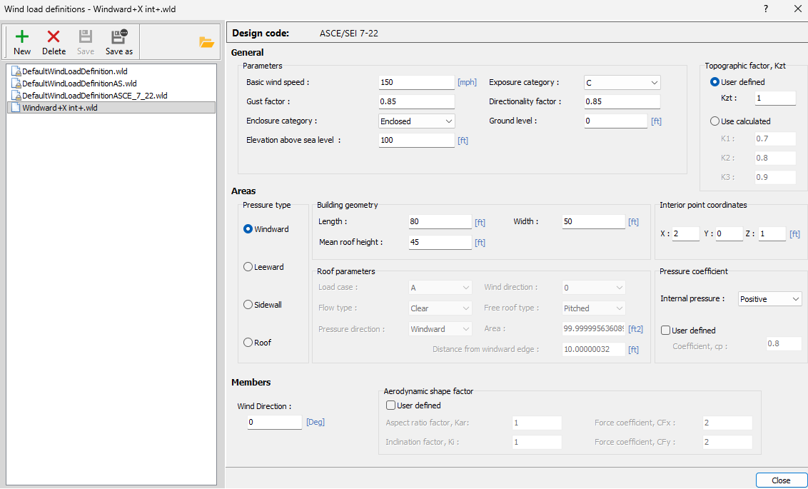

3. ASCE 7-22 Wind Load Definitions Generator. This release introduces an enhanced Wind Load Generator that now supports ASCE 7-22 definitions for wind loads. The Wind Load Definition dialog has been updated to allow users to select among different ASCE standards (ASCE 7-16, and ASCE 7-22), providing greater flexibility when defining parameters.
Figure 7. New ASCE 7-22 wind load definition
The implementation includes all required updates to generate wind loads on both areas and members incorporating revised pressure coefficients, exposure categories, etc. consistent with the ASCE 7-22 standard.
Figure 8. New ASCE 7-22 wind load generated over members.

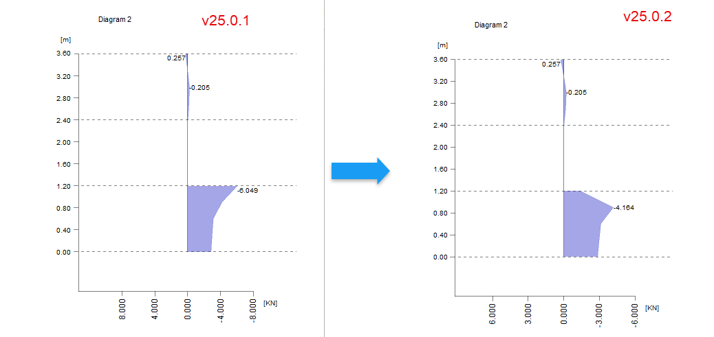

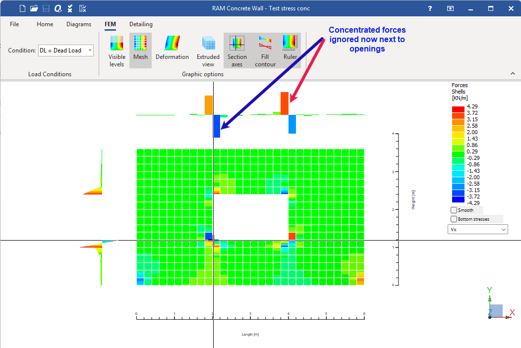

4. Wall Modules Distribution of Stress at Openings Enhancement. Following improvements to the force integration routine in the wall modules, certain models were exhibiting higher stress ratios near discontinuities such as openings. These peaks are caused by stress singularities that occur at sharp geometry transitions and are now more accurately captured by the refined integration scheme.
Figure 8. Concentrated forces near openings
To address this, the extreme FEM elements around openings are now intentionally skipped during the evaluation of out-of-plane shear. These edge elements often experience localized stiffness and mesh effects that do not represent the actual structural behavior. By excluding them, the results provide a smoother and more realistic shear distribution across the wall panel, minimizing noise and eliminating artificial stress concentrations near opening boundaries. The technique aligns with classic findings in computational mechanics on stress concentration (e.g. see Xie et al.)
Figure 9. Concentrated forces near openings fixed to prevent unreal higher stresses
This approach ensures that the reported forces better reflect the global behavior of the wall, while maintaining the improved numerical precision introduced by the updated integration method.

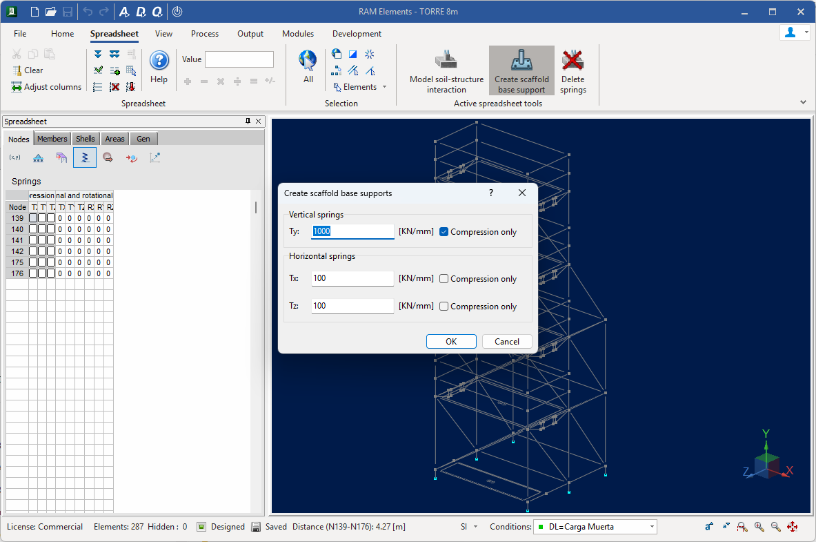

5. New Scaffold Base Support Tool: A new tool has been added for the analysis of temporary scaffolding structures. Scaffoldings are temporary systems supported directly on the floor. The new feature allows users to model this behavior accurately by defining compression-only base supports. This approach prevents unrealistic uplift reactions and provides a more realistic distribution of vertical forces under gravity and lateral loads.
Figure 10. New scaffold base supports tool to define base supports.
