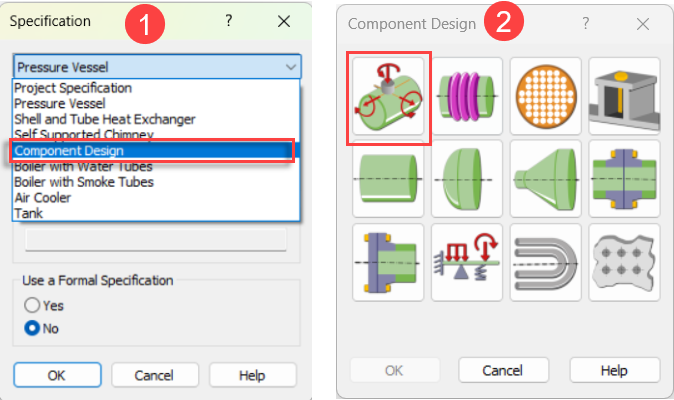

Currently, AutoPIPE Vessel (v46.00.00.165) does not account for nozzle external loads in roof thickness calculations. As an alternative, user can evaluate the stresses caused by external nozzle loads separately in component mode.
To do this, create a new file by navigating to File > New > Component Design > Local Loads, and then check the stresses.
