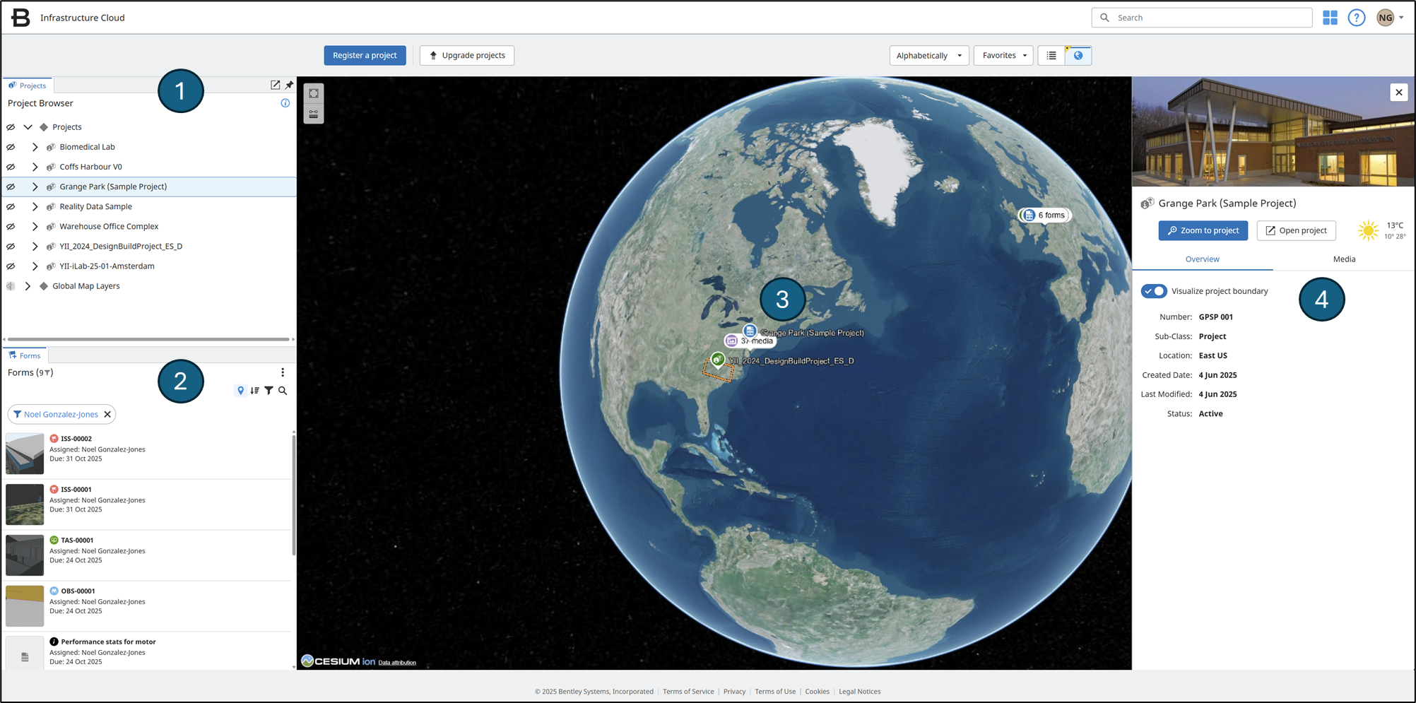

Standard Controls and Widgets
Both the Geospatial and Project Map viewers support the same controls interface. Below are a breakdown of those controls and their operation.
A screenshot of a computerAI-generated content may be incorrect.
  1. Project (iTwin) Browser – This tree allows user to visualize different contain that is geospatially contain within the selected Projects (iTwins). Support Data Types:
    1. iModel – 3D models of project, for example rail, road or building designs.
    2. Reality Data – Supports the OGC 3D tiles and OGC 3D Tiles Point Cloud reality data types.
    3. PlanSets – Drawings (Typically PDFs) that have been aligned and scaled to a geolocated and draped on the terrain base layer.
    4. Global Map Layers:
      1. Cesium World Terrain - A high-resolution, global 3D terrain dataset that provides accurate elevation data for visualizing landscapes and topography in real time.
      2. Cesium OSM Buildings - A worldwide layer of 3D buildings derived from OpenStreetMap, offering lightweight, realistic urban context for geospatial applications.
      3. Google Photorealistic 3D Tiles - A richly detailed 3D layer of cities and landscapes with photorealistic textures, streamed from Google’s geospatial data for immersive visualization.
    5. WMS (Web Map Services) Coming soon.
    6. Indexed Media – Coming soon while the markers are supported in the 3D world view toggle the markers will be added to the Browser tree.
  2. Forms Tab - allows users to view and respond task workflows in a structured data entries like; issues, RFIs, and tasks linked to specific model elements for contextual collaboration and tracking.
    1. Support Dockable widget controls.
    2. Auto filter to the forms currently assigned to the user.
    3. Toggle control for form markers.
    4. Filter, sorting, and search control supported.
    5. Note: The creation of forms is disabled in the Geospatial Viewer where content from multiple Projects/Assets is displayed.
  3. The 3D World View in a Cesium.ion + iTwin.js integration enables users to visualize infrastructure design models within a realistic geospatial context by combining engineering data from iTwin with global terrain, buildings, and photorealistic tiles from Cesium.ion.
    1. Pins/Markers – Represents individual points of interest placed on the 3D World View, using a standardised pin design for different marker/pin types. Pins display information when hovered over which includes metadata and thumbnails. Clicking will open specific tools for the object type workflows.
    2. Clusters – Groups multiple nearby pins/markers into a single visual marker to reduce clutter and improve performance, automatically expanding to show individual pins as the user zooms in. Clusters display information when hovered over which includes metadata and thumbnails in a scrollable list view. Click on individual items in the cluster menu to enable that object types of workflows.
  4. Info Panel – Displays information of selected object from the Project browser, Forms Widget, or 3D World View pin or iModel element.

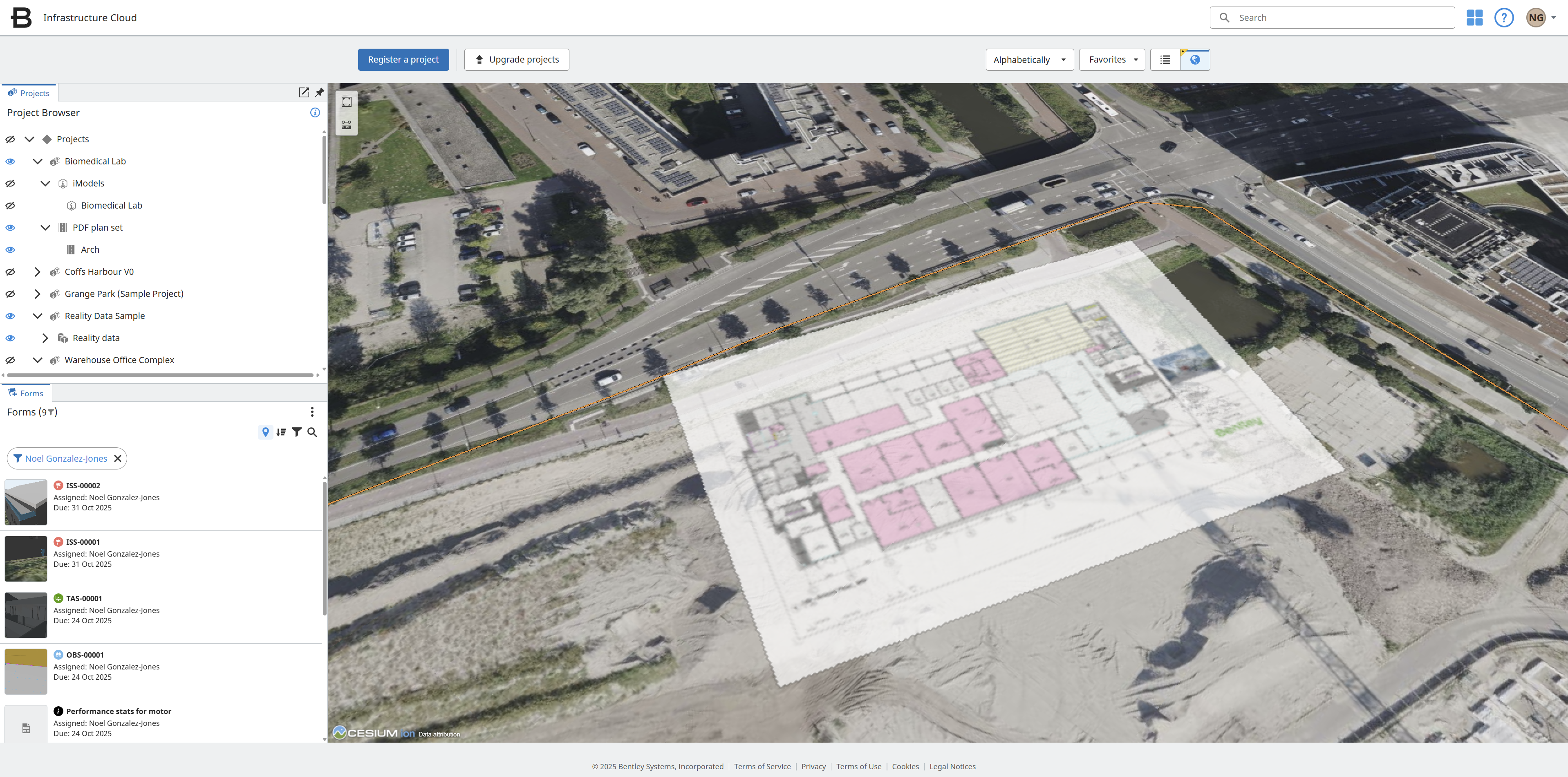

A computer screen shot of a siteAI-generated content may be incorrect.
Screenshot above shows an example of a PDF PlanSet Geolocated on the terrain

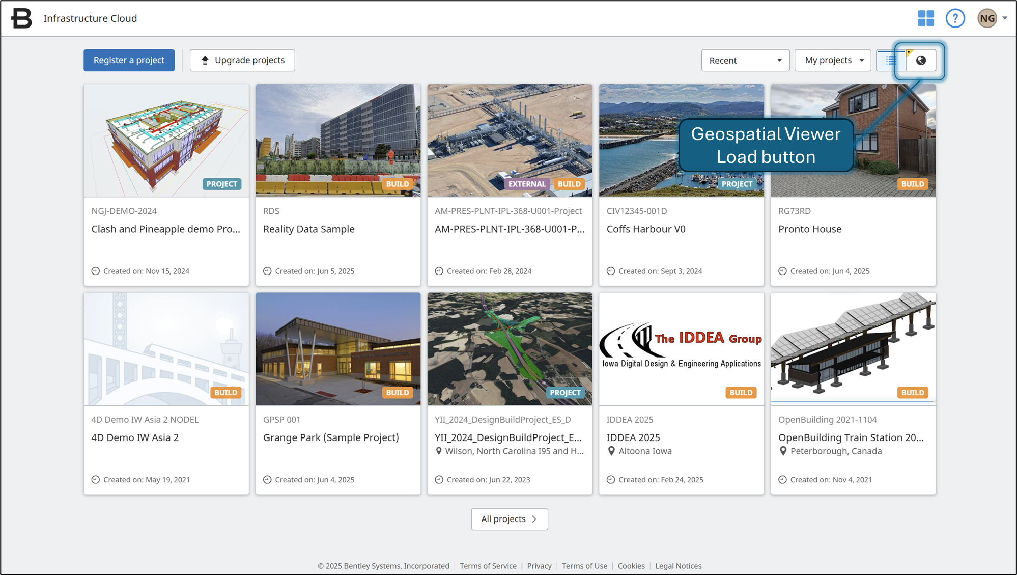

Geospatial Viewer is accessible by the Map icon in the Infrastructure Cloud landing page and will load the projects that are being displayed on the landing page, either 'My projects' or 'Favorites'.
Screenshot above shows the entry point the Multiple Project Geospatial Viewer

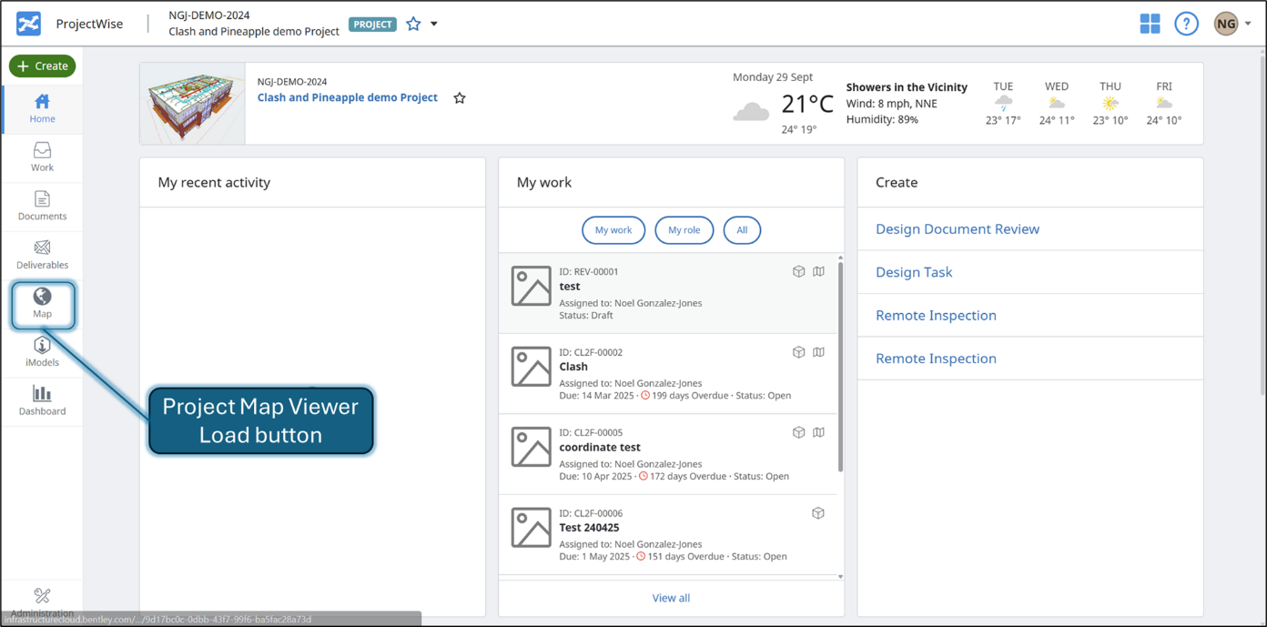

The Project Map Viewer is accessed from within the project landing page using the side navigation bar. This view will only display information you have access to from that project.
Screenshot above shows the entry point the Single Project Map Viewer

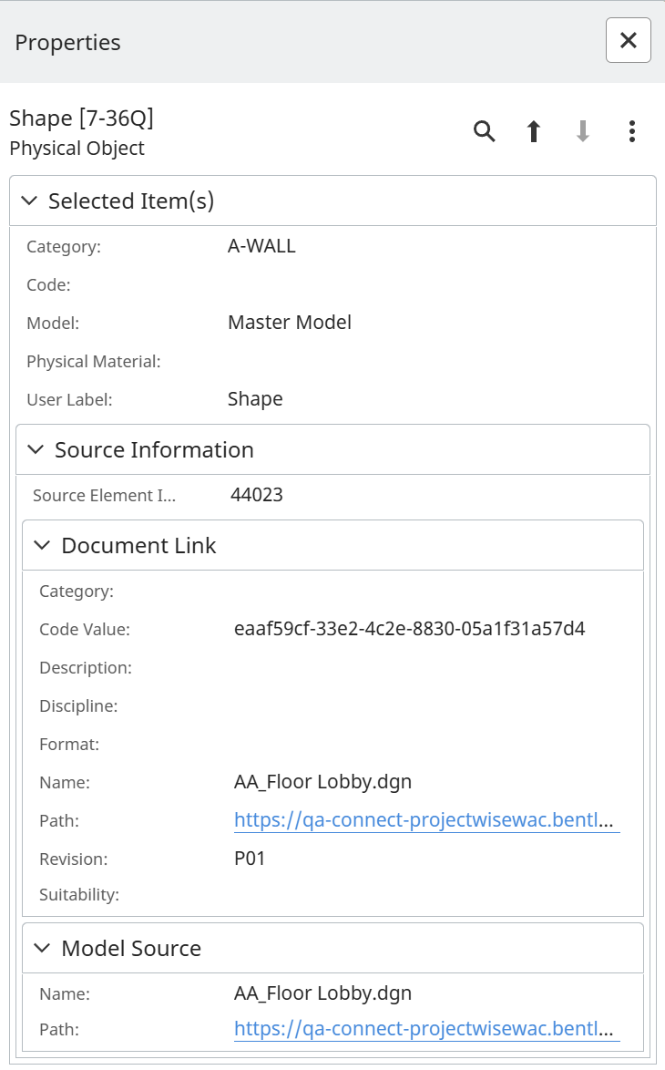

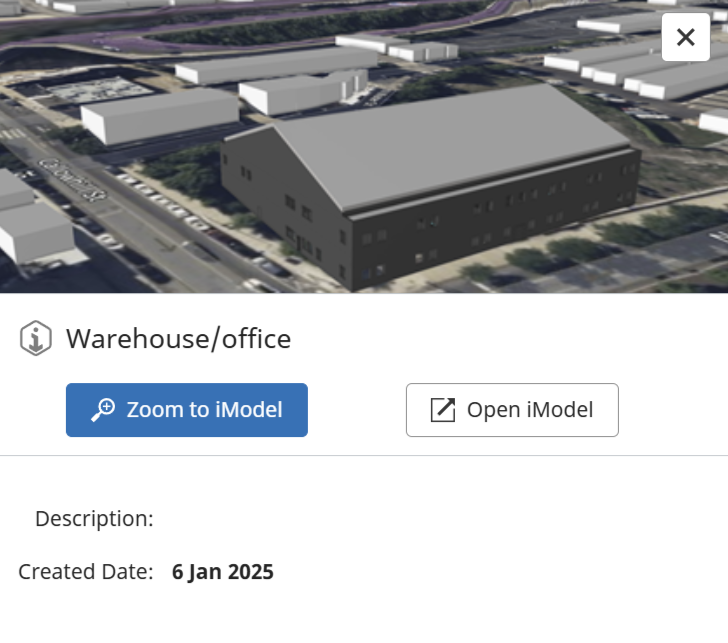

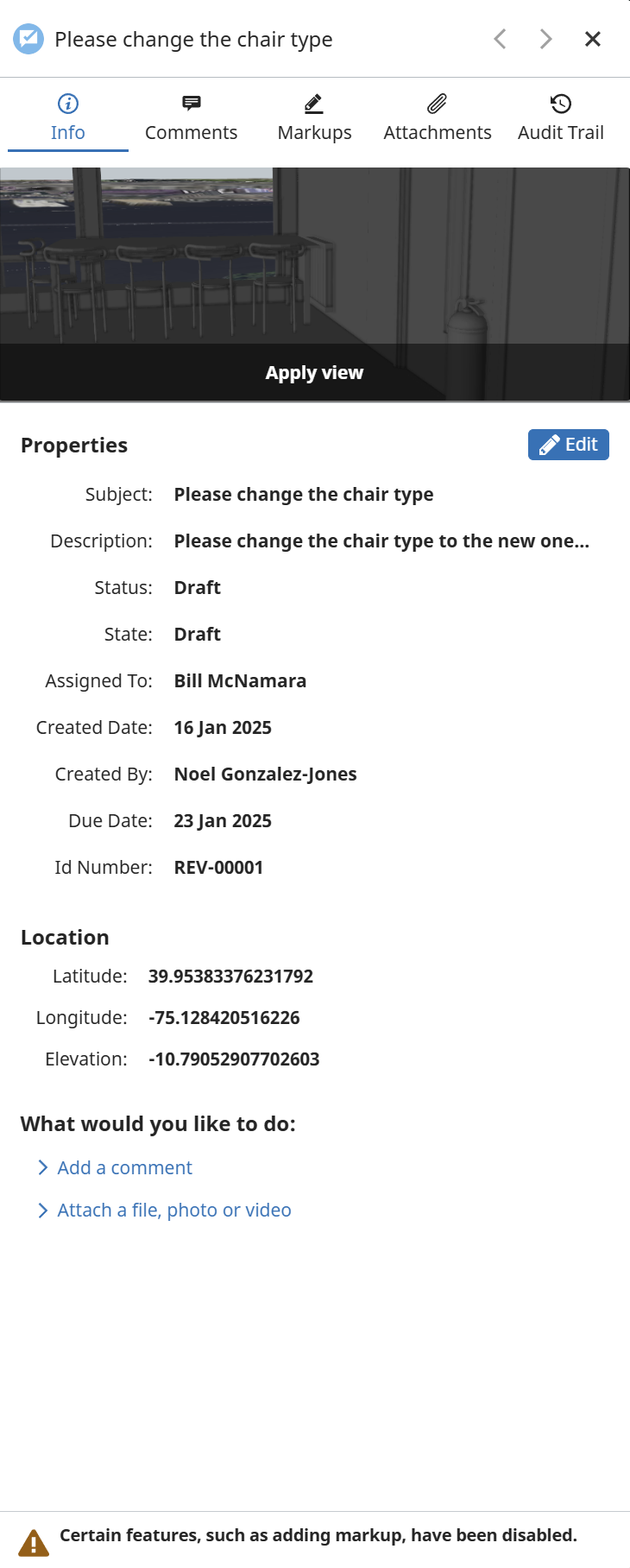

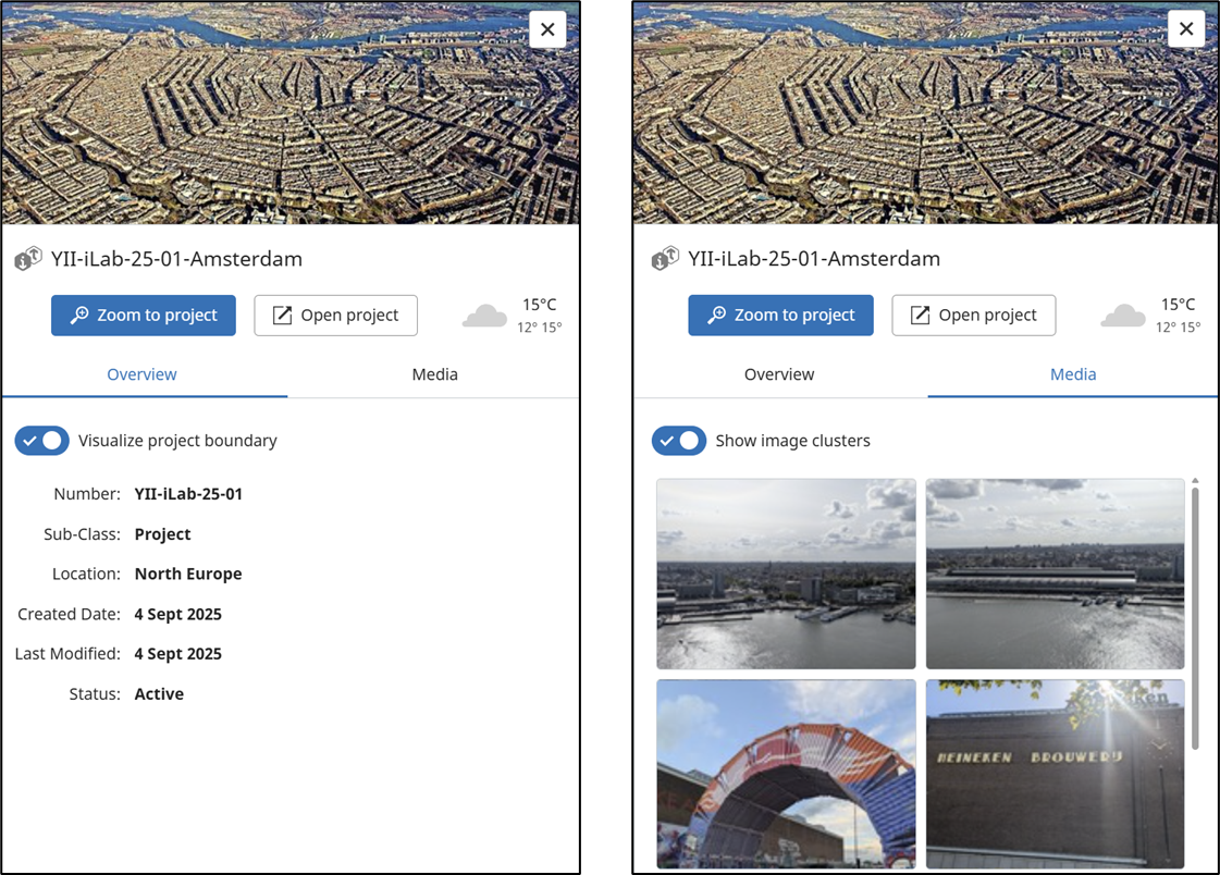

Righthand Info Panel
The layout of both the Geospatial and Project Map viewers uses the concept of displaying object or element properties on the righthand side popout information panels. The info panels look similar but display different information depending on the object selected.
Info Panel Types and functions
Screens screenshot of a screenshot of a videoAI-generated content may be incorrect.
Above are examples of the Project info panel and how the data is displayed in the different tabs

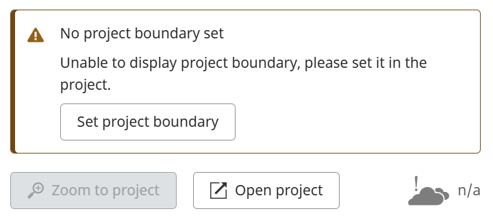

[Note: if the project boundary is not set an error message will be displayed (as shown below) with a link to the setting page for the project to set the project boundary. It will also disable the "Zoom to project" control and be unable to display the current weather until the boundary is set.]
A screenshot of a web pageAI-generated content may be incorrect.

  1. What happens if the project boundary is not set?
The viewer will display an error and disable:
