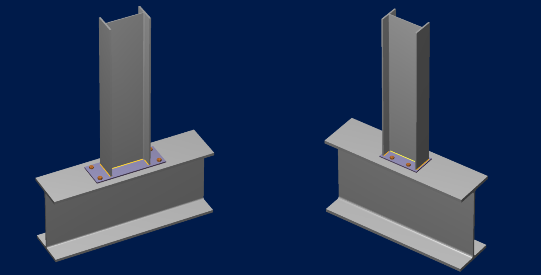

1. New column/beam post connection for AISC. This release introduces a new Column/Beam Post Connection for joints where a column base is connected on top of a beam using a bolted plate, in compliance with the AISC 360 design standard.
Figure 1. New Moment End Plate column post connection
This configuration addresses design scenarios without column continuity, such as dunnage-type frames on roofs, where the column terminates on top of a supporting beam instead of extending continuously below. The new connection type models the load transfer from the column into the beam through a bolted plate, considering shear, axial, and flexural effects.

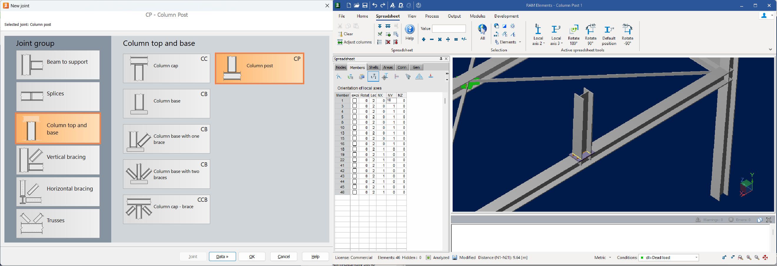

A new joint type, Column Post, has been added to facilitate this configuration in both RAM Connection Standalone and integrations with RAM Elements, RAM Structural System, and STAAD.Pro.
Figure 2. New column/beam post joint in RAM Connection and RAM Elements

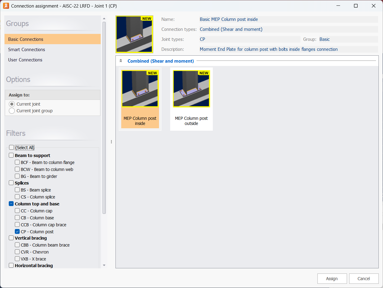

To streamline common use cases, two predefined assign buttons have been included with bolts placed inside and outside the column section in the Connection assigment dialog which represent the most typical field configurations.
Figure 3. New MEP column post assignment buttons

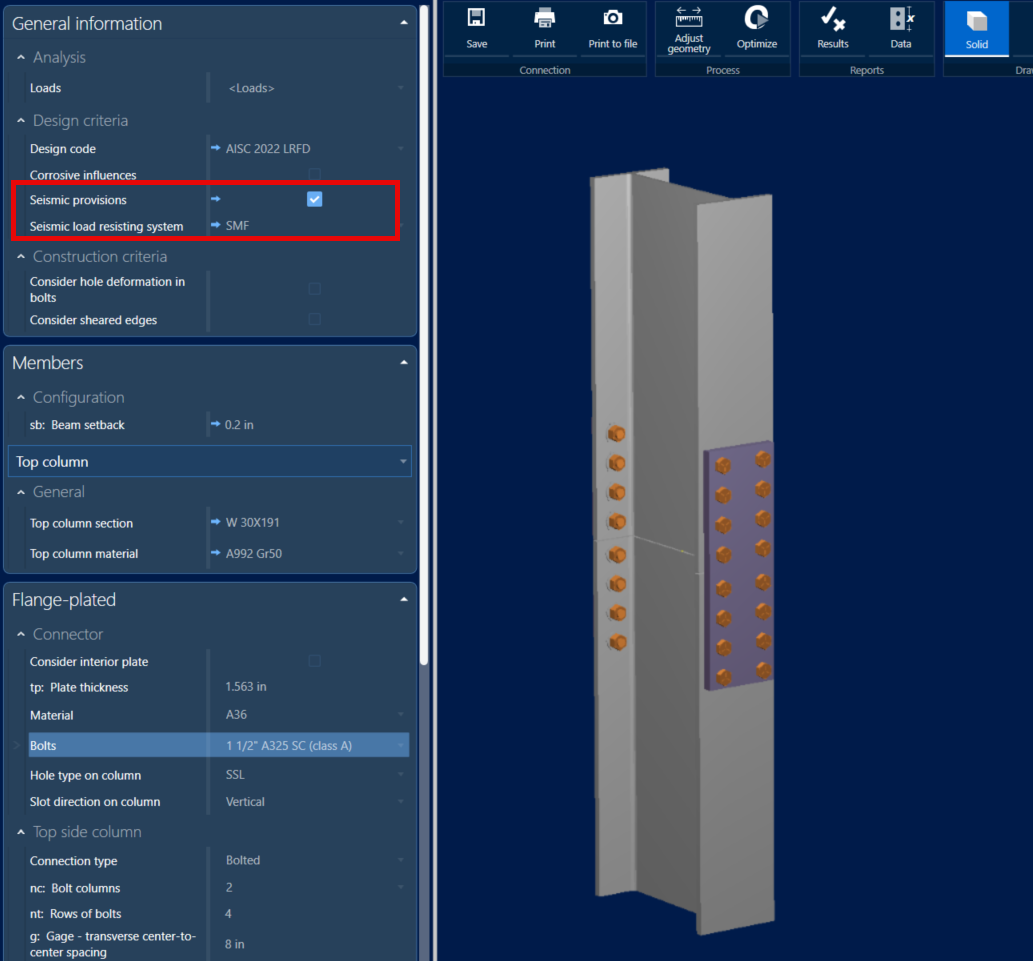

3. Column Splice Flange Plate Connection with AISC 341 Seismic Provisions. This release introduces enhanced Column Splice Flange Plate Connections that incorporate the seismic design provisions of AISC 341, expanding the program’s capabilities for designing lateral force-resisting systems in high seismic regions. The new implementation integrates the specific detailing and strength requirements defined in AISC 341, Chapter D2, ensuring that splice designs meet the stringent ductility and overstrength criteria necessary for seismic performance.
Figure 5. Seismic provisions options for the Column Splice Flange Plate connection in AISC.

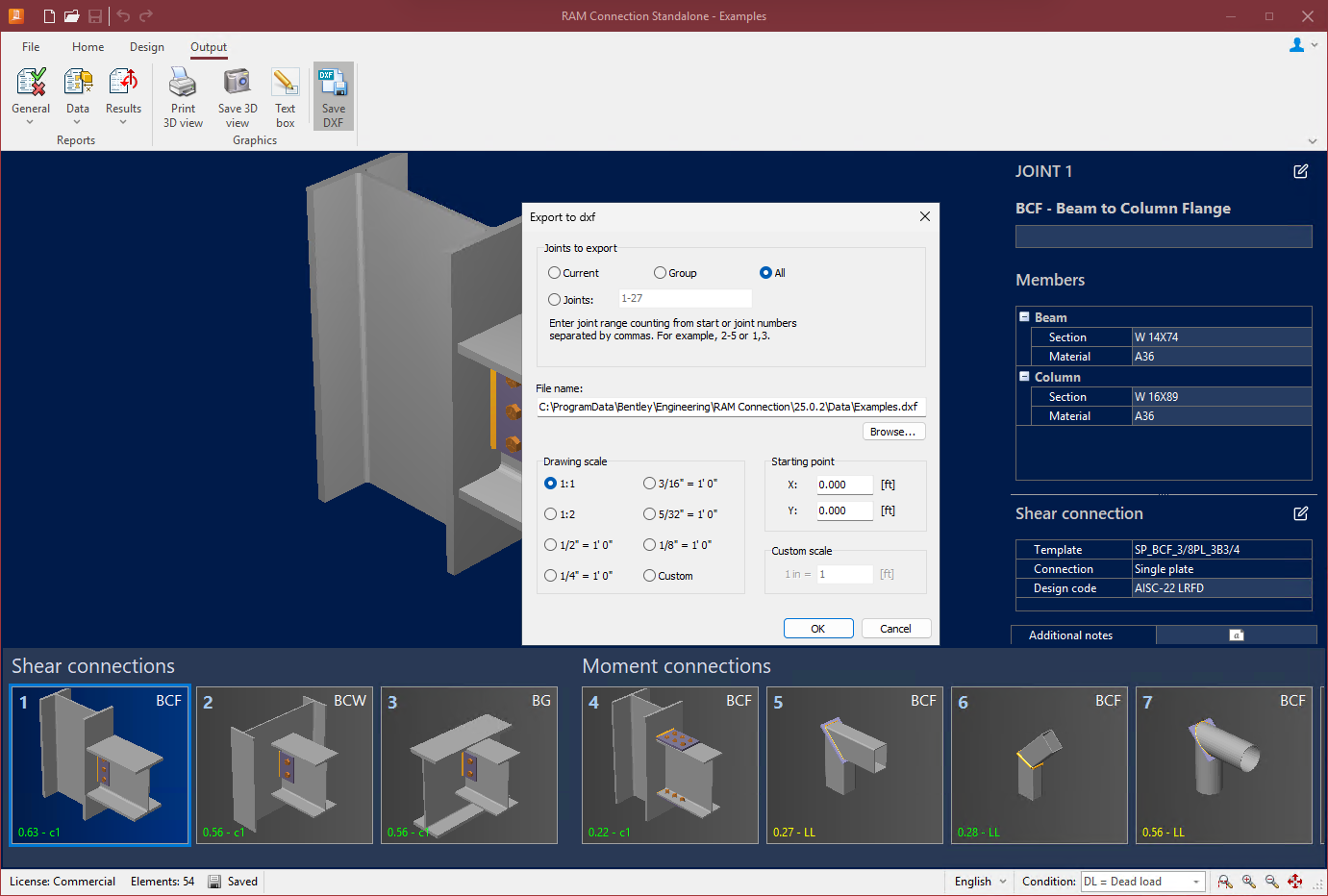

4. DXF Enhancements – Export All Connections from Joints into a Single File. This release introduces a new capability to export all connection DXF drawings from an entire model, a single joint, or a group of joints into a single DXF file. Previously, DXF files could only be exported one connection at a time, requiring multiple operations to consolidate all drawings. With this enhancement, engineers can now generate a comprehensive DXF file containing all selected connection views in one step.
The new tool is located in the Output tab in the Graphics group as Save DXF. The tool, similar to other output options, has the option to save the DXF of a Joint, a group of joints or the entire model.
Figure 6. New options to export all connections from selected joints into a single DXF file.

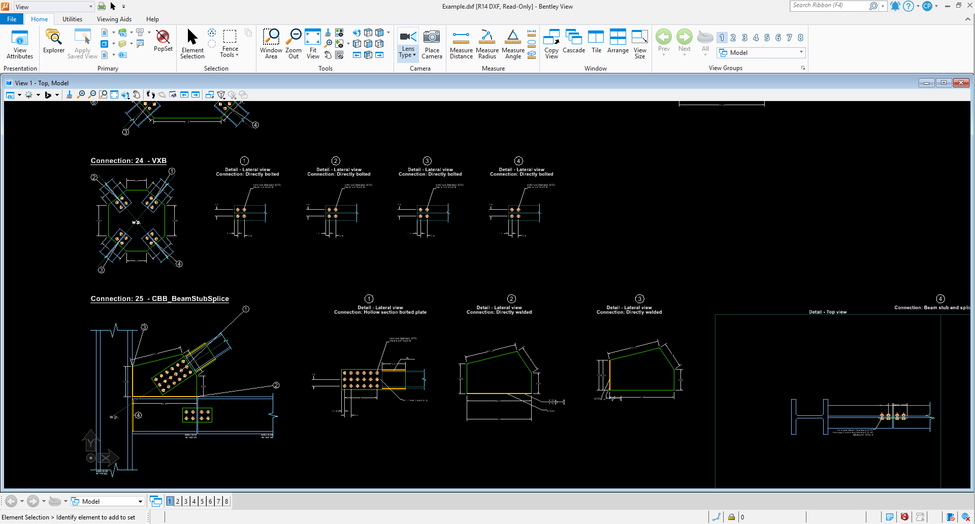

When multiple connections are included, the generated DXF organizes them view vertically, ensuring that drawings are arranged without overlap.
Figure 7. DXF with several connection ditails from model.
