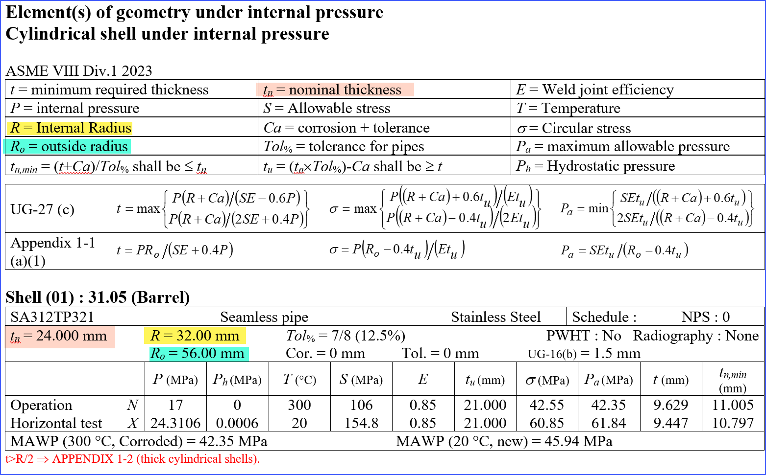

  2. Review output report - "Element(s) of geometry under internal pressure> Cylindrical shell under internal pressure> Shell (01) : 31.05 (Barrel)"

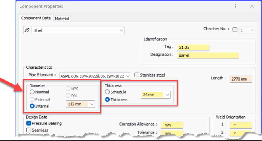

  3. Review Model data for the referenced component (ex. 31.05)

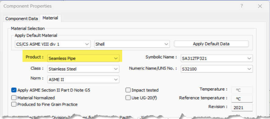

  4. Material Tab:
The development team determined the root cause was inconsistent user data, signaled by warning message 985 (The diameter type is not compatible with a Standard Pipe, this can lead to unexpected behavior). This is the most important message in fact.
Since the code standard does not have any pipe with an internal diameter of 112 mm and a thickness of 24 mm, this also generates another message 1033 (No matching thickness / schedule found).
Since a Pipe is always defined by either a nominal diameter or an external diameter, the calculation was performed considering 112 mm as the outer diameter (Report).
However, when combined with a thickness of 24 mm, the thickness clause in appendix 1-2 applies (side effect).
If the user does not want to enter a nominal diameter but wants to keep a "Seamless Pipe" material, the program will manage to do the verification with the correct dimensions, but it will not be able to determine the schedule. The best solution is to input the nominal diameter for a Pipe.
