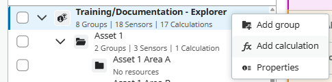

Adding a calculation
There are a number of ways to add a calculation

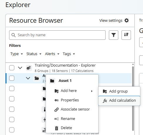

Right click on a Group - puts the calculation into the selected group

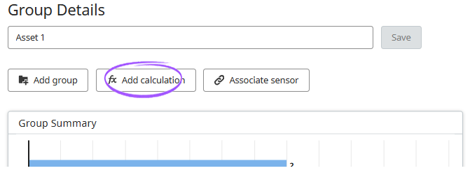

From “Group Details” – this will store the calculation within the selected group

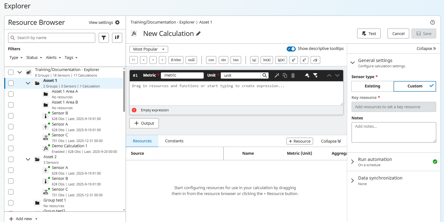

When a calculation has been added the “Calculation Designer” will load on the right-hand side of the page which will look as follows…
A screenshot of a computerAI-generated content may be incorrect.
General Settings
The general settings are located in a stacking panel on the right-hand side of the calculation designer…
It is mandatory for users to specify a sensor type for their calculation – the default is “Custom”. The key resource is for information only (modified in the Resource tab) and the Notes section will allow users to document and explain the purpose of the calculation if they so wish (optional).
When selecting a Sensor type a “Custom” selection will create the calculated sensor as a “Generic” sensor type, allowing users to create metrics and units as they wish.
An “Existing” selection will allow the users to choose the sensor the wish to create the calculation as from the drop-down list. This option will provide the metrics, units and configuration from the chosen sensor type – this definition needs adhered to when building the calculation.

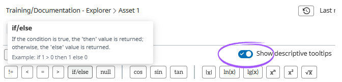

When the “Show descriptive tooltips” is turned on – upon hovering any toolbar button users will be given informative tooltips detailing the purpose of each function..

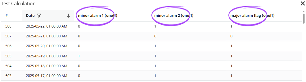

Test
The test feature allows a user to run a calculation and generate results which will be displayed on screen – but importantly, not stored to the calculation sensor. These results are no longer available when the modal is closed, no observations will be stored against the calculation.
The test feature is located at the top of the Calculation Designer page…
As indicated in the information message before a test takes place, tests are limited to a maximum of 50,000 observations – this is to maintain performance of the application. If you are performing historical aggregations with large data sets, the observations generated may differ slightly.
A close up of black textAI-generated content may be incorrect.
If a calculation has an error the modal will display an error highlighting the calculation cannot be tested at this time…
A white background with black textAI-generated content may be incorrect.
When a valid calculation is run the calculation results will be displayed in the modal with all available metrics as columns in the table…
A screenshot of a calculatorAI-generated content may be incorrect.

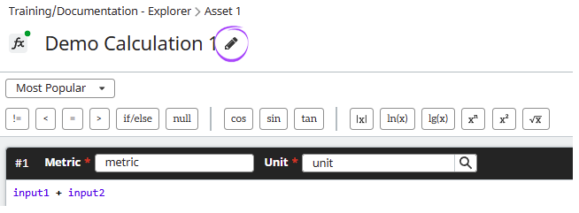

Calculation Name
When creating a new calculation the calculation is given a name by default – “New Calculation”, this can be retained but it is suggested that the calculation is given a more descriptive name.
To do this simply click on the calculation name itself at the top of the page or click on the edit button alongside it, see below…
Clicking on this will open a modal dialog for renaming the calculation – simply give the calculation a name and click “Done” to save the name.
There is a 45-character limit on calculation names.

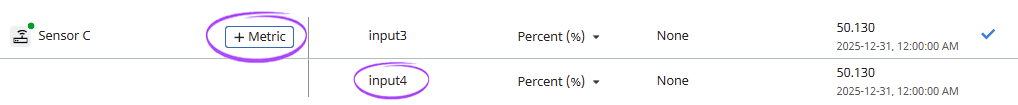

Whenever key resource has a new observation
This option will generate timestamps which match the key resource of the calculation. On initial save all historical calculations will be performed and the timestamps for these calculations will match timestamps of the key resource.
Any new/future calculations will not take place until the key resource – something all calculations have – receives a new observation. When this is received the calculation will trigger and the timestamp for the calculated result will match that of the observation received.
To identify a key resource there is a key icon shown next to the chosen row in the “Resources” tab of the calculation…

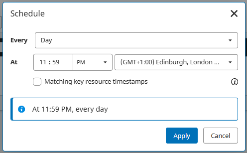

On a schedule
When run automation is enabled the default specification is “On a schedule”.
This means that the calculation will run on a predefined schedule. Any observation timestamps will match the schedule frequency – in this case daily at 11:59PM each day…
To modify the schedule simply click “Change schedule” as indicated below…
This will then present the user with a modal popup which will allow the user to specify the schedule frequency, from hourly all the way to monthly…
There is an override option within the schedule to “Match key resource timestamps” – when this is selected the calculation time stamps will revert to method used in option 1, but calculations will not be processed immediately – only when triggered by its associated schedule.

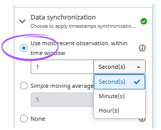

Data Synchronization
This feature provides users with the capability to apply smoothing techniques to observations – based on a selected period of time for that smoothing average.
This feature can be useful to remove outliers within the data, essentially applying a smoother average as opposed to what the raw data may return.
Data Synchronization is available for use in the following scenarios:
Multiple Resources are present (from different sensors, not multiple metrics from the same resource)
AND
"Whenever key resource has a new observation" OR "Match key resource timestamps" is enabled (when in schedule mode).
The configuration is not applicable for "On Schedule" by default currently because:
Each resource output is already "synchronized" or timestamp aligned with the Schedule (say, Every Day @ 12 AM).
Each resource takes its LAST "One" available observation by default (as it only needs to produce a single timestamped output).

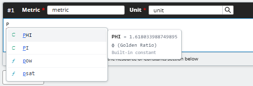

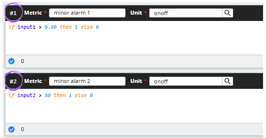

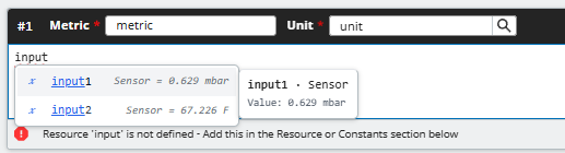

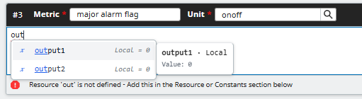

Calculation Expression(s)
The expression builder is the central element of the calculation designer - with all of the available tools and configuration surrounding it. This is where the calculation expression(s) is defined.
When initially loading the calculation designer for a new calculation you will be presented with the default display which includes one metric and “Custom” which will save this calculation as a generic sensor type, meaning the user can add a number of additional outputs.
There are several elements to the expression builder itself.
Metric
The metric section shown below allows a user to name the metric for the calculation being created.
In “Existing” mode these options will be disabled as the sensor has already been defined…
A black and white rectangle with black textAI-generated content may be incorrect.

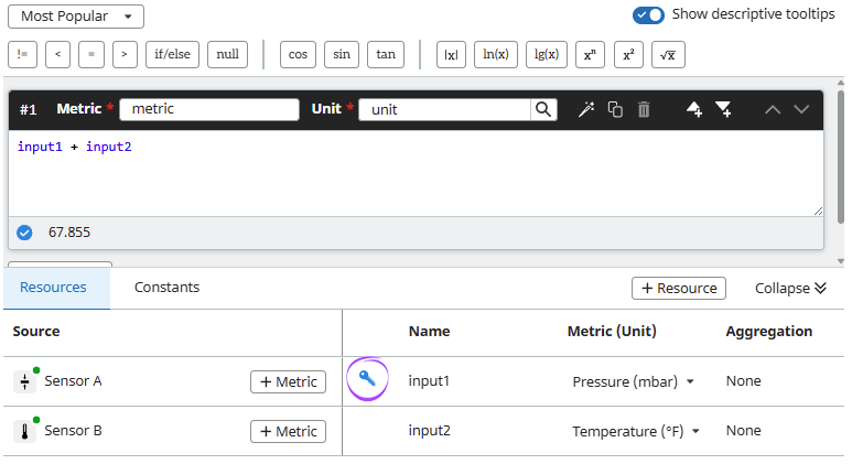

Validation/Result Status Panel
To indicate whether a calculation expression is valid there is a status panel below each expression, this will indicate the validity of the expression.
An example of an invalid expression (with suggestions on how to resolve)…
An example of a valid expression (last result of the calculation is displayed)…
A computer screen shot of a computerAI-generated content may be incorrect.

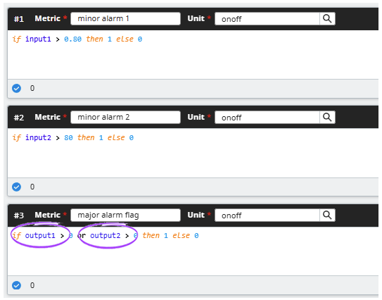

Additional Outputs
Calculations can have a number of metrics in the same way as sensors, however…
An additional capability when using calculations to generate metrics - you can use the result(s) of the first output to feed into the second etc. When you introduce boolean logic, aggregations and then alerts you could build up a single calculation which would give you a daily average for 2 different sensors – if this average was above x.xx you could set the value to 1 and place an alert on this to inform users there is an issue with a specific asset. An example is shown below…
The averages for input 1 and input 2 would be specified in the metric drop down within the resources panel. You can see in the example above we are able to reference the output values for both output 1 and 2 in output3.
All 3 of these outputs would then be generated as metric values when the calculation is executed…
Outputs are numbered as you can see below…
IntelliSense
Each output is equipped with IntelliSense to help users quickly construct their calculation expression reducing the chance of errors in the process.
IntelliSense will auto suggest useful functions, constants, inputs and outputs available for use in the current expression. Simply start typing and suggested offerings will appear as shown below in a few examples…
IntelliSense example - Sensors…
IntelliSense example – Constants & Functions
IntelliSense example - Outputs
Clicking or pressing enter or tab will place the selected row into the expression.

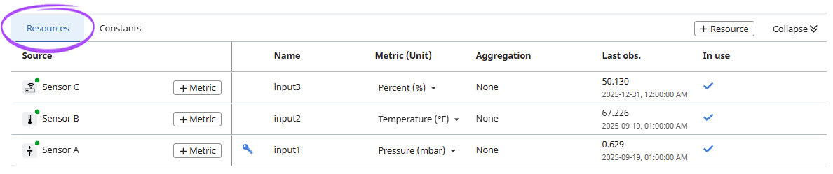

Resources Tab
The resources tab allows users to identify sensors used in expressions within a calculation, view details about those sensors and specify aggregations to use for the chosen metrics where applicable.
The resources tab will look similar to the example shown below…
The “+Metric” button enables users to add additional metrics for specific sensors if the default metric is not the desired option for use in the calculation expression.
Resources can be added to the table in 3 ways
  1. Dragging a sensor directly into the resource table from the Resource Browser (tree).
  2. Dragging a sensor directly into an expression (automatically added to the resources table).
  3. Using the entity picker to select a sensor using the button located to the right of the resources panel shown below…
A purple circle with text in itAI-generated content may be incorrect.
Some notable columns in the resources panel include both “Last Obs.” and “In Use”…
The “Last Obs.” column displays both the date and value of the last observation recorded against this sensor/metric.
The “In Use” column shows a blue tick  when this metric is in use within an expression.
To remove a metric from the resources table users can hover over the metric – at this point there are 2 options. Clicking the item highlighted below will remove the metric from the resources table.
Clicking the 2nd item when hovered will enable users to quickly add sensors to an expression where the cursor is currently located…

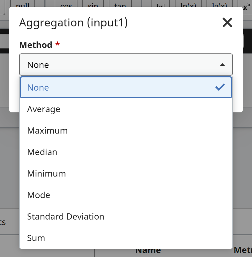

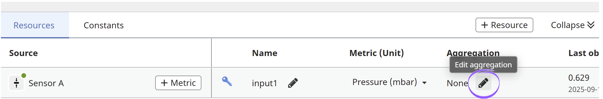

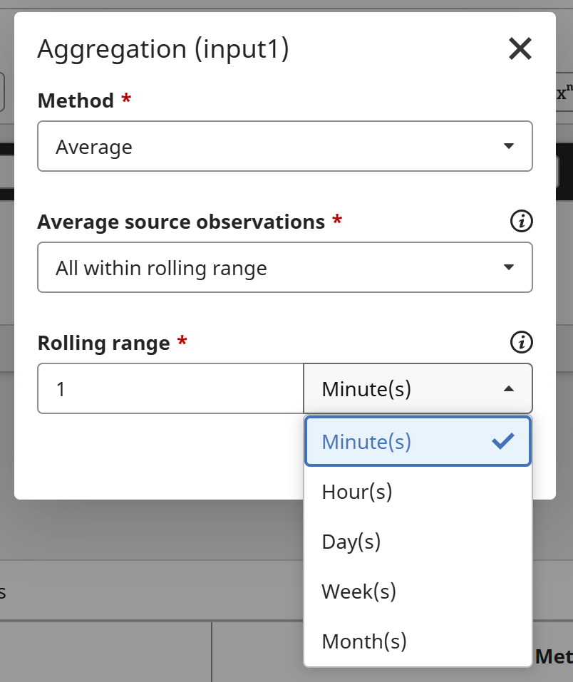

Aggregations can be applied by clicking on the “Edit aggregation” of a metric…
When clicked users will be presented with a modal dialog where they can specify the aggregation method…
Depending upon the method selected they will be presented with further options – specifically related to the amount of observations to use for the aggregation or the period of time to base the aggregation on…

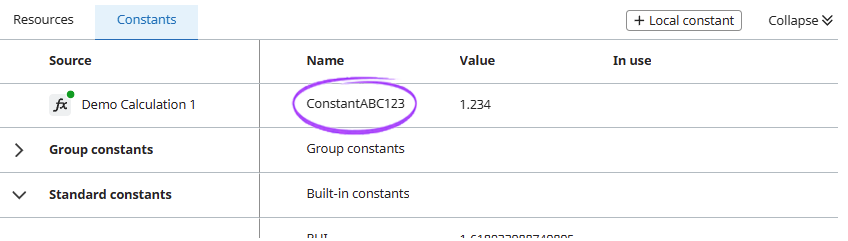

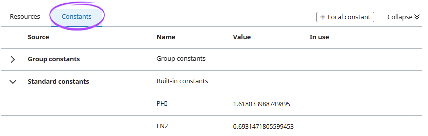

Constants Tab
The constants tab can be found next to the resources tab below the calculation expression designer.
What are constants?
A constant is a named variable with an associated value which can be used in calculation expression(s). The system comes with several preconfigured “Standard Constants” but any number can be added and created. iTwin IoT has the concept of local constants and group constants.

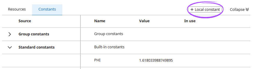

Local Constants
A local constant is a constant which is local to the calculation itself – it cannot be shared or used in any other calculations.
A local constant is created by clicking “+ Local Constant” as shown below...
This will then open a dialog as follows…
Clicking Save then results in…
This constant will be shown above the standard and group constant expandable sections, showing the source as the calculation currently being modified.
Note: Constant names CANNOT include spaces.

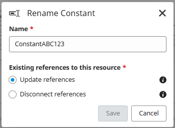

Renaming a local constant
To rename a constant click the pencil icon next to the existing name in the constants table…
This will open a modal dialog giving the user the option to alter the name of the constant and also choose whether this rename will update (maintain reference) to expressions using this constant, or disconnect them and remove any reference to this reference value – in most cases rendering calculation expressions invalid.
Update references – All existing references to this resource in the current calculation will be updated to reflect this new name.
Disconnect references - All existing references to this resource in the current calculation will be disconnected.

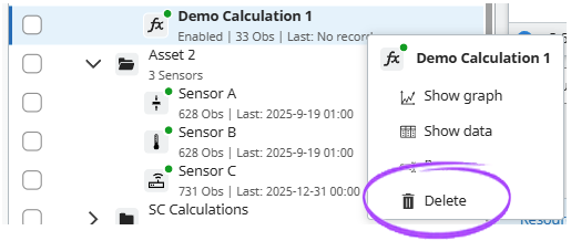

Delete
The delete option can be found in the navigation at the top part of the screen…
IMAGE COMING SOON…
Delete does exactly what you might expect, it will delete the calculation you are currently creating/modifying and anything related to it. To confirm, this delete action will delete the calculation, any sensor configuration associated to the calculated sensor and also any observations stored within the calculation.
Deleting a calculation is also accessible from the context menu in the tree – right clicking on a calculation will display the option below..
A confirmation dialog will appear before any deletion is committed...
