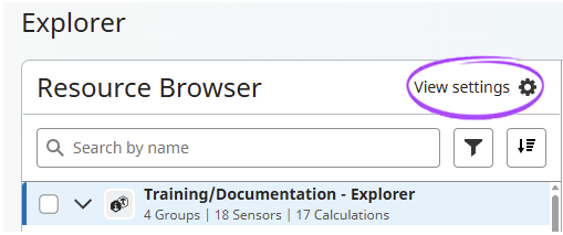

View Settings
View settings is an option which gives users the ability to alter the display of the tree. There are 2 modes the tree can be in – groups mode or connectivity mode and there is also an option to show additional information on each resource.
The view settings button is located above the tree next to the “Resource Browser” label.
When clicked users are presented with the following options

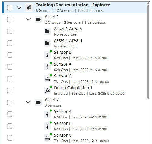

The default group display will look something like this

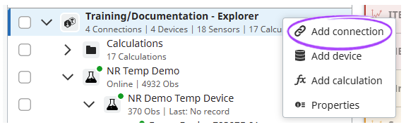

Add Connection
When in this mode users can add a new connection in the following ways..
A screenshot of a computer programAI-generated content may be incorrect.
A screenshot of a computerAI-generated content may be incorrect.

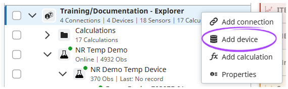

Add Device

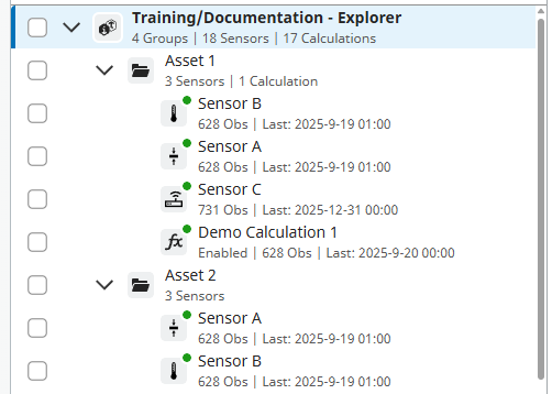

Resource details enabled in group mode

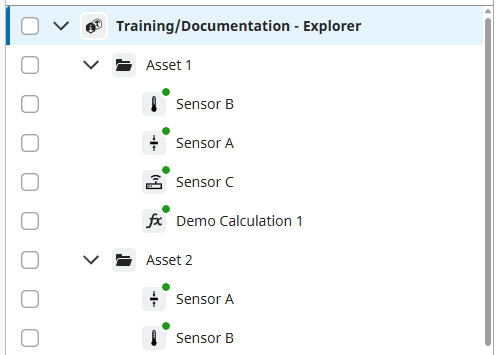

Resource details disabled in groups mode

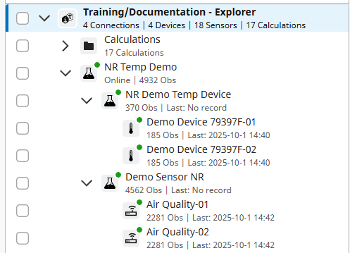

Resource details enabled in connections and devices mode

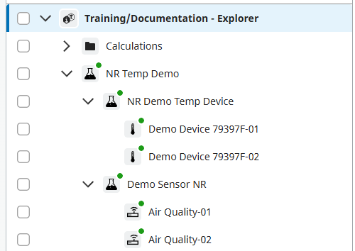

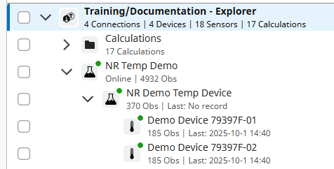

Show resource details disabled in connections and devices mode…

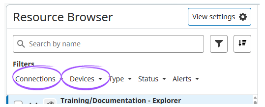

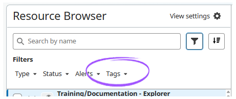

Connections and devices mode introduces filters for connections and devices but removes the ability to filter on tags given their association to groups which are not shown in this mode.
A screenshot of a browserAI-generated content may be incorrect.

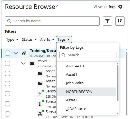

To apply a filter users should click on a drop down of their choice and then select an item from the list…
Users can also select multiple filters at once by clicking additional items in the drop down list…

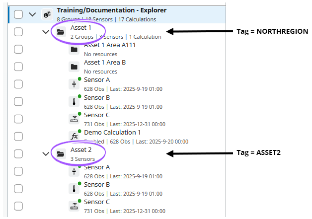

The results are displayed using OR filter logic. Using the above example, any group with a tag of “NORTHREGION” OR “Asset 2” would be returned as valid results…
Each filter will be applied to different entities, tags for instance will filter groups, alerts will apply filters to sensors.
The results of each filter will ALWAYS show the chain of groups back to the top level to maintain hierarchy visibility – groups may not be used as part of the filter but will be shown to identify the route to the matched sensor(s).

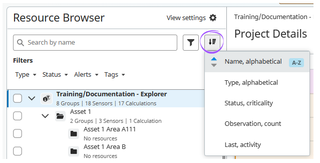

Sorting
Sorting is accessed using the button highlighted below…
This will give the user 5 options – Name, Type, Status, Observation and Last.
Name will sort the tree alphabetically from A-Z or Z-A as selected. This includes groups, sensors and calculations. It is important to note that the order of entities in the tree will always remain the same – groups, followed by sensors, followed by calculations – this order will not change during a sort action.
Type will sort sensors int their own sensor types and display them accordingly.
Status will sort sensors into their criticality (Lowest to Highest or Highest to Lowest as selected) and display them accordingly.
Observation will sort sensors and calculations into a sort order based on the count of observations stored within each.
Last will sort sensors and calculations into a sort order based on the last time tag of an observation stored within each.
