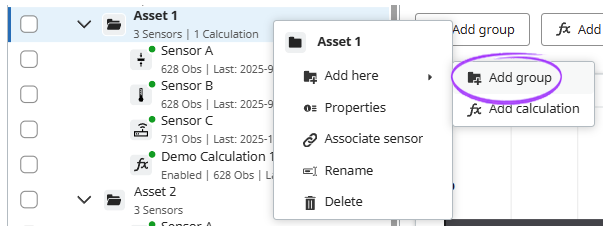

Right clicking on a group…
A screenshot of a calculatorAI-generated content may be incorrect.

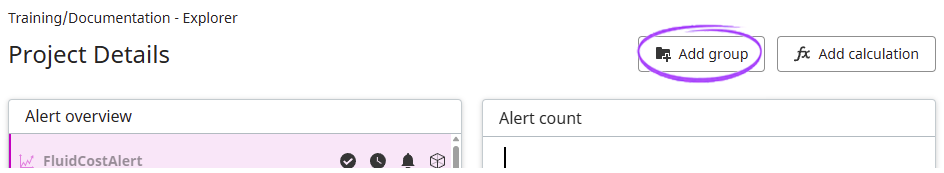

From the Project Details page…
A screenshot of a computerAI-generated content may be incorrect.

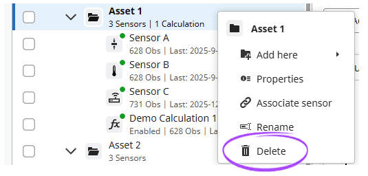

Deleting a group is possible in 2 ways – users can right click on a group in the tree and select “Delete”…
This will trigger a confirmation dialog…
A screenshot of a computer errorAI-generated content may be incorrect.
If Delete is clicked the group will be removed from the tree along with all sub-groups and calculations it contains. Any sensors will have their group association removed and appear under the project group in the tree. This action cannot be reversed.

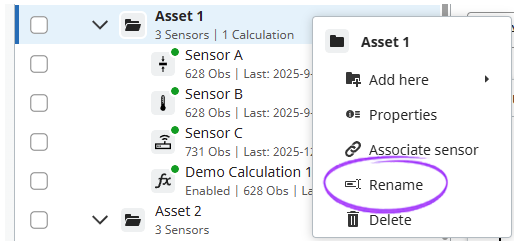

Renaming a group is possible in 2 ways – users can right click on a group in the tree and select “Rename”…
This will trigger a rename dialog as show below…
Clicking “Save” will rename the group with displays updated in both the tree and the group details page.

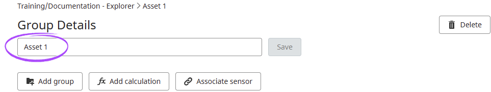

Renaming is also possible directly in the Group Details page…

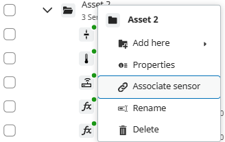

The alternative to drag and drop is to right click on any group and choose “Associate sensor”…
This will then open a dialog which may look familiar – the “Entity Picker” as shown below. This dialog is used in several features throughout iTwin IoT to select/identify sensors. Simply select the sensors you would like to associate or disassociate with your group – all associated sensors will display on the right hand in the “Selected Sensors” list. Clicking “Done” will confirm the sensor association.
