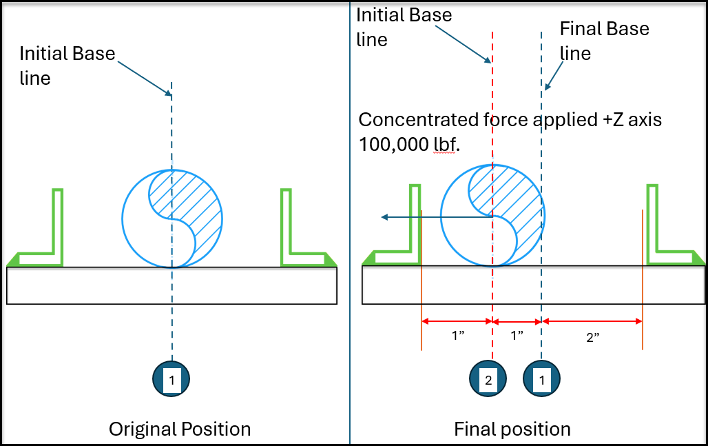

In AutoPIPE's Support Forces Report, why doesn't the local axis displacement match the global displacement?
For example, in Gravity (1), the global support deformation differs from the local deformation. However, the global and local forces are consistent.
To help clarify the concept of global and local support deformation as presented in the support report, we created five distinct scenarios using a cantilever pipe model. In each scenario, one end of the pipe is anchored while the other end features a guide support. We applied imposed displacements and concentrated forces at the guide with varying configurations to demonstrate how these inputs influence the reported deformation values.

Explanation:
Global Support Deformation:
The global support deformation in the Z direction is 1 inch. This is because the pipe has shifted 1 inch along the +Z axis due to the applied concentrated forces on the pipe.
Local Support Deformation:
As shown in the screenshot below, the pipe has experienced a 1-inch displacement caused by concentrated forces. When we consider the relative movement of the pipe from its original position, the total displacement is 1 inch.
Direction Interpretation:
To understand why the movement appears to be towards the right, imagine sitting on the pipe and looking downstream. From this perspective, the pipe has moved 1 inch to the right of the reference line, indicating a positive Z-direction displacement.

Explanation:
The global support deformation in the Z-direction is measured at 0.681 inches, which corresponds to the pipe's movement in the +Z axis due to the applied forces.
In the local support deformation, as shown in the screenshot below, the pipe has also shifted 0.681 inches due to concentrated forces. However, when considering the relative movement of the pipe from its initial position, the displacement is 0.319 inches.
To understand why the direction appears to be towards the left, imagine sitting on the pipe and looking downstream along the direction of flow. From that perspective, the pipe has shifted 0.319 inches to the left of the reference line.
