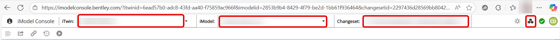

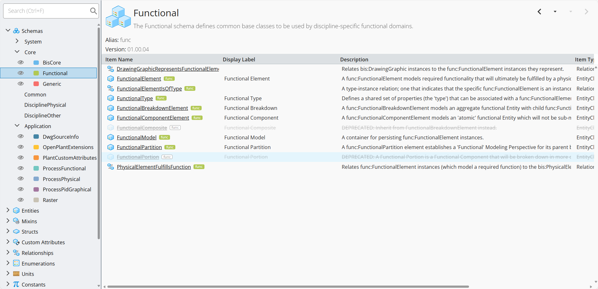

To review the schemas present in an iModel, you can use the iModel Console Composer. This tool allows you to select your iTwin, iModel, and specific change set to inspect the schema details.
  1. Navigate to: https://imodelconsole.bentley.com/
  2. Select your project (iTwin) to review.
  3. On the right-hand section, click "Schema Editor" to view the available schemas.
