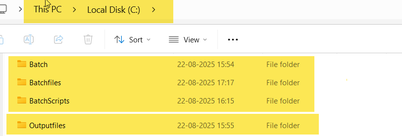

All folders (From ZIP file) to be placed in the C:\ drive directory.
1. Folder "Batch" - Contains the batch files used to initiate the processes.
2. Folder "BatchFiles" - Holds the DGN files that need to be processed.
3. Folder "BatchScripts" - Contains the script files that are used by the batch files.
4. Folder "OutputFiles" – Will store the converted DWG files after the process is initiated.

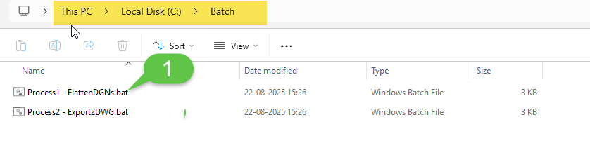

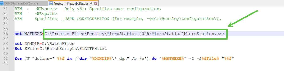

· Ensure the batch files are configured to run the MicroStation executable. The path must match the version installed on the user's machine.
If the executable path differs, update the FlattenDGNs.bat file accordingly.

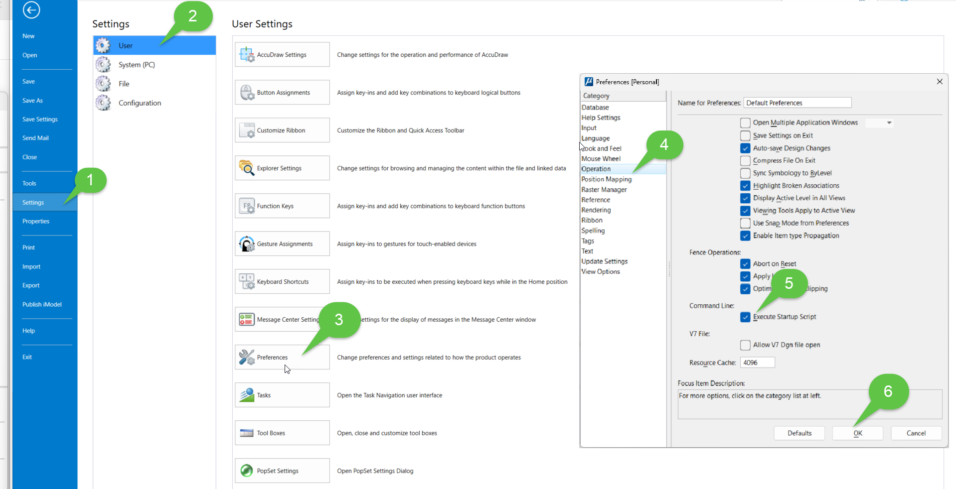

· Navigate to File > Settings > User > Preferences > Command Line and enable the 'Execute Startup Script' option.

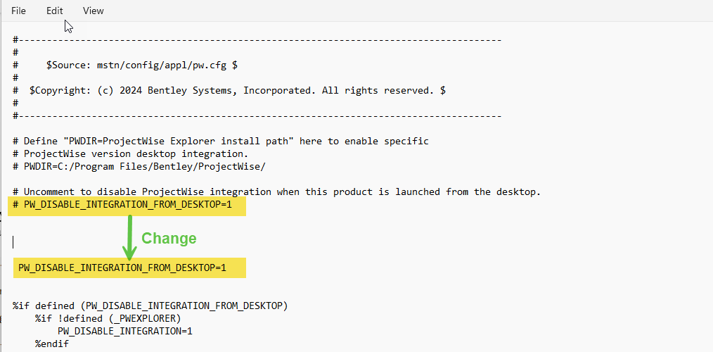

· Make sure you disable PW integration on the MicroStation.
you can make changes in file "PW.cfg" file from directory : C:\Program Files\Bentley\MicroStation 2025\MicroStation\config\appl
Note: If needed you can re-enable this configuration variable

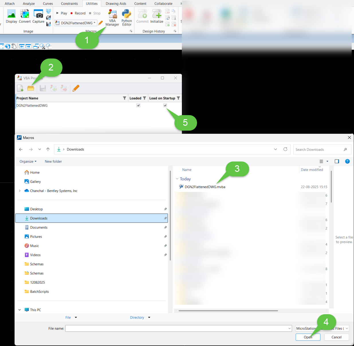

· Place the VBA file (.mvba extension) in the MicroStation configuration directory. Set it to 'Load on Startup' to ensure it runs automatically when files are opened.
Note: Keep the .mvba file in your MicroStation configuration directory.

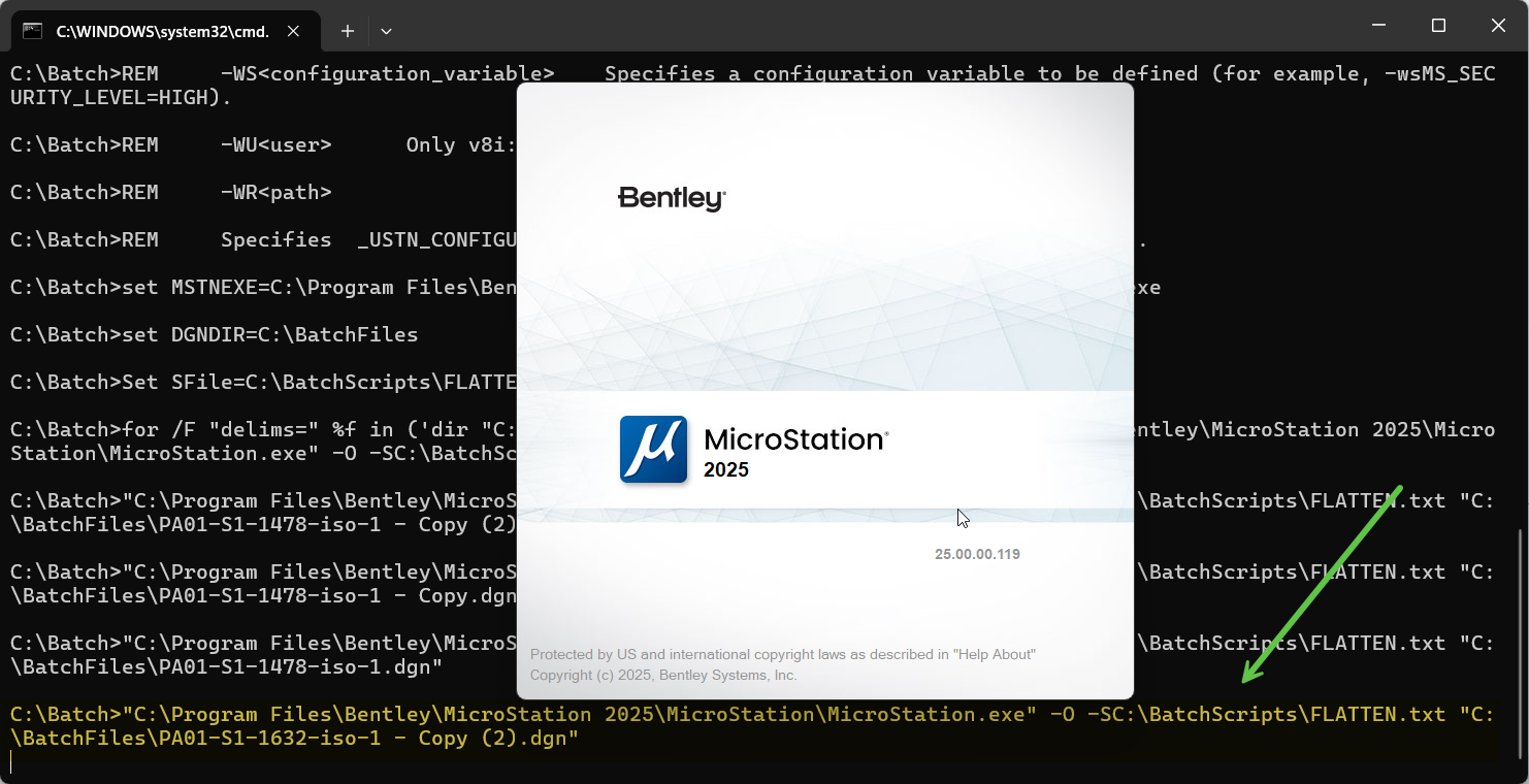

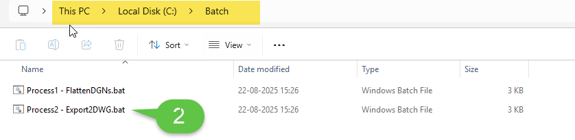

· Run Batch File 01 by double-clicking it to flatten and compress the DGN files.

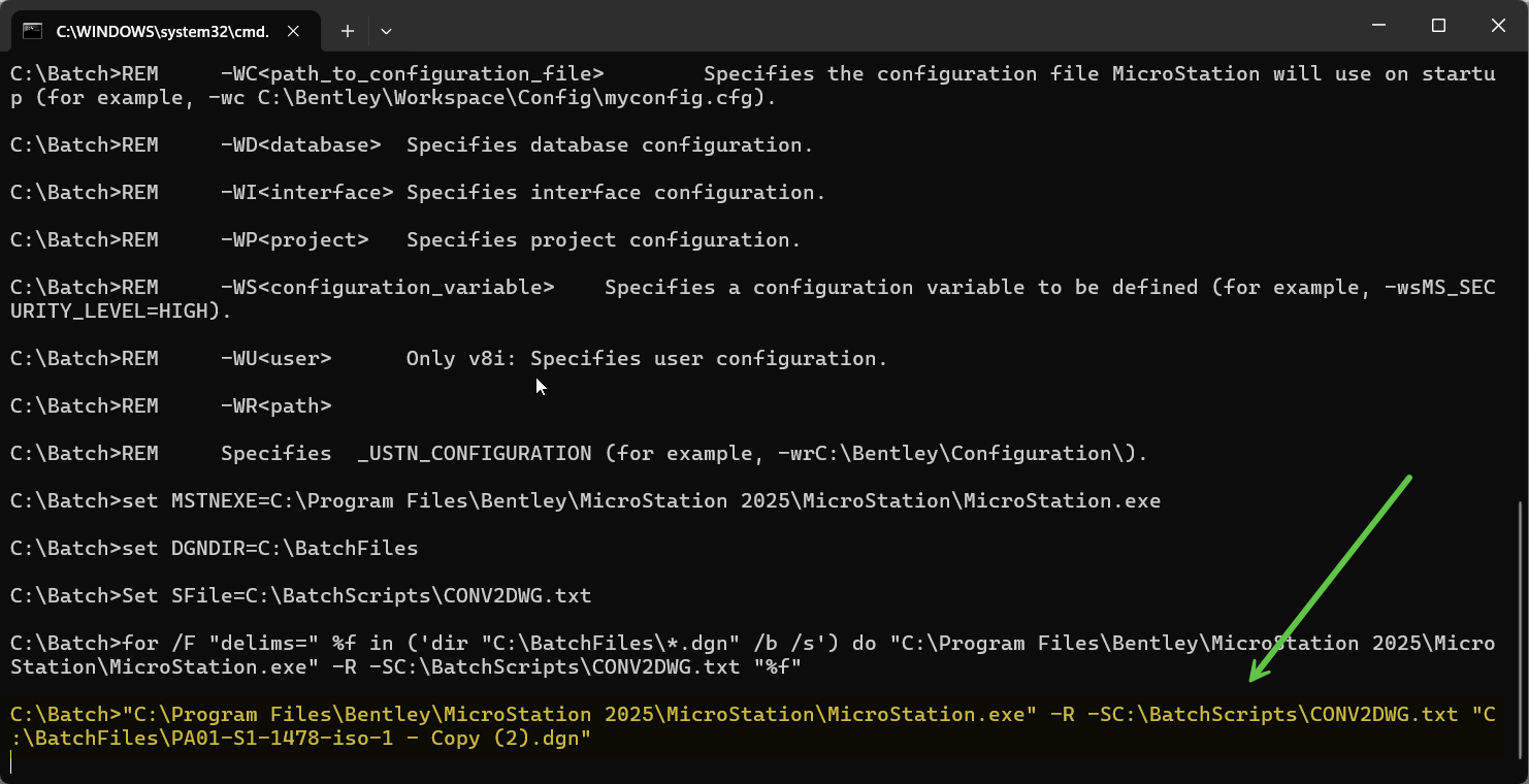

· Run Batch File 02 by double-clicking it to convert the flattened DGN files into DWG format using the VBA script.
