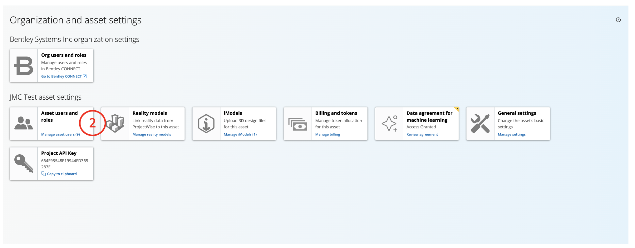

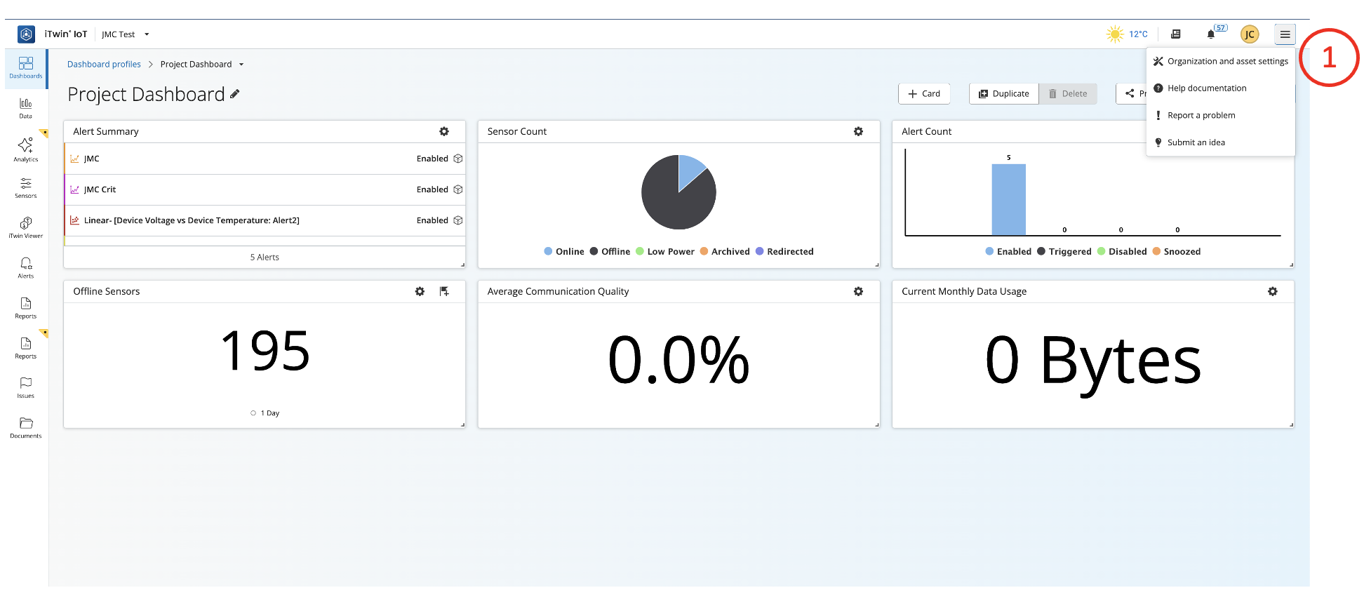

1. Organization and Asset Setting-  Begin by navigating to the project you would like to allow external users to access. Click on the Menu bar in the upper right corner of the page to expose a dropdown selection. Click on the "Organization and asset settings" button in the dropdown.

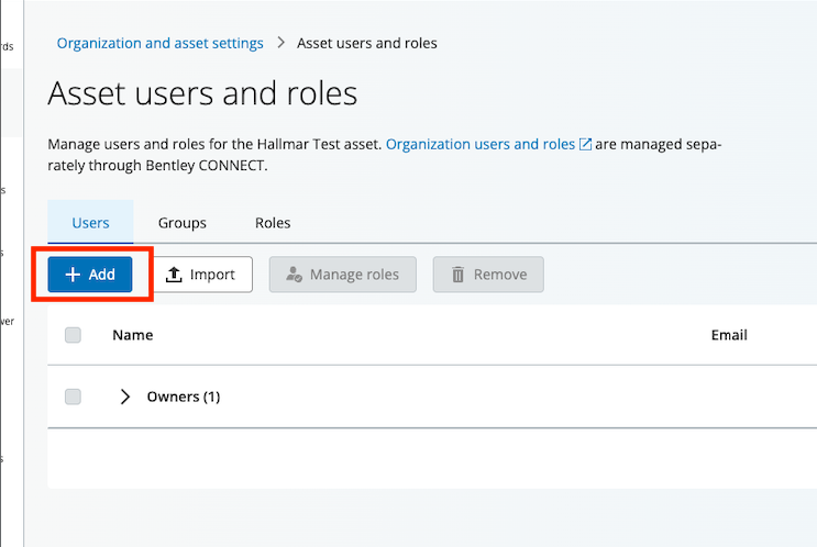

2. Navigating to Asset Users- On the Organization and asset settings configuration page, there is a card called "Asset users and roles". Click the  "Manage asset users" link on this card.

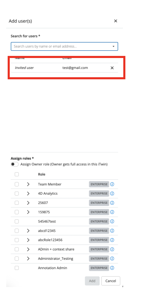

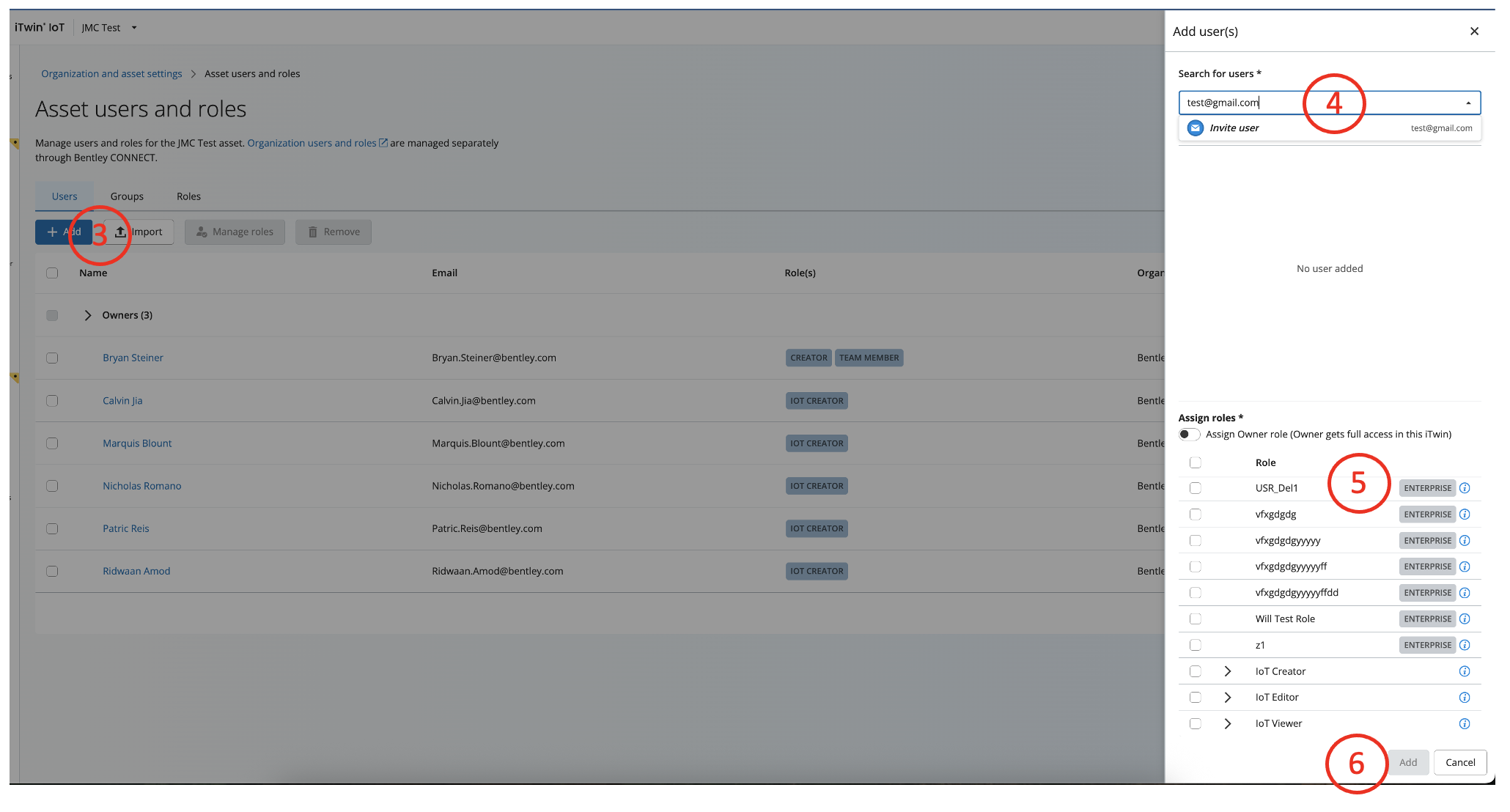

3. Add Users- Click the blue "Add Users" button on the left side of the page in the toolbar. This will grey out the page and open a user addition sidebar on the right side of the window.

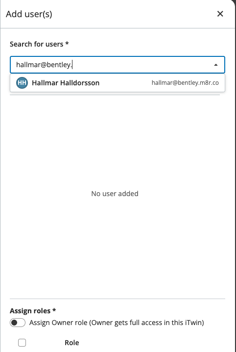

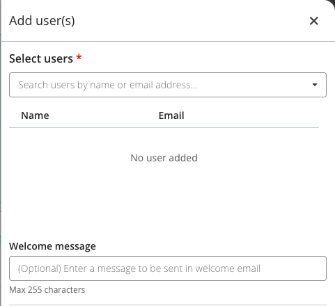

4. Search bar- The search bar at the top of the sidebar allows you to add users by name (if they are in your Organization) or by typing their email. The email option is recommended if the users are external. Once a name or email address is shown below the search bar, clicking on the name or email will add that user or set them up to be invited to the project if they are not part of your Organization. Users selected will show up below the search bar, as highlighted in the image below. Multiple users can be searched and configured at once if you would like to give them the same project role.
You can also include a welcome message that will be delivered to the user that you are inviting to your asset.

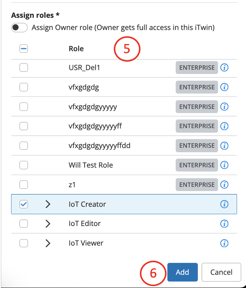

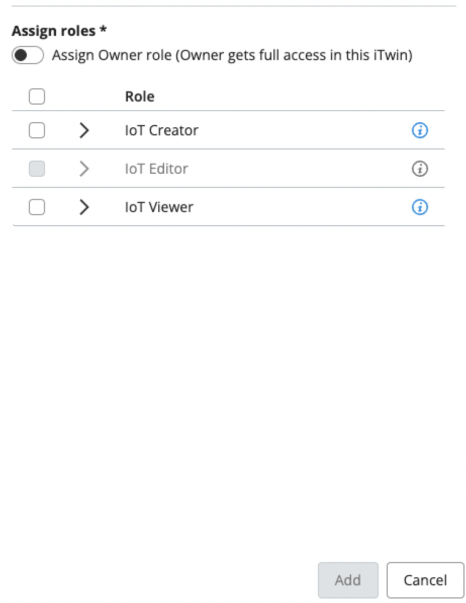

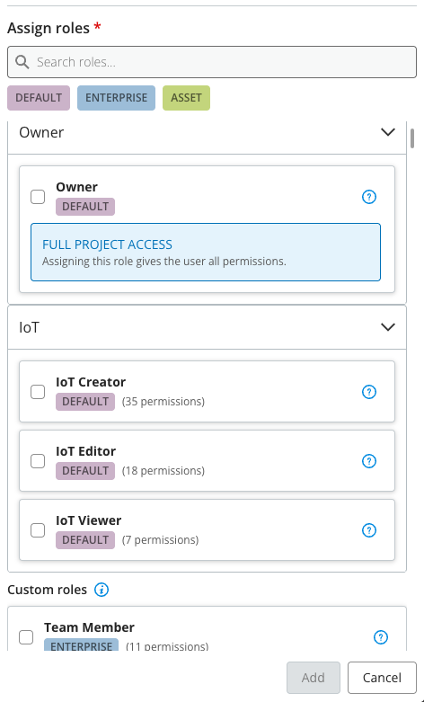

5. Assign Roles- Once you've selected the user or users to add to the Asset, you can select the role you would like to give them. For information about Asset roles, please see this chapter in this article.
You can only assign roles to a user if you are assigned to that role
6. Add- Once your users and user role have been configured, clicking the "Add" button will send the selected users an invite to the project.
Default: These are the roles that are created by default for every asset, they will always be available in every asset.
Enterprise: These are custom or default roles that are defined in your Organization. You can create a custom role through your Organization management menu and use it across all of your assets.
Asset: This is a custom role specific to this asset and only this asset.

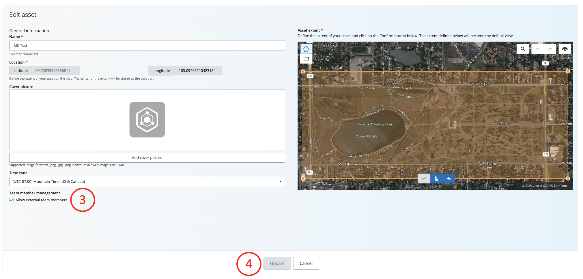

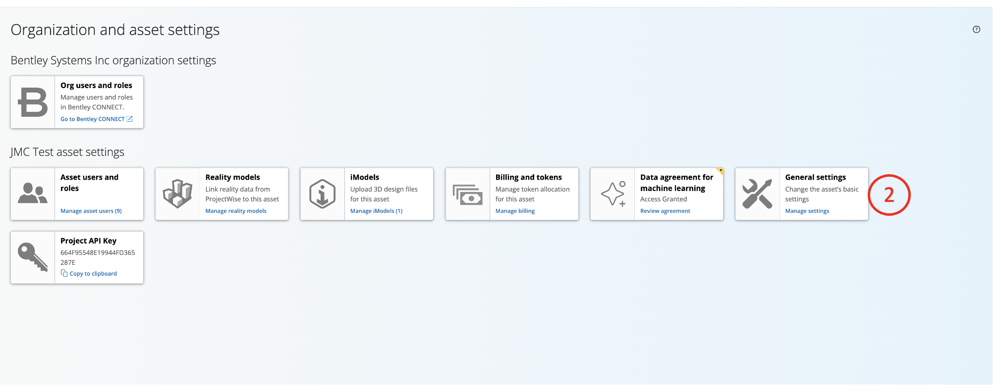

2. General settings- Click on the "Manage settings" portion of General settings tile.
3. External members toggle- Ensure that the checkbox next to "Allow external team members" is checked.
4. Update settings- If the checkbox had to be enabled in the previous step, the "Update" button will turn blue. Click "Update" to save the settings. If you did not need to make a change, you can click "Cancel" to exit the page.
