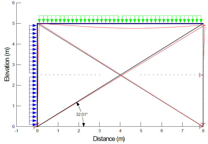

The purpose of this example is to verify the behavior of beams and bars in SIGMA/W when the structural elements are not connected to any other regular soil elements. All of the results are verified by comparison with hand calculations.
