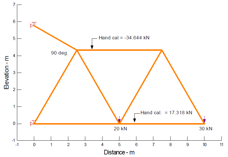

The purpose of this example is to verify the behavior of bar elements in SIGMA/W when the structural elements are not connected to any other regular soil elements. All of the results are verified by comparison with hand-calculations.
