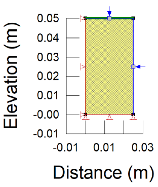

This example simulates a series of triaxial tests that can be used to verify that the Hyperbolic constitutive model is functioning properly. The simulations include:
  1. Consolidating the sample to an initial isotropic stress state;
  2. Drained strain-controlled tests;
  3. A load-unload-reload test;
  4. An extension test;
  5. An undrained strain-controlled test; and
  6. Consolidation at anisotropic stress conditions.
The verification includes comparisons with hand-calculated values and discussions relative to the Hyperbolic theoretical framework.
