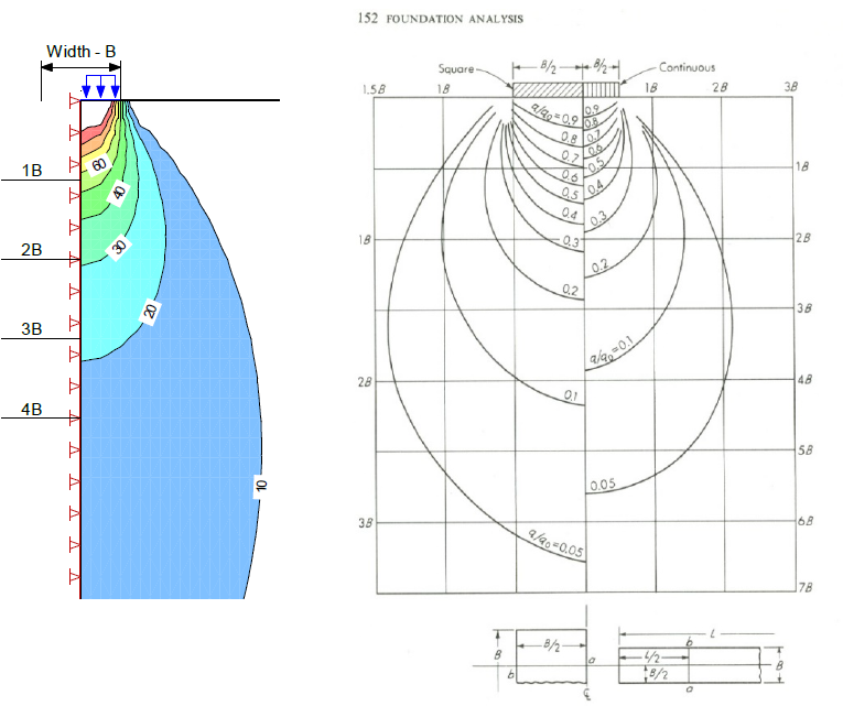

This example computes the pressure beneath a strip footing on an elastic half space. Closed-form solutions based on the Boussinesq equations are presented in most introductory soil mechanics textbooks for this case (i.e. Bowles, 1975). Since the solutions are so readily available, and since they are so well known, this is a useful example for testing the SIGMA/W formulation.
