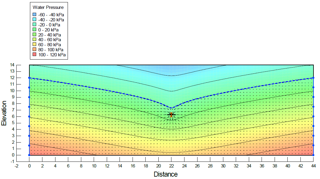

A powerful and flexible feature in SIGMA/W is the ability to compute the volume change arising from an independently computed change in pore-water pressure. The pore-water pressure change could, for example, come from a water transfer analysis.
This example illustrates how to compute settlement due to pumping using a load-deformation analysis. The results are then compared to a fully coupled SIGMA/W consolidation analysis.
