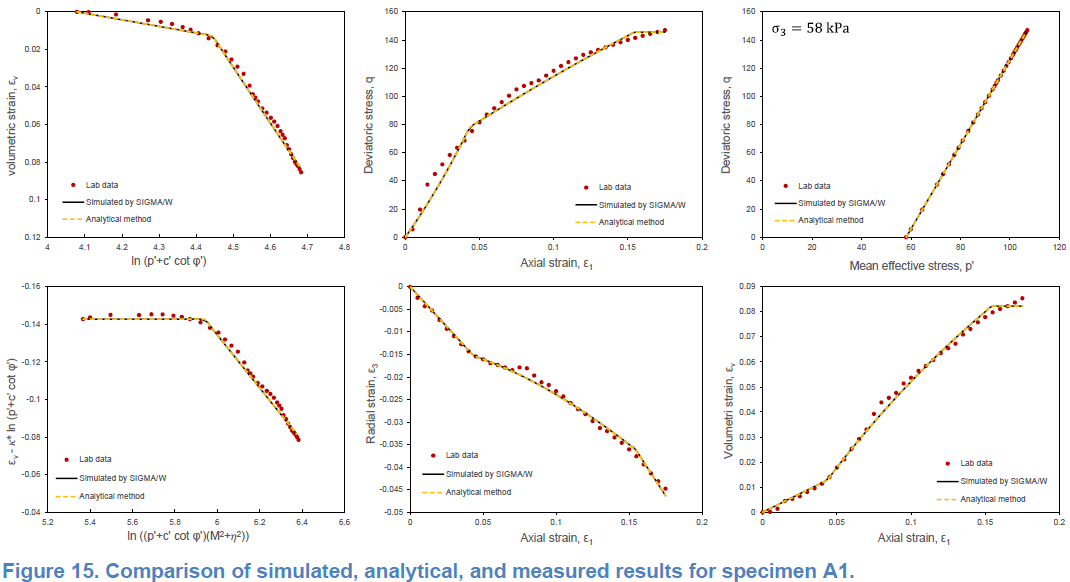

Parameterizing the Soft Soil Model
Application GeoStudio
Version Latest version
Primary Analysis SIGMA/W
Keywords GeoStudio, SIGMA/W, Soft Soil, model, laboratory, data, tests
Introduction
This example demonstrates how to parameterize the Soft Soil Cap constitutive model from laboratory data. The parameters are then used in numerical simulations of the laboratory tests and the simulated results are compared with the measured data and analytical solutions.
